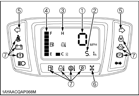

I recently bought a 2013 RTV1100C and since I started repairing some rust, When I start it and let it run, the light on the dash stays on. My manual is lost, does anyone have any idea what the light means?

It would be helpful to know which light you are referring to...there are a few on the dash LOL.

The manual online showed that I needed to check the brake fluid. I will do that. I appreciate the responses. except for the person who needed to be an ass. for that person, I am preparing a bed in the Ionia Hospital for the criminally insane,

The light is for low brake fluid,
Low brake fluid level
If the brake fluid goes below the prescribed level, the
warning lamp in the Easy Checker(TM) will come on.
If this should happen during operation, check to see
that there is no oil leak in the brake system, and then
add Dot3 brake fluid.
If fluid is low, it leaked out somewhere, so need to find the leak source. Get more fluid...preferrably one that is colored so you can see the leak easily.
