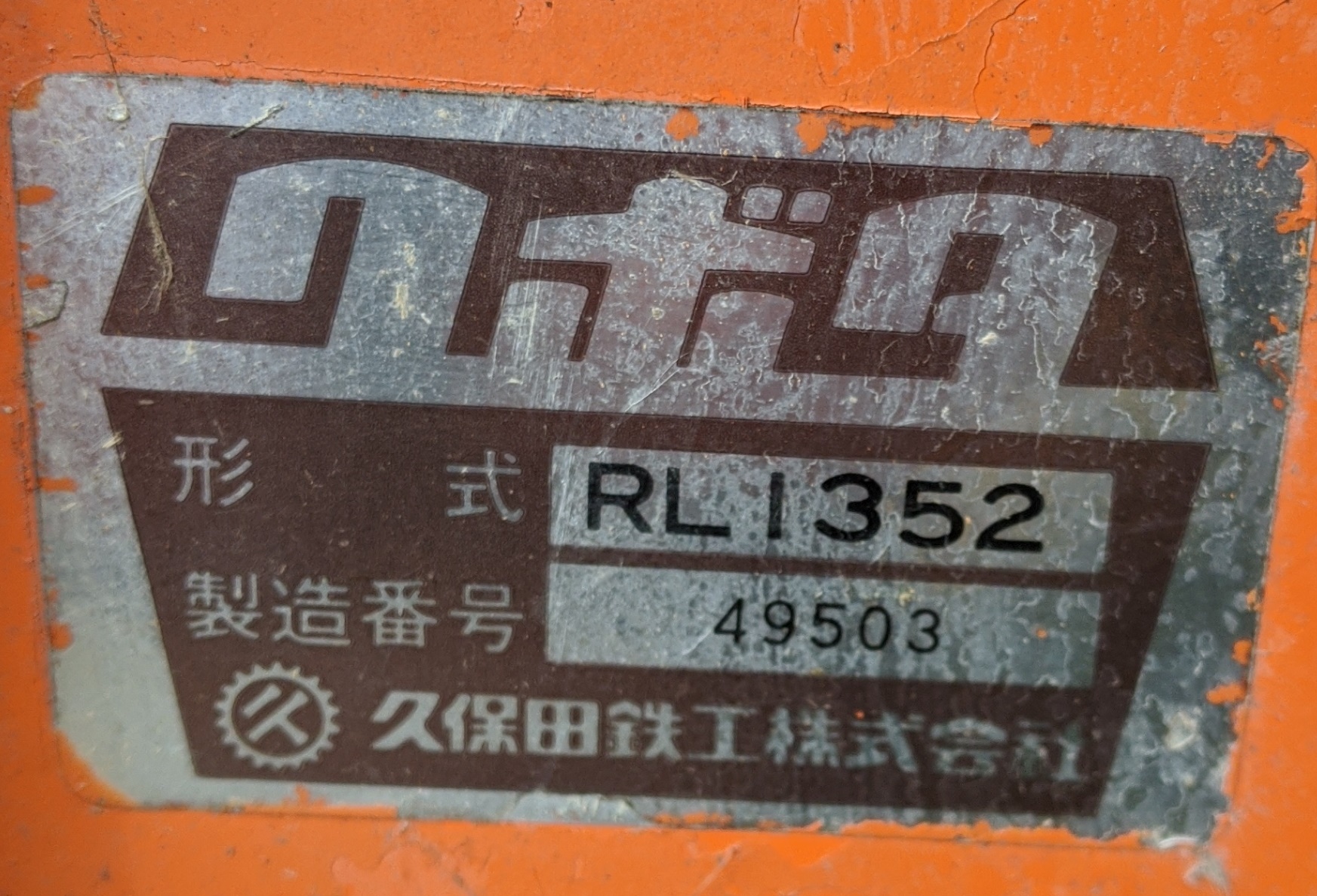

Hi. I've had this Japanese tiller for while now, works real good. The input seal had always weeped and now just want to get the correct seal first without tearing into it. I cant find anything online , so hopefully someone here knows something about something. ha. Thanks for the insight

I don't know your tiller but if you pull the driveshaft you may be able to remove the seal without tearing the whole thing down. Seals generally have numbers on them. That should help you source a new seal.
