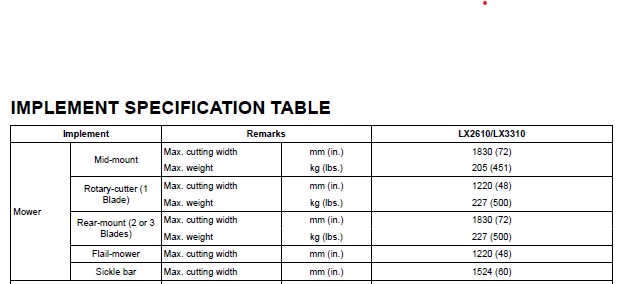

Your 2610 is rated for a 48" rotary cutter weighing 500 Lbs. or less.
Be careful.

Check the tractor Owner's Manual.
48" and 500 Lbs.
The information that you linked is the Land Pride catalogue.

The implement limitations are a little subjective - 48" for a one blade mower and 72" for a two or three blade mower - a rough-cut mower typically has two blades and the stump-jumper.
Referenced "2 or 3" blade mowers refer to 2 or 3 spindle finish mowers.
Referenced "1 Blade" rotary cutter refers to single spindle (yes, two swinging blades) rough cut mower.
48" and 500 Lbs.
SDT
Correct, which is owned by Kubota and is directly on the Kubota website.
Agreed.
Land Pride is in business to sell implements, regardless of ownership.
I'll trust the tractor Owner's Manual rather than advertising information created by anyone.
You should trust whatever you like.
