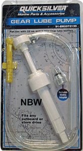

As for suction pumps, there are numerous choices from very cheap to very expensive and everything in between. I have a really nice one from EWK ....
... but you can find cheap gear lube type pumps designed to fit a 1 quart container that can be used in "reverse". Most automotive shops will have something suitable.

I have ordered a pump and will remove all of the old oil/water mixture and add fresh gear oil. I will also cover the gear box with something.

We took the top off of the gearbox-- 4 Bolts and a hammer tap and the interior of the box and gears were accessible. We got a cheapo pump (next day A, $6) and sucked out as much of the crappy oil/water mix as I could. There was still a thin layer left in the bottom. We used multiple paper towels to mop around and get the residue and it was pretty clean. The lower gear (that actually turns the blades) is sunken below the bottom of the gear box. There was still bad oil down there and I couldn’t tell how much. The pump tube wouldn’t fit in the space, so we added a couple ounces of new 80-90 gear oil . This diluted the crappy stuff and brought the oil level high enough to again pump it out. Then we started over with the paper towel thing and then add oil, then pump…. did it all again-4 times!
