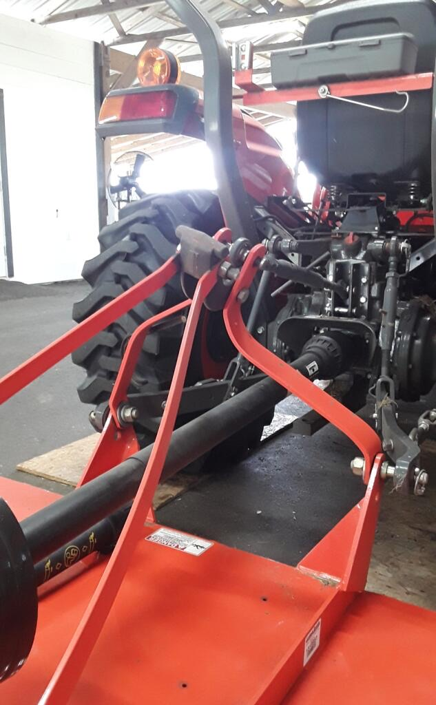

This photo shows what happens when you use the top link and the amount of movement allowed to the top link is exceeded. This is on a L3901. All 4 bars that run to the top link where bent. The operator of the tractor, my son's boss, has no clue how he did this to the mower.
This looks more like a twist/ side loading instead of a ditch crossing. I would have expected the two bars that run front to back at 45° to have splade open instead of bending the ones that attached to the 3 point hitch as shown.
