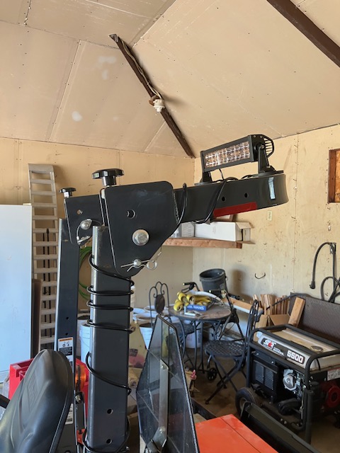

Think I found a solution without cutting the bar. With the ROPS folded this way and using the pins, it won't fold down. Put my light bar on and tested going into the garage. Made it by 2 inches. Will try this for winter and see how it goes.

Does Kubota or anyone else make a little shorter ROPES, top part? I need 3 inches shorter to get in the garage without folding it down. Thought about finding a machine shop to cut it down but not sure I want to go this route. Or is this a bad idea? Thanks
If you modify the ROPS, you are financially liable for any injury caused by a failure of the ROPS. If you trade the tractor in, the dealer will deduct the cost of replacing the ROPS with a new one as it is no longer certified and they can not sell the tractor. If they sold it with a modified ROPS, they also would be liable for any injury caused by a failure.
Suppose a family member or friend gets on the tractor, rolls it, and is injured or killed.
It's your tractor, do what you want, but remember actions often have unexpected consequences.

No modifications done. Just folded out and used the pins to keep it from dropping down.
