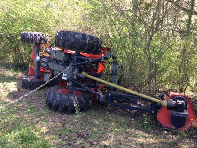

You had better make sure your tractor has the weight to handle the articulating flail mower attached to the 3PH. After my intense calculating and dealer input, my M6060 with FEL and loaded rear tires, I still flipped my tractor on it's side while mower was all the way to the side and at vertical 90* angle. Absolutely God was watching over me, as not a scratch on tractor or me. I was trimming privy hedges and I stepped off the tractor as it landed in the ONLY open spot that was about 24" long. A few feet more was a downhill 100' decline to creek. I believe the right front tire had low air pressure as the R4 tire bead unseated from the rim as it flipped. Took two JD's, one 4x4 to upright my Kubota.
I wish the Land Shark had been around when I was looking. BE CAREFUL!

Wow that’s a pretty scary photo, good to hear the safe ending. Sometimes no matter how careful we are we are reminded of the risks of tractor operation, things can go wrong real quick! I’ve looked at a number of these offset type cutters for my MX5800, but the more I look the more I think that a compact tractor is not a good solution. I’m saving my money to invest in a vertical brush hog type cutter for my Kubota track loader one day, until then, chain saw, pole saw and cutters.
