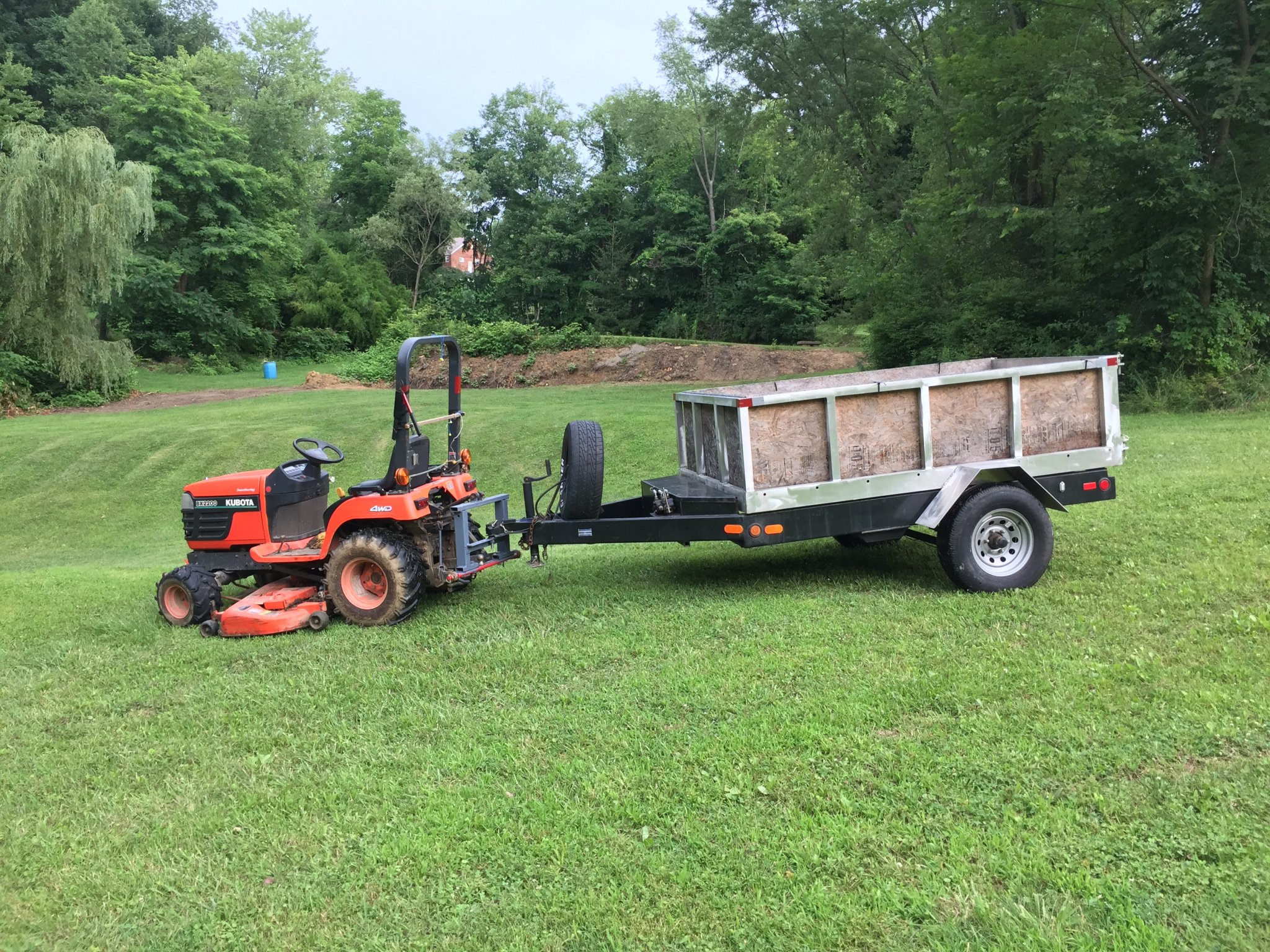

Wow! That looks a lot like my dump trailer that is titled for 3500 pounds.
I need to post a picture for comparison. Mine has an aluminum dump bed and electric brakes on the axle. I should see what the axle is rated for...but think that is the limiting factor as for weight rating. My frame is box tubing rather than channel, same as yours seems to be.
Also pulled behind a BX a lot. With hills I think 5x8 is the limit for me behind the BX.

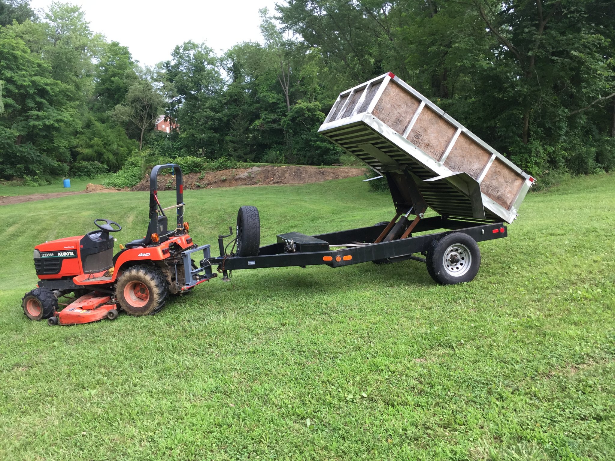

Here are a couple pictures of my road licensed 5x8 behind the BX:
2284FD2E-C09B-4D2E-942E-91EAEC537B6B.jpeg 6A85EF8A-5F32-447D-8EBB-25882A876034.jpeg

lostboy, thanks for joining! It looks like your trailer weighs about 1825lb empty. How much weight have you hauled with your B2320? Have you tried going up/down slopes? Do you engage the trailer brakes somehow while using your tractor to pull it?
My wife loaded and stacked it level with oak firewood which was pretty heavy, maybe 3000lbs. The tractor pulled it ok in first gear a couple of hundred feet. Like others said, I probably exceeded manufacturer’s limits. I go slow rev the rpms. I would want to go down a steep grade with a full trailer behind me. I don’t hookup the brakes or lights to the tractor. Most of the time have been loading the trailer with limbs and Logs that only weigh a 1000lbs or so.
For me the trailer doubles as a pickup bed that I can pull on the road or use behind the tractor.
