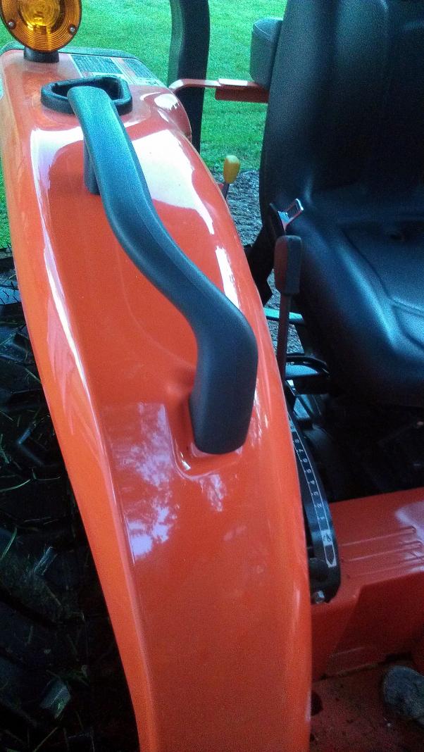

Ordered from Messick's 1 pm on Monday, Fedex delivered Wednesday morning to central Illinois. Total cost 62.05. Part T1060-29470 was $44.62, 2 Flange nuts part # 02771-70100 were $1.73 each. Delivery $ 13.97 (regular shipping).
Installed it in about 5 minutes (took my time). Put a fender washer on each bolt just because
Dropped right into pre-drilled holes, no bending, no more orange tape.
Put it onto the L2501.
