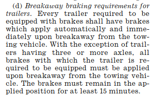

What surprised me about this refit, is that the law requiring a breakaway system was put in place in 2005, yet this trailer was built in 2017 and did not have one. Also, the id lights at the rear (3 lights in the center of the trailer) that are required when the trailer is over 80" in width, were not installed.
I don't really think DOT will care too much about those things on a non-commercial trailer, but still - I think they should have been installed so I'm making sure the trailer is properly equipped.

Brakes on both axels? If not that's why no breakaway was required.

FMVSS section 393-43 disagrees with you on that point.
I don't see any mention of brakes on both axles as an exception.

Here in Ontario, mfrs 'skirt' the trailer laws by selling trailers rated for 2990#, the 'magical' number. Legally no need for brakes on the trailer, even though trailer has 3500# axle(s). However if the trailer HAS 2991# of 'stuff' on it and pulled over the driver can get a ticket as there are NO brakes on the trailer !
