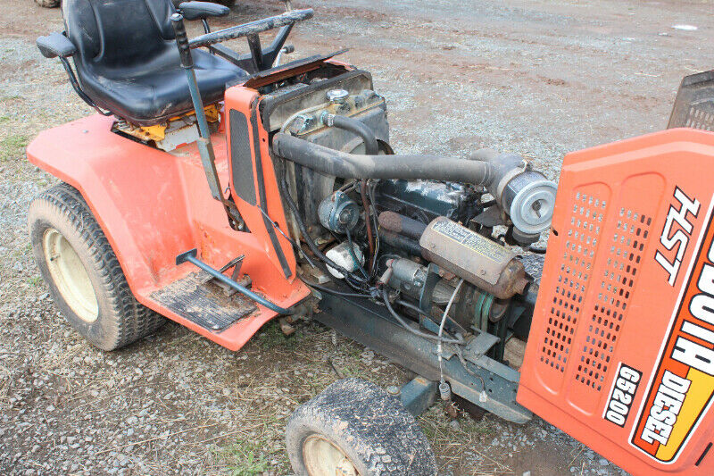

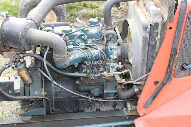

I bought a G5200 with mower deck and stock D600 3 cyl, engine in July. It had ~3,300 hrs on the meter and needed TLC. Started right up cold and idled nicely.
I've done a bit of refresh so far (details in posts below) and have also been chasing the good ol' overheating issue.
I'll post progress on this thread to help others.

Some pics from the ad:

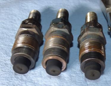

I also removed the injectors, disassembled and ultrasonically cleaned.

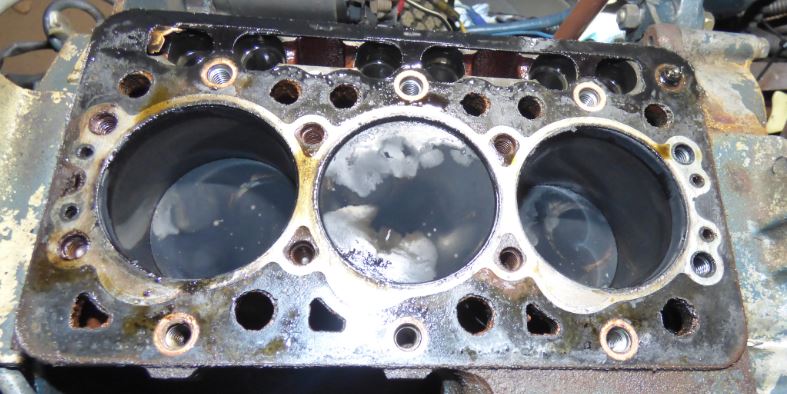

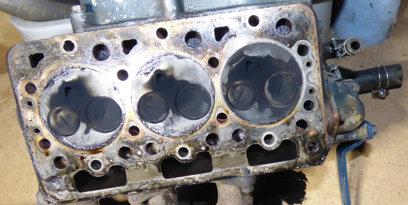

With all of the obvious checking out ok, I pulled the head. It looked great.
Nothing obvious observed on the head, deck, or on head gasket except 3 small cracks between each injector chamber and the intake valve.
HG Top
Block Top
Head Bottom
HG Bottom

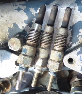

Injectors and glow plugs look good with similar colour
Took the head to the engine shop. They said the cracks do not look bad and would not cause over heating. They pressure tested and all is good as well as straight.
This is where we are now (Aug 28). I will get them to do a valve job since the head is with them.
Ordered new head gasket, intake gasket, exhaust gasket, bolts, etc.
I am now looking at perhaps a larger rad or a fan swap with more blades; but will first see how the new HG does.

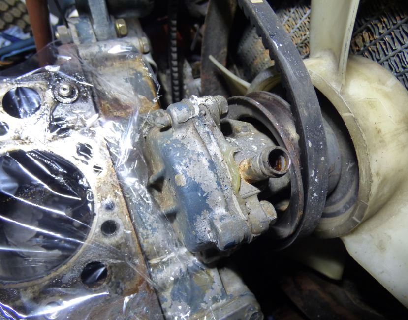

But before the cooling mods, I've ordered a new pump as the PO's were obviously "at it":

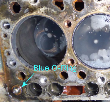

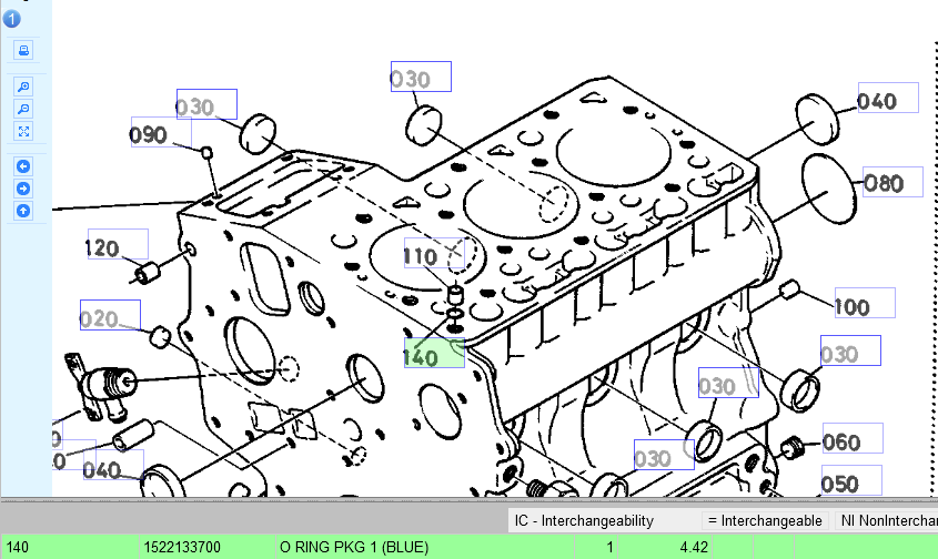

There may be an oring on a pipe (dowel) that you will need to replace or at least be sure it is in place. (I am not 100% sure your engine has it but have read too many times about people not putting it on and having problems)
Blue280z
BX25D
Jul 1, 2020
64
24
Thanks! I believe it is this one: (part #140)?

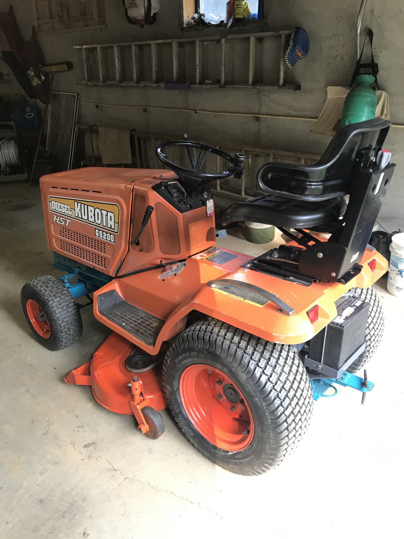

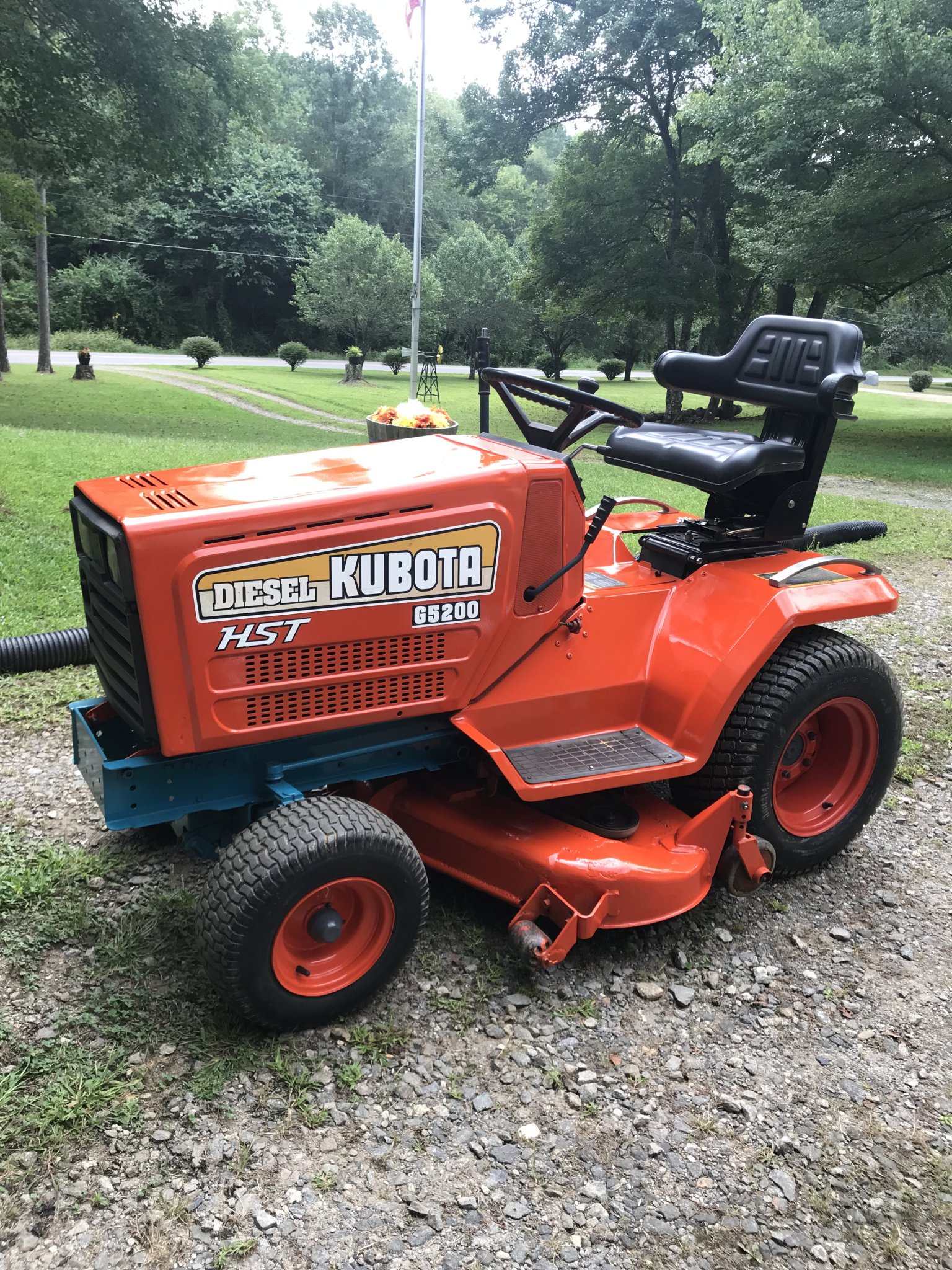

I have an old G5200 that I bought new in 1993, it's kinda rough, but I still like it.
Blue280z
BX25D
Jul 1, 2020
64
24
Wow. It looks mint. Did you ever have overheating under load? I see the battery has been relocated. Was this for ballast or cooling or just battery up-sizing?
Long ago it would run kinda warm when using the bagger, I had a local radiator shop put a high efficiency radiator core in it, end of problem. I moved the batter because I got tired of that odd sized original size battery failing, group 24 battery out front, end of battery problem. It looks good because I am pretty fussy with my equipment.
