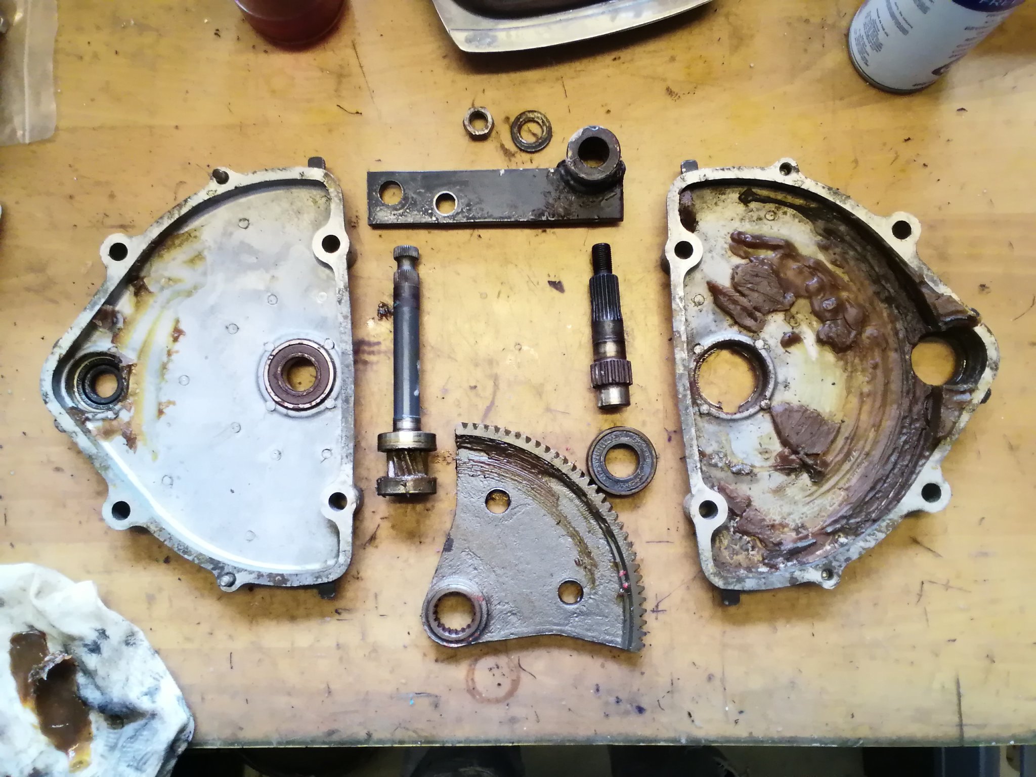

After fixing all the steering linkages and getting them play free the remaining play is in the steering box itself. I bought a second hand one to be able to work on it while using the tractor.
Disassembly
Remove the nut on the Pitman arm and pull off the arm. It is a tapered splined joint that most likely requires persuasion through heat, force, hammering and possibly swearing too.
Then pry apart the two halves of the housing. Pull out the main shaft and the steering shaft.
Pull off the old bearings, the seal ring and the gear sector.

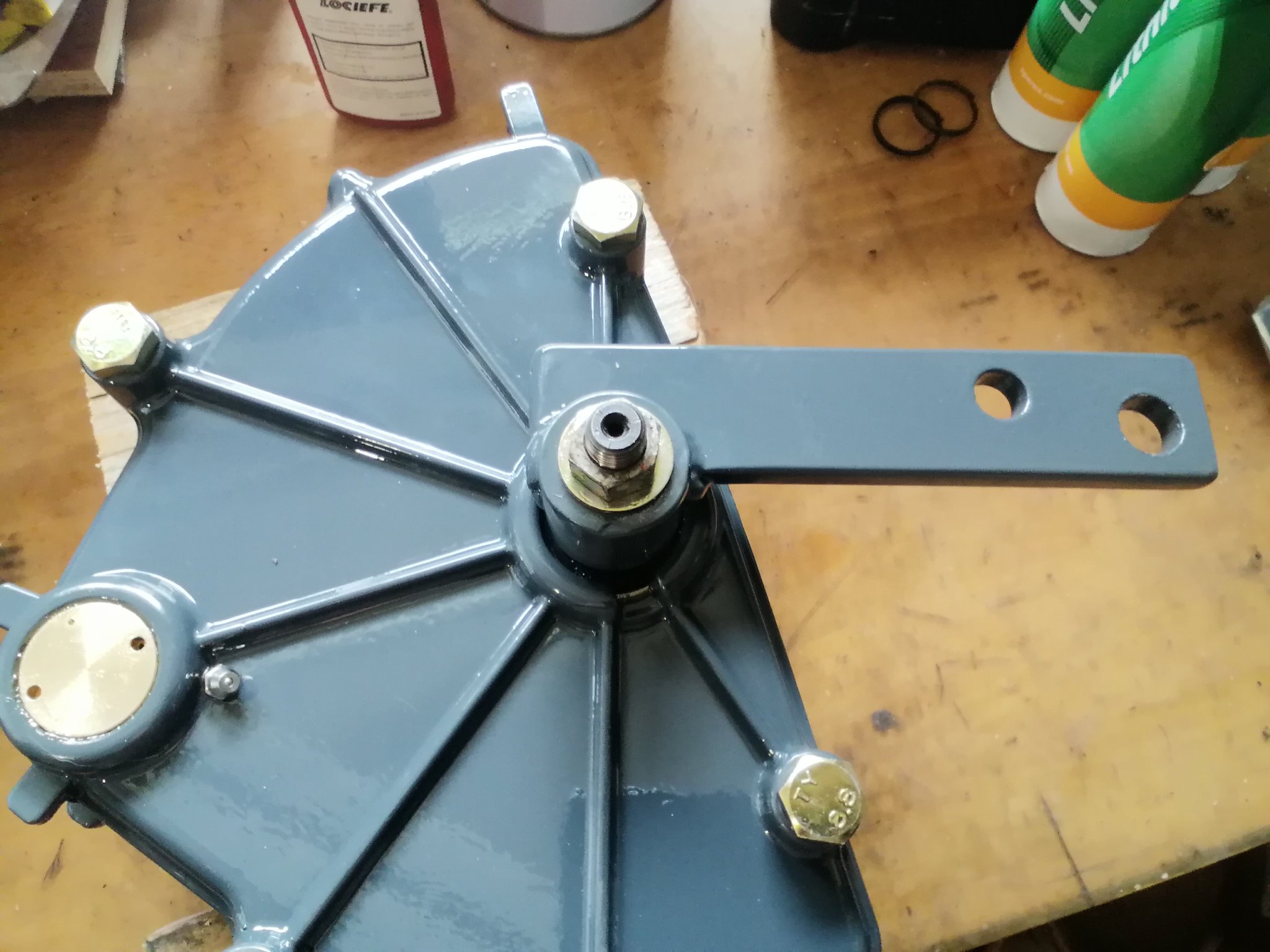

Assembly
Clean everything. Press in the new seal ring (17x30x7). Press in new bearings on the steering input shaft (17x35x10 6003 2RS). Slide gear sector over the output shaft and make sure the dot marks align. Press in the two bearings (20x42x12 6004 2RS).
Put in the output shaft and input shaft into the housing. Fill upper sector where the pinion gear is with grease. Insert the two alignment pins into the housing and push top part together with bottom part. The two parts are held together by the mounting bolts.
Push on Pitman arm so that the groove marks meet, insert washer and tighten nut.

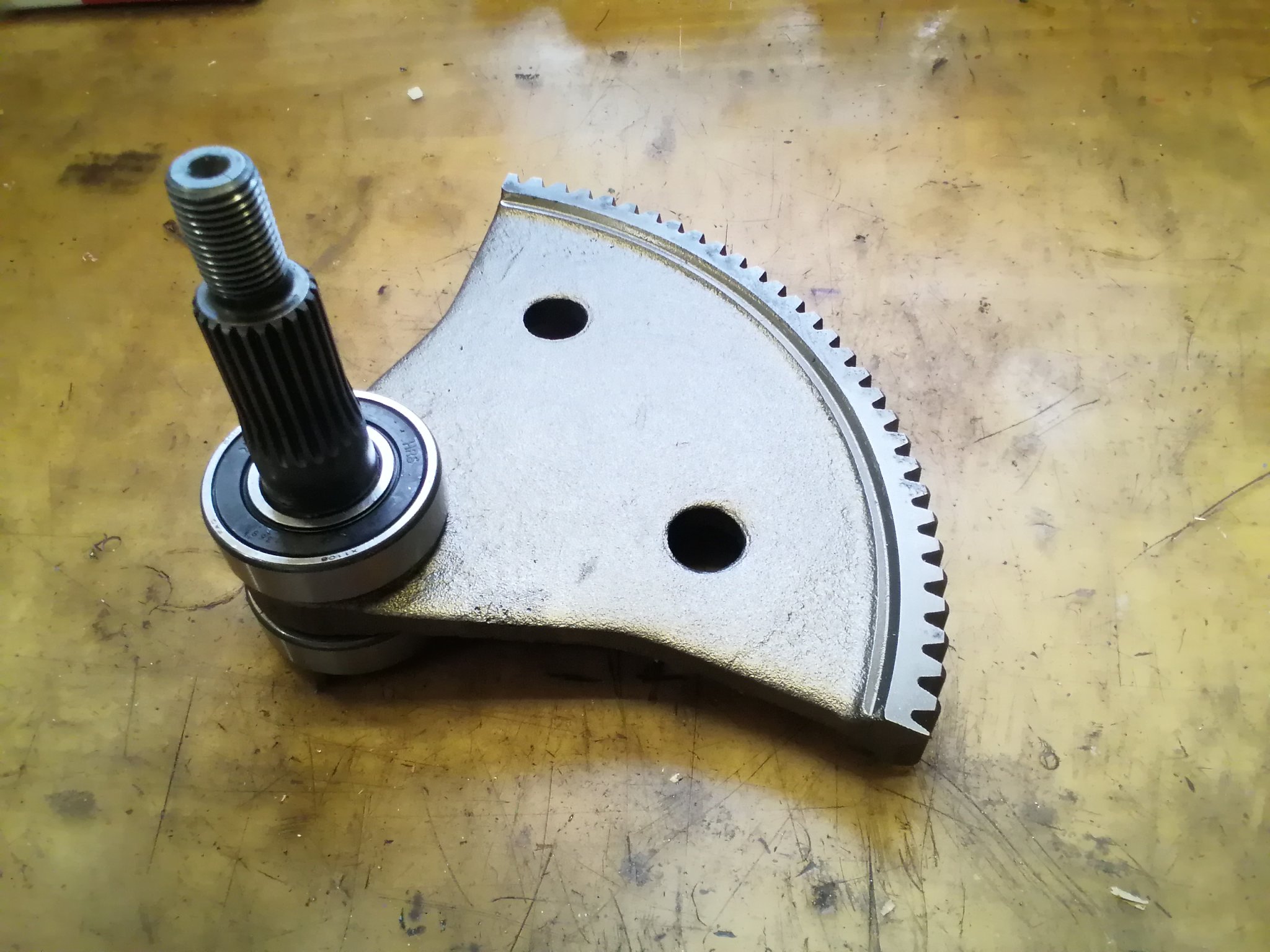

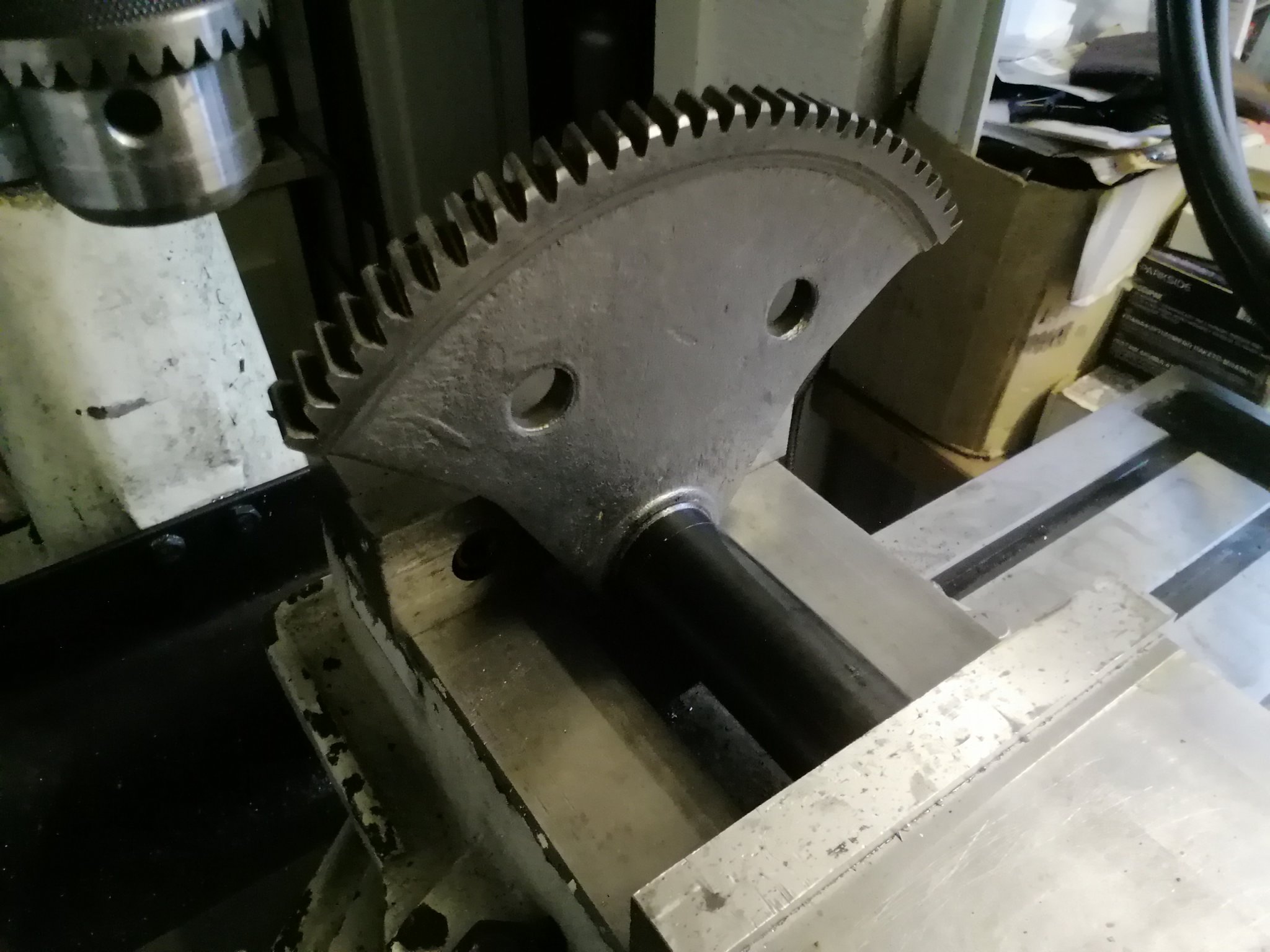

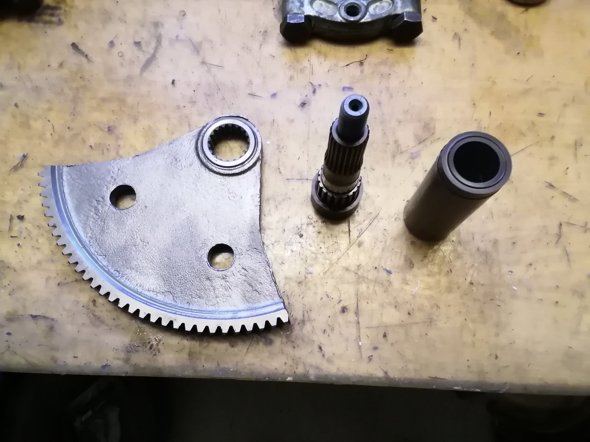

The play in the steering box is due to two parts: the first is the play in the splines of the gear sector and the other is the gear play.
The first I removed by glueing the sector onto the shaft. Due to the play I machined two Delrin parts that have a tapered nose that centers the sector on the shaft while the glue sets. I used Loctice high strength. The glueing of the shaft is no problem since the bearings can still be changed.

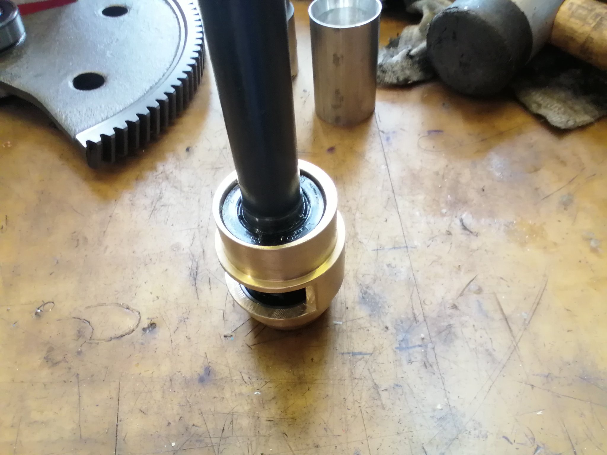

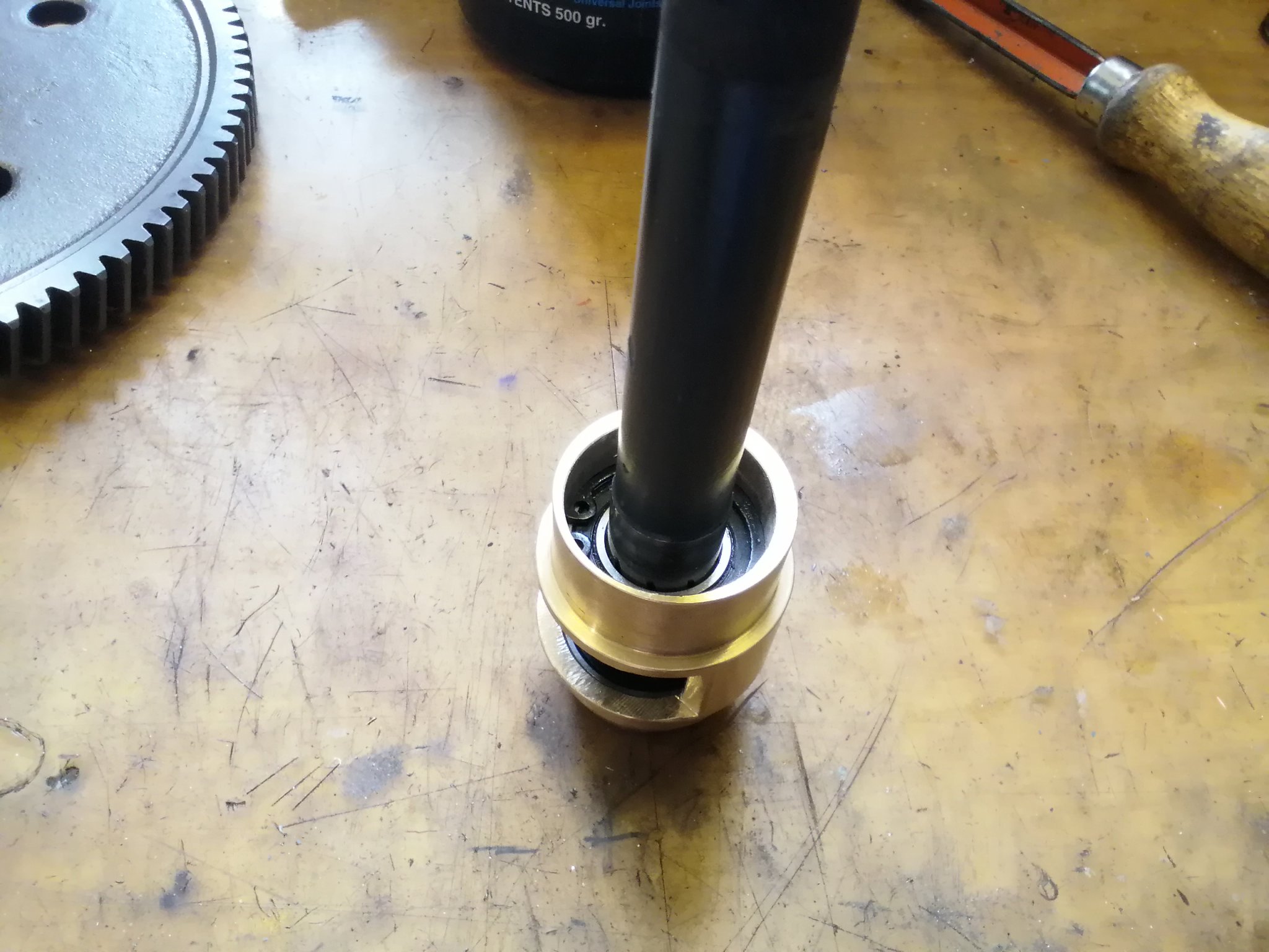

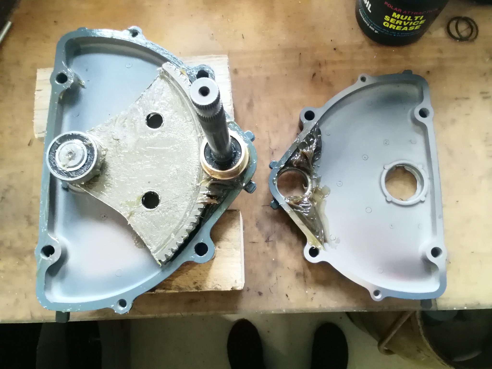

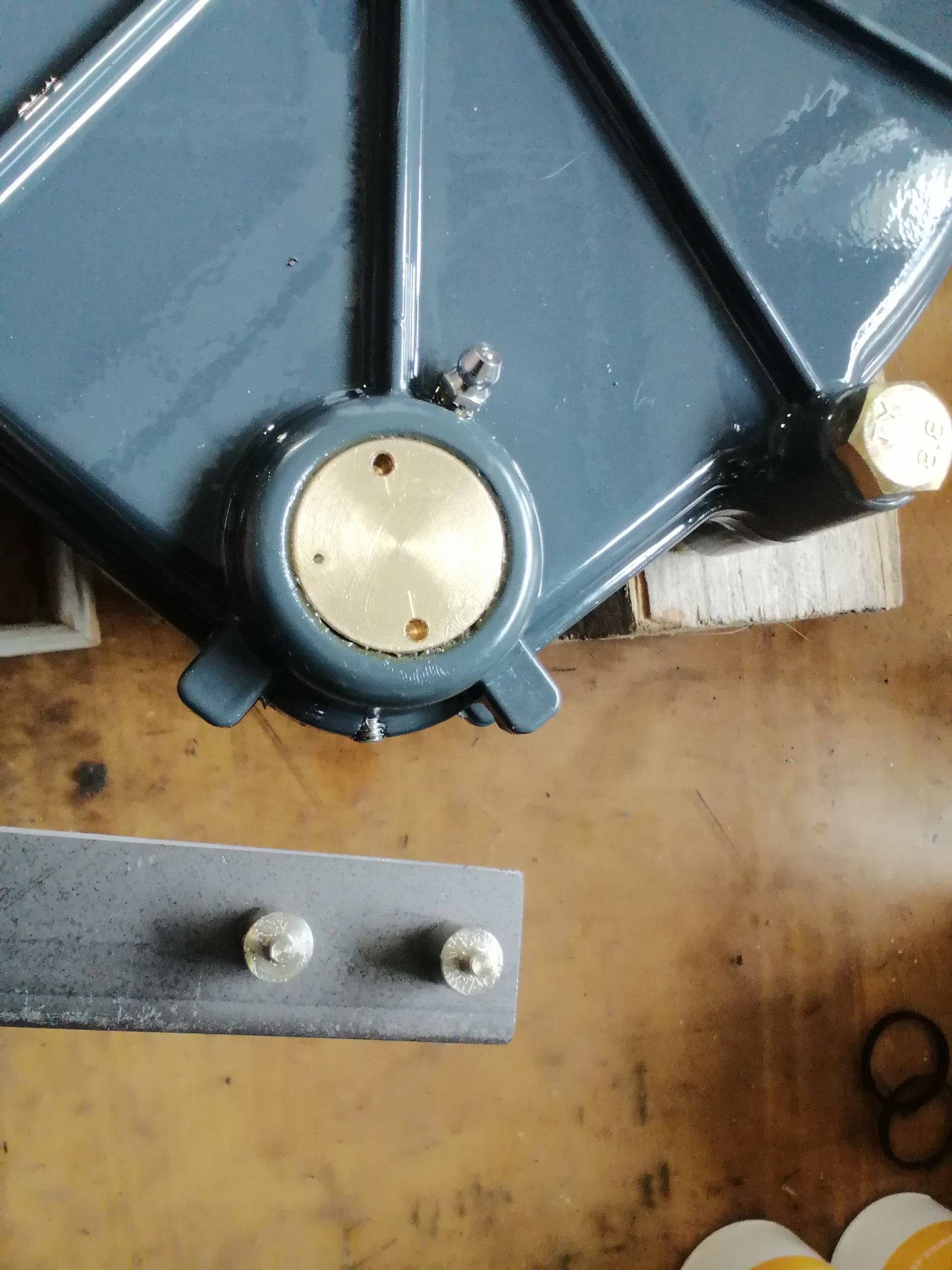

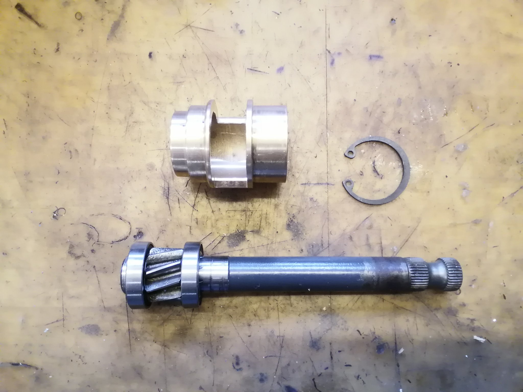

To get rid of the play of the gears I machined a bronze bushing which holds smaller bearings (17x30x7). Those smaller bearings are fitted off-centre allowing the play to be removed by turning the bushing.
The bearings are 1mm off the centre which is way too much I noticed. 0.5mm should be more than sufficient.
The bushing is turned with a tool having two pins that fit in the holes in the bushing at the bottom. It is then fixed by two grub screws.
I added a grease nipple that allows to refresh the grease near the pinion. I will also make a cap to fit over the top of the output shaft. Water must have got in here; the bearings were rusted.
Assembly is otherwise the same as the original steering box.

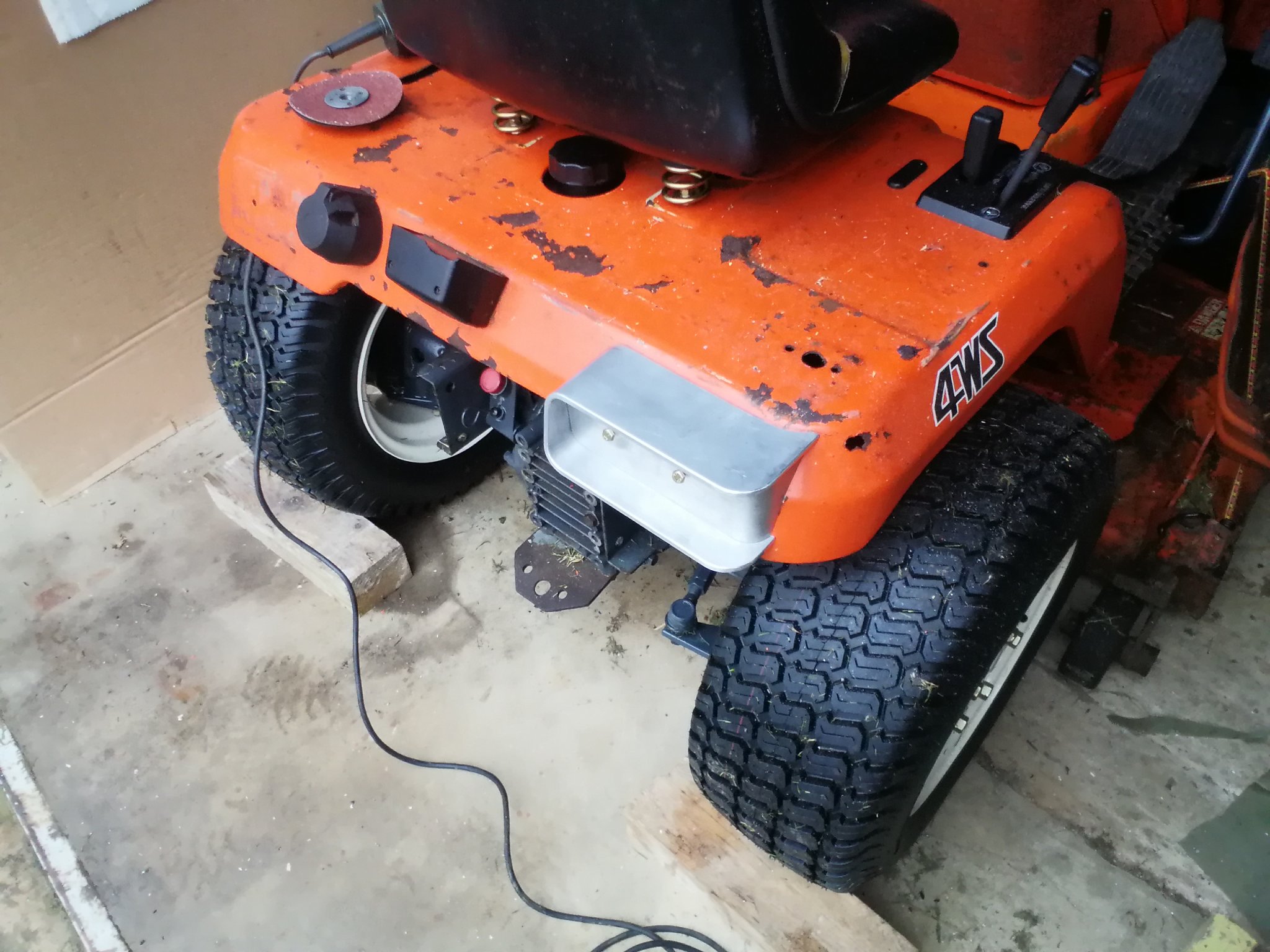

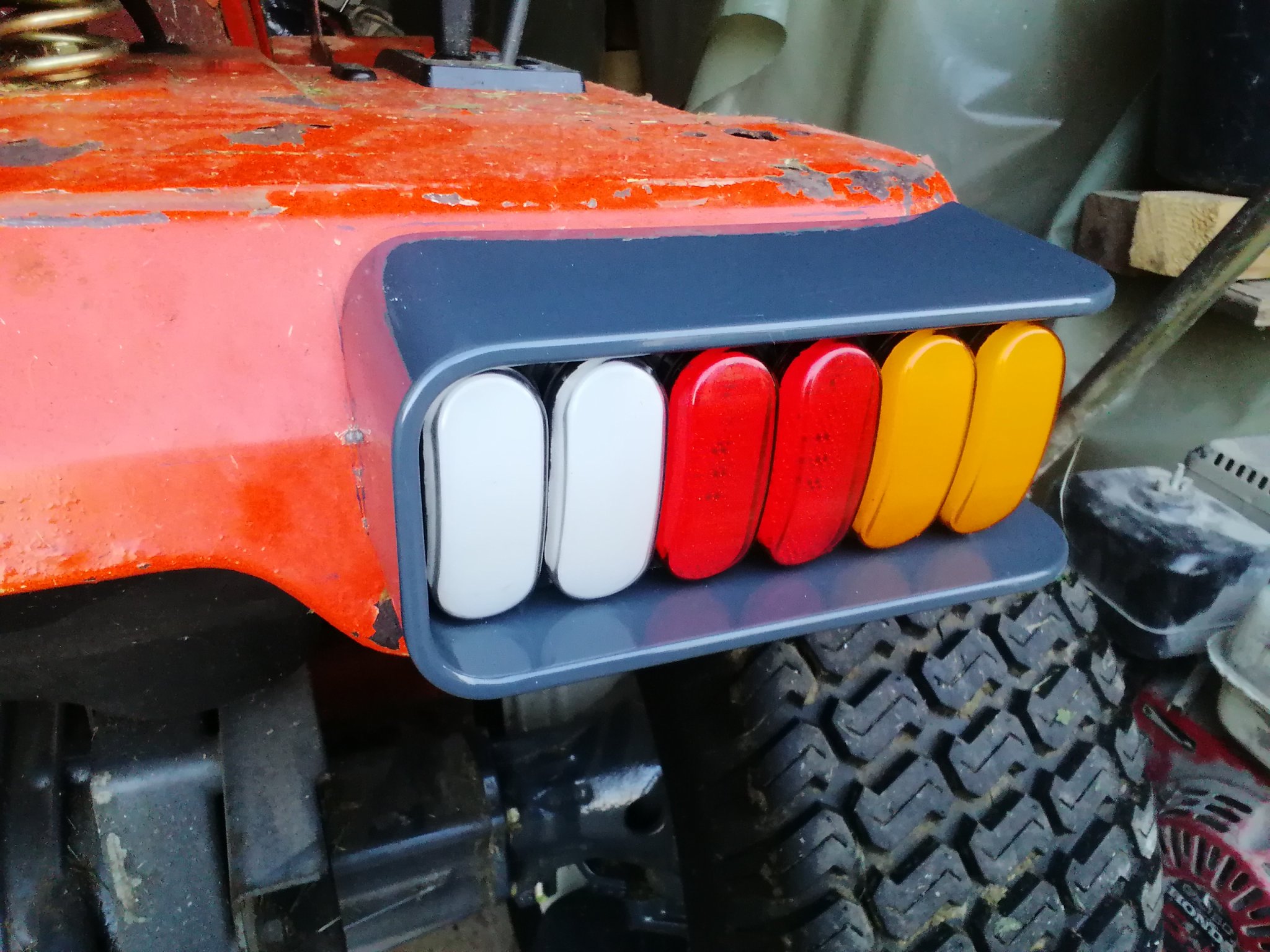

Rear lights

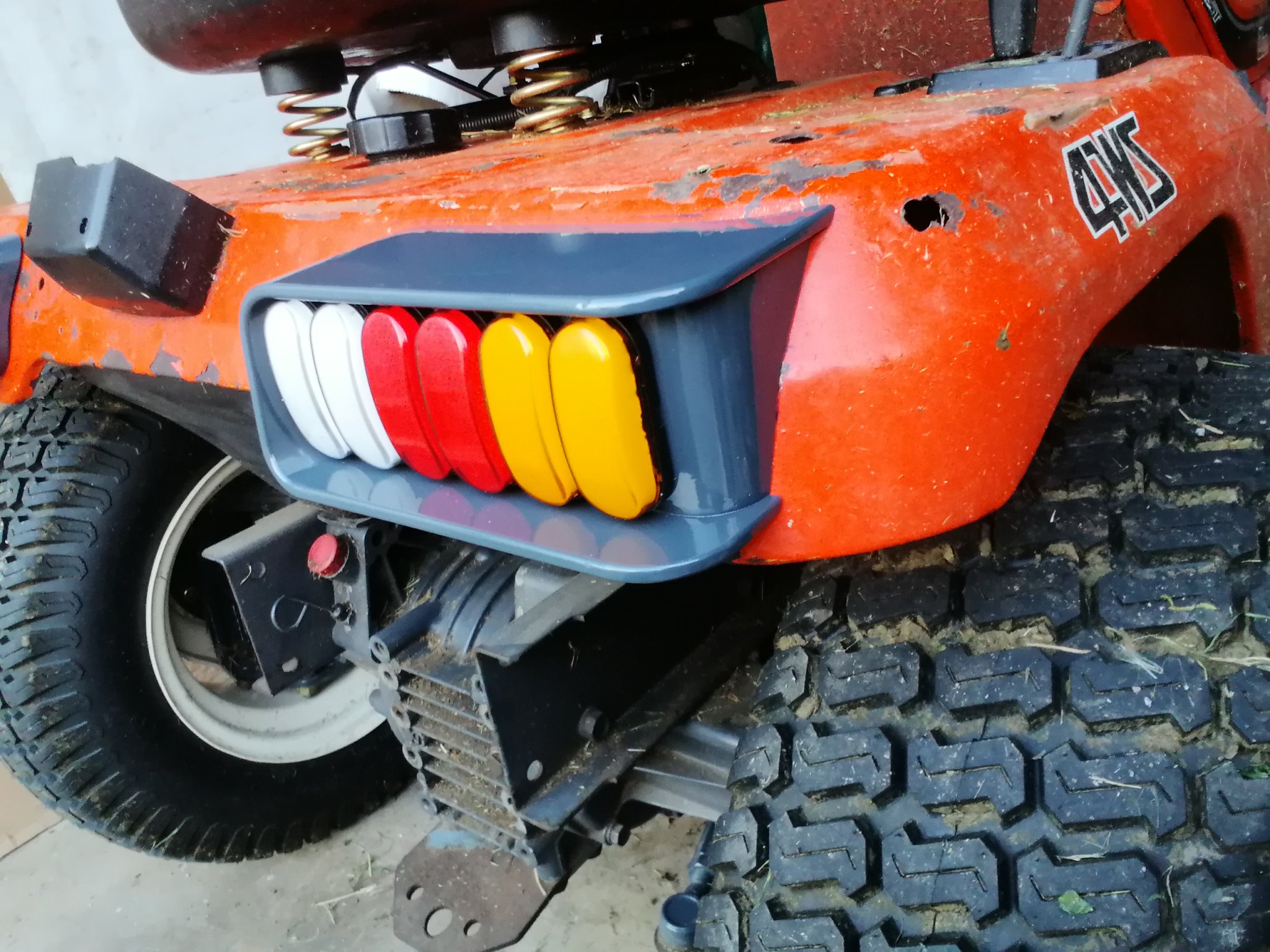

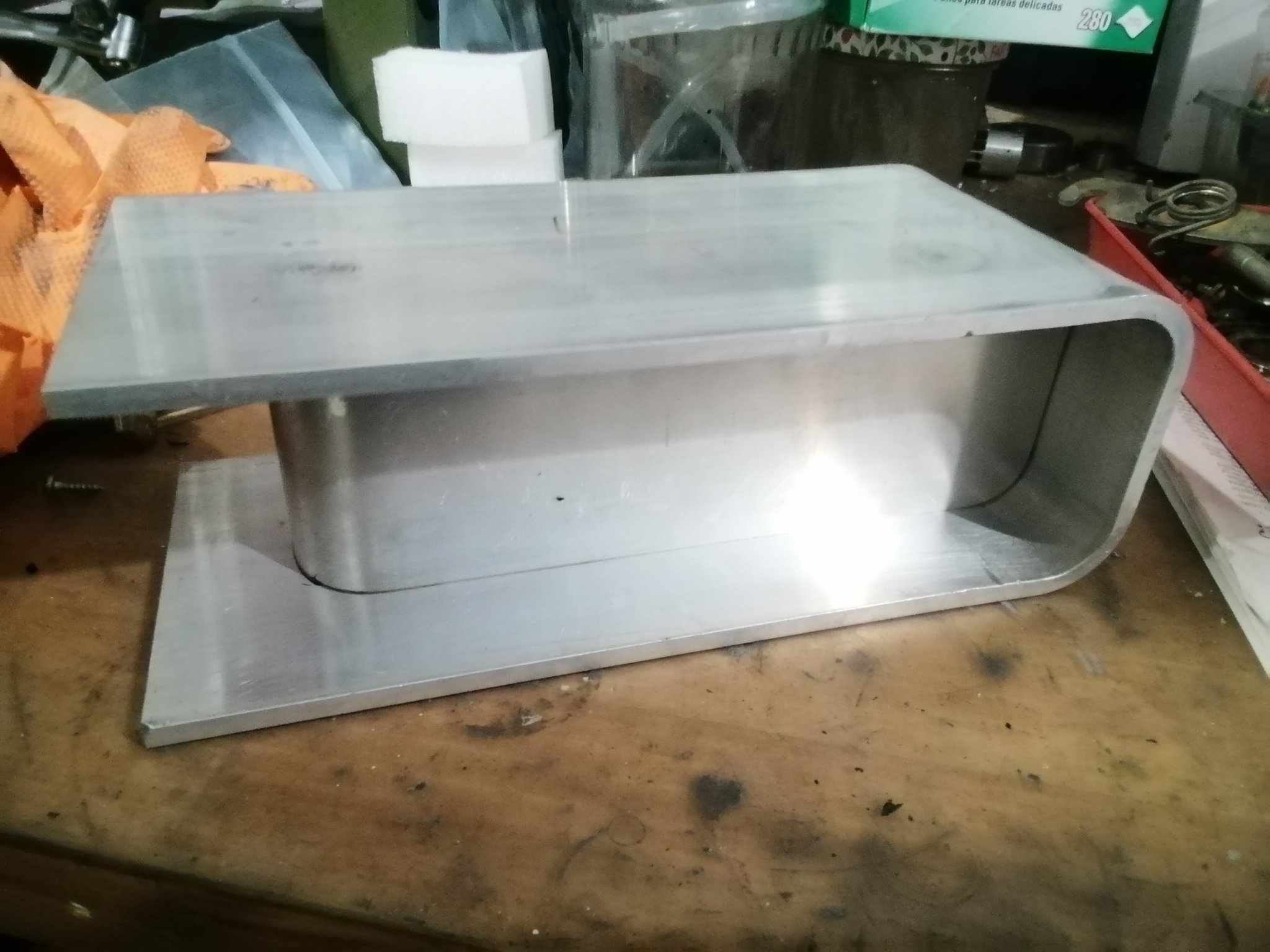

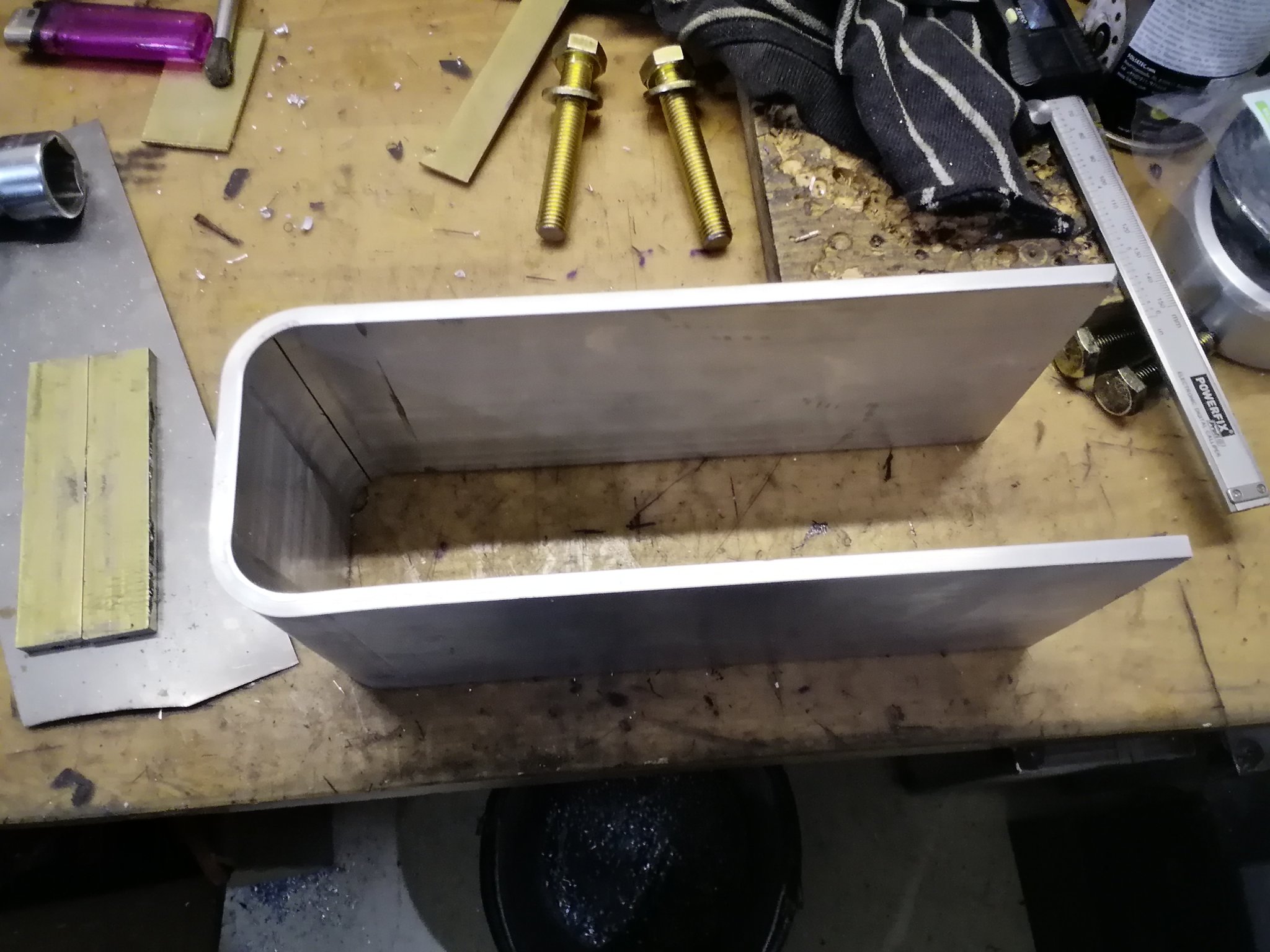

One of the rear reflectors was damaged, so I had to do something. The G1900 has front lights, so why not rear lights?

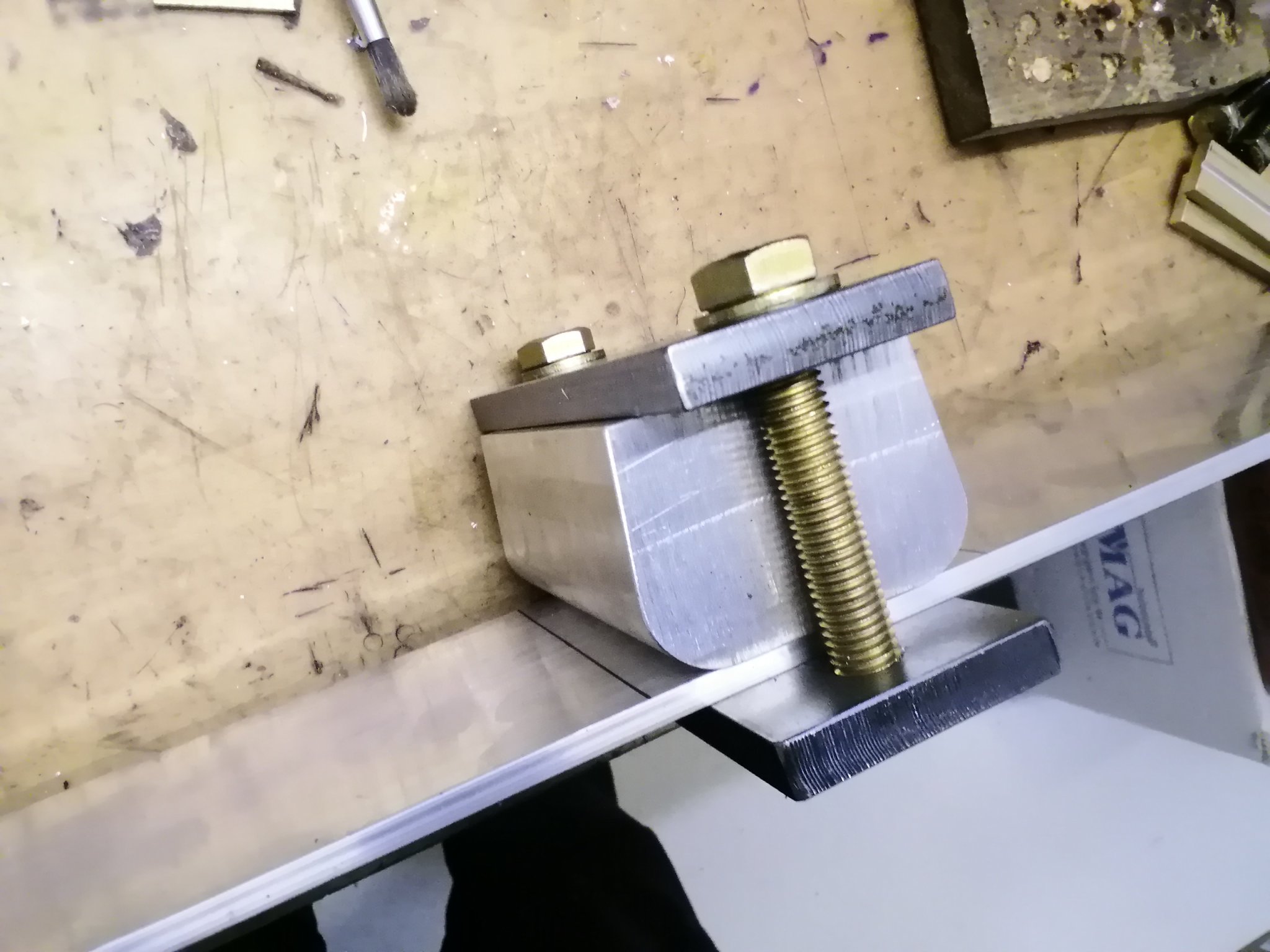

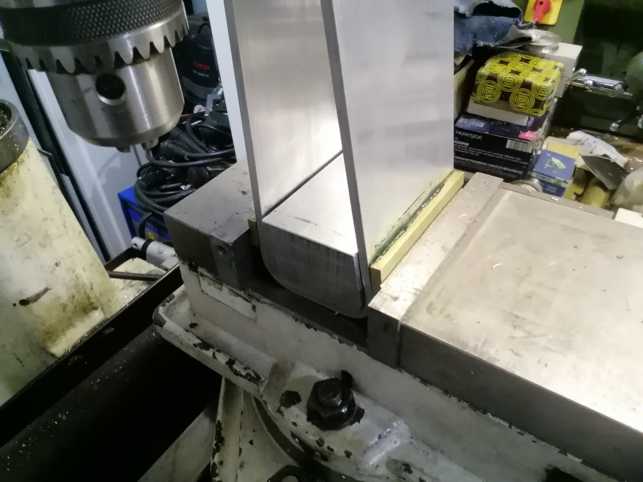

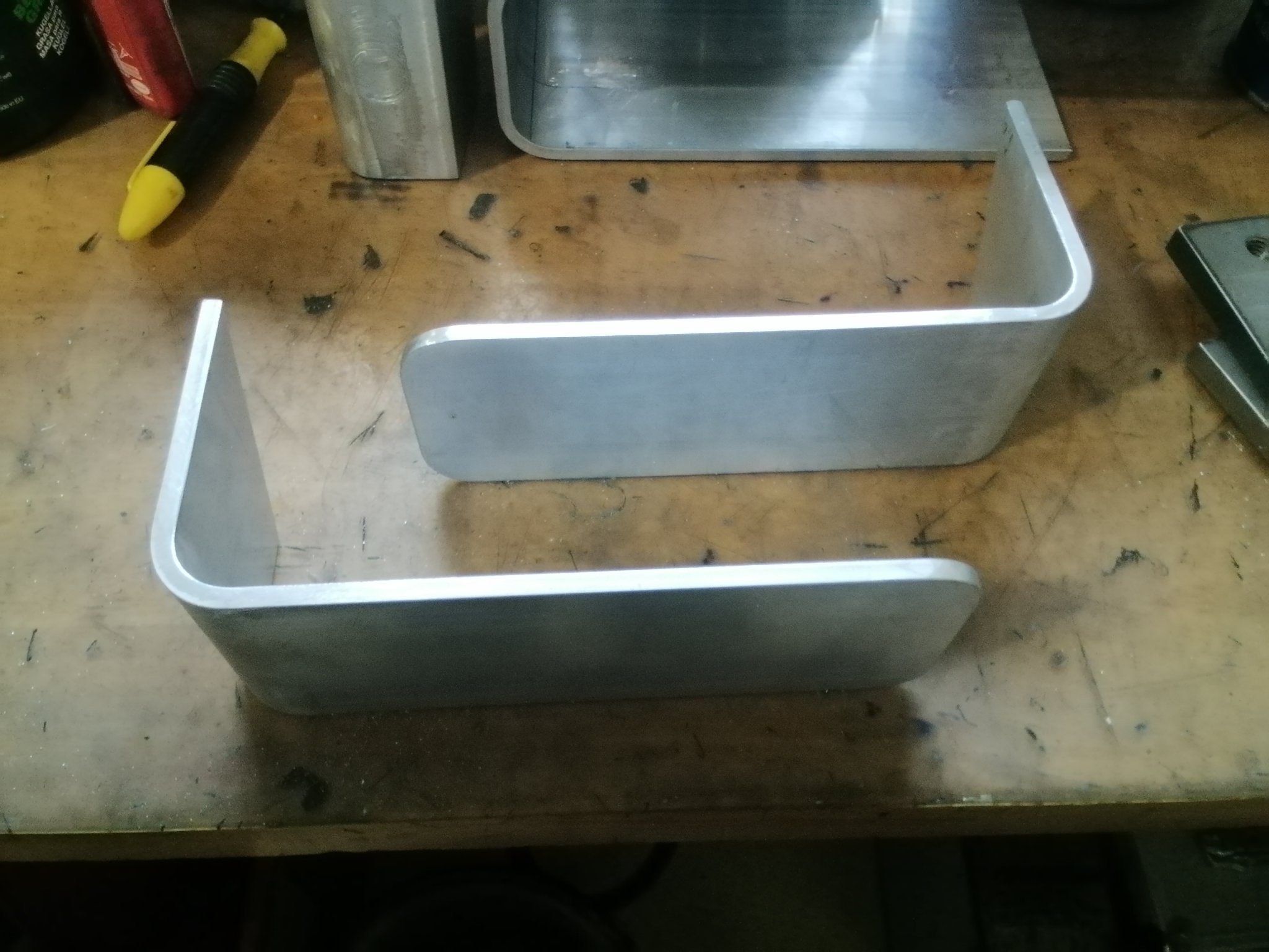

Reading posts here where people damaged their rear lights I wanted something that matches the design of the G1900 and yet protects the lenses.

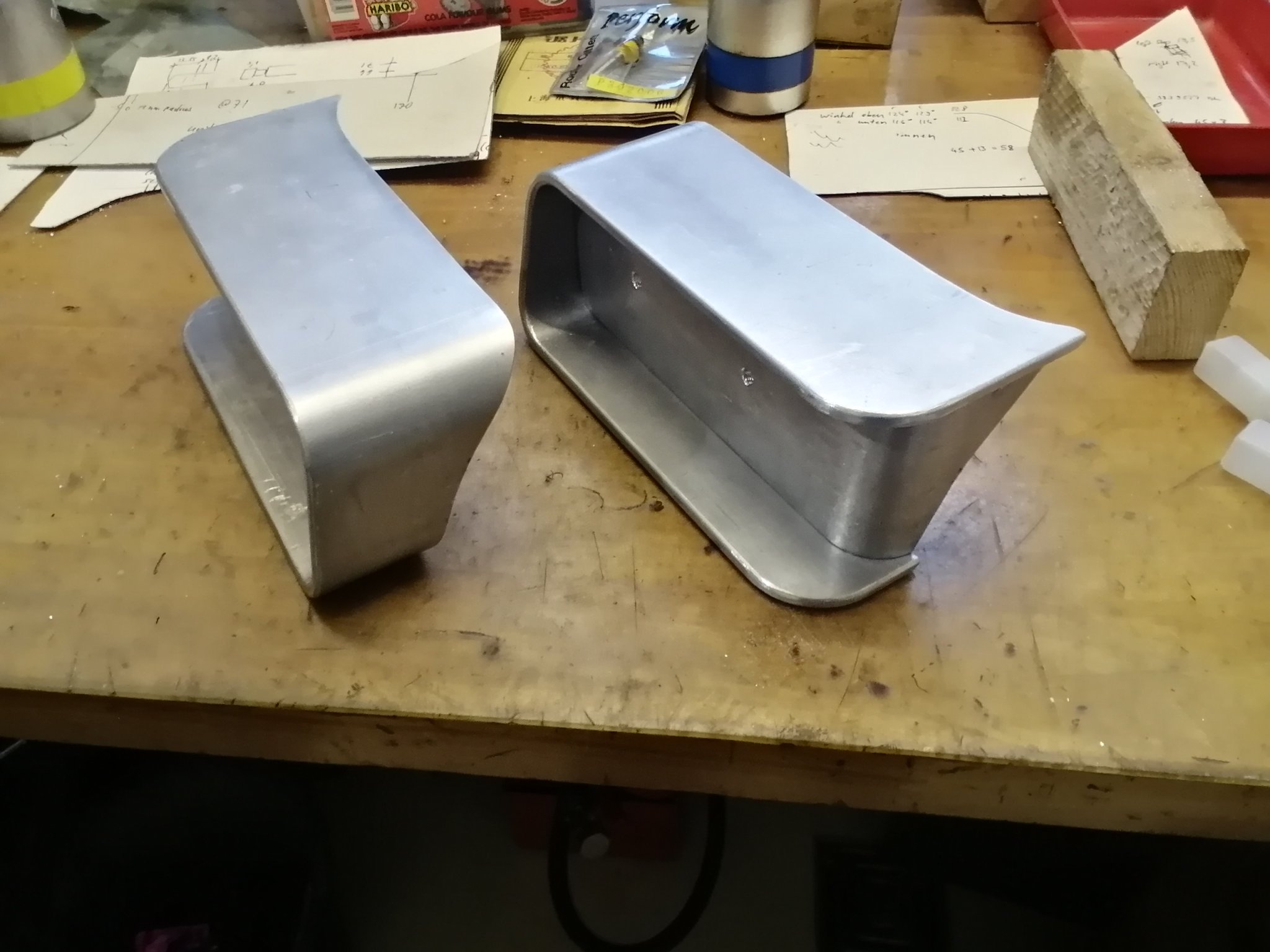

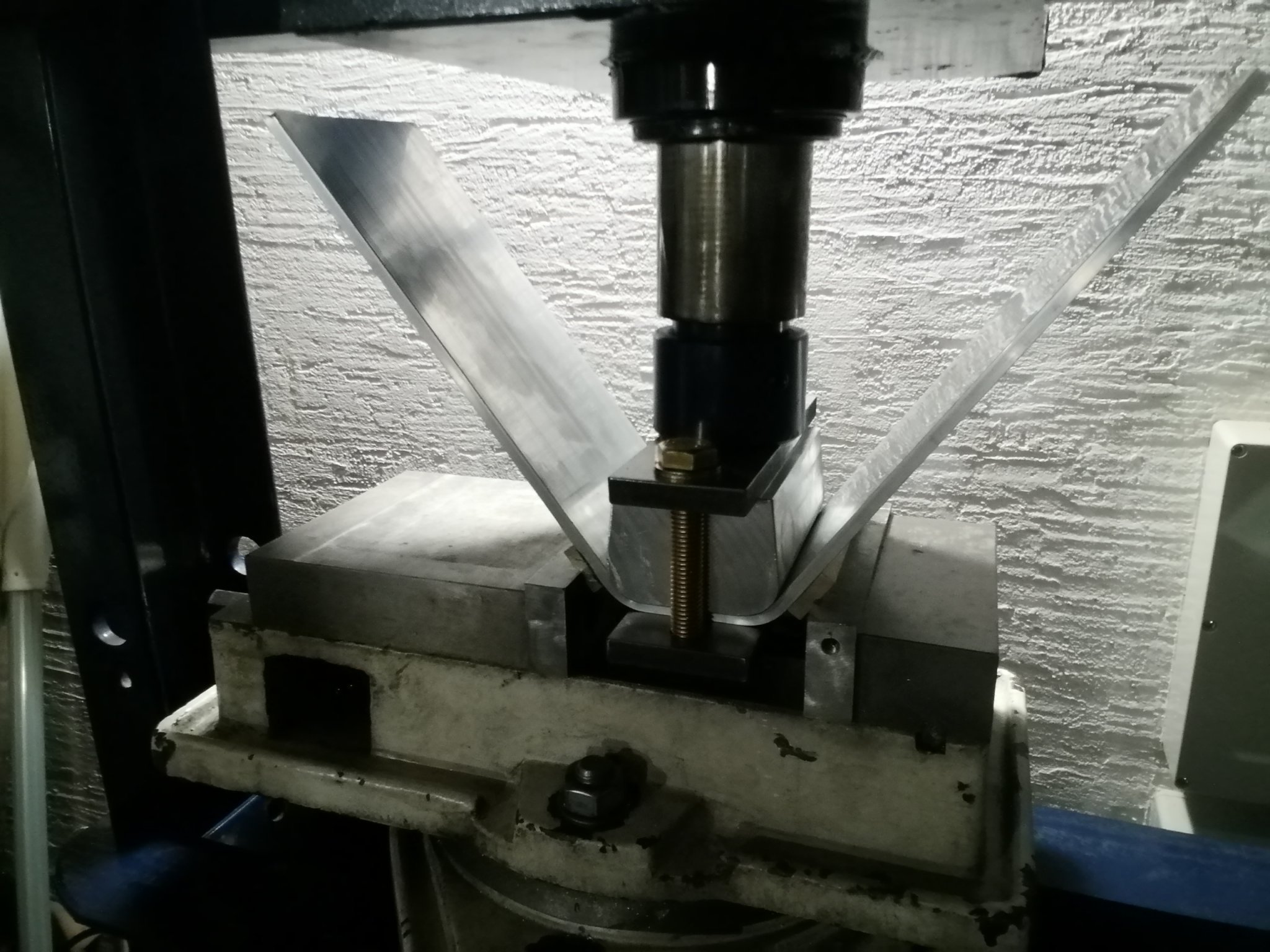

I came up with a design using two bent aluminium pieces. I made a bending fixture, annealed the 6060-T6 aluminium at the bending areas and bent it in the press.
Next was welding the pieces together. My TIG welder can only DC, so a friend of mine did the welding.
I had made cardboard templates of the shape of the fender, unfortunately very little straight parts there. With the templates I machined the contour and the final fitting was done on the tractor itself.

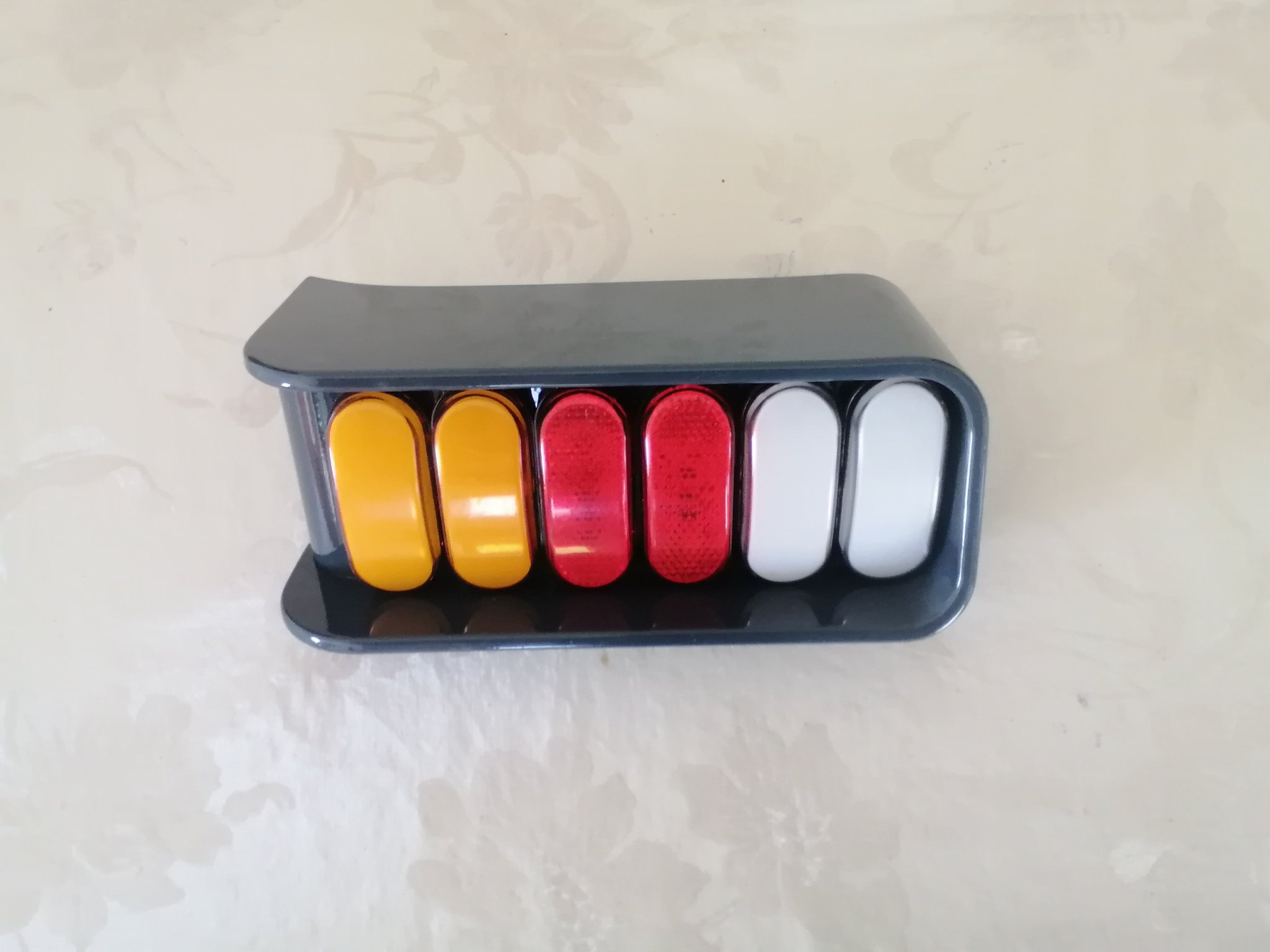

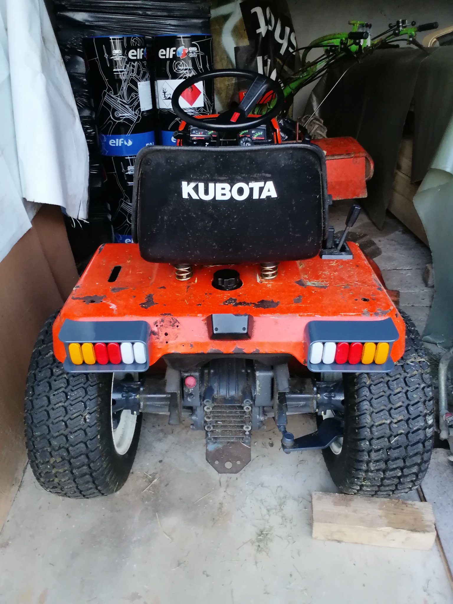

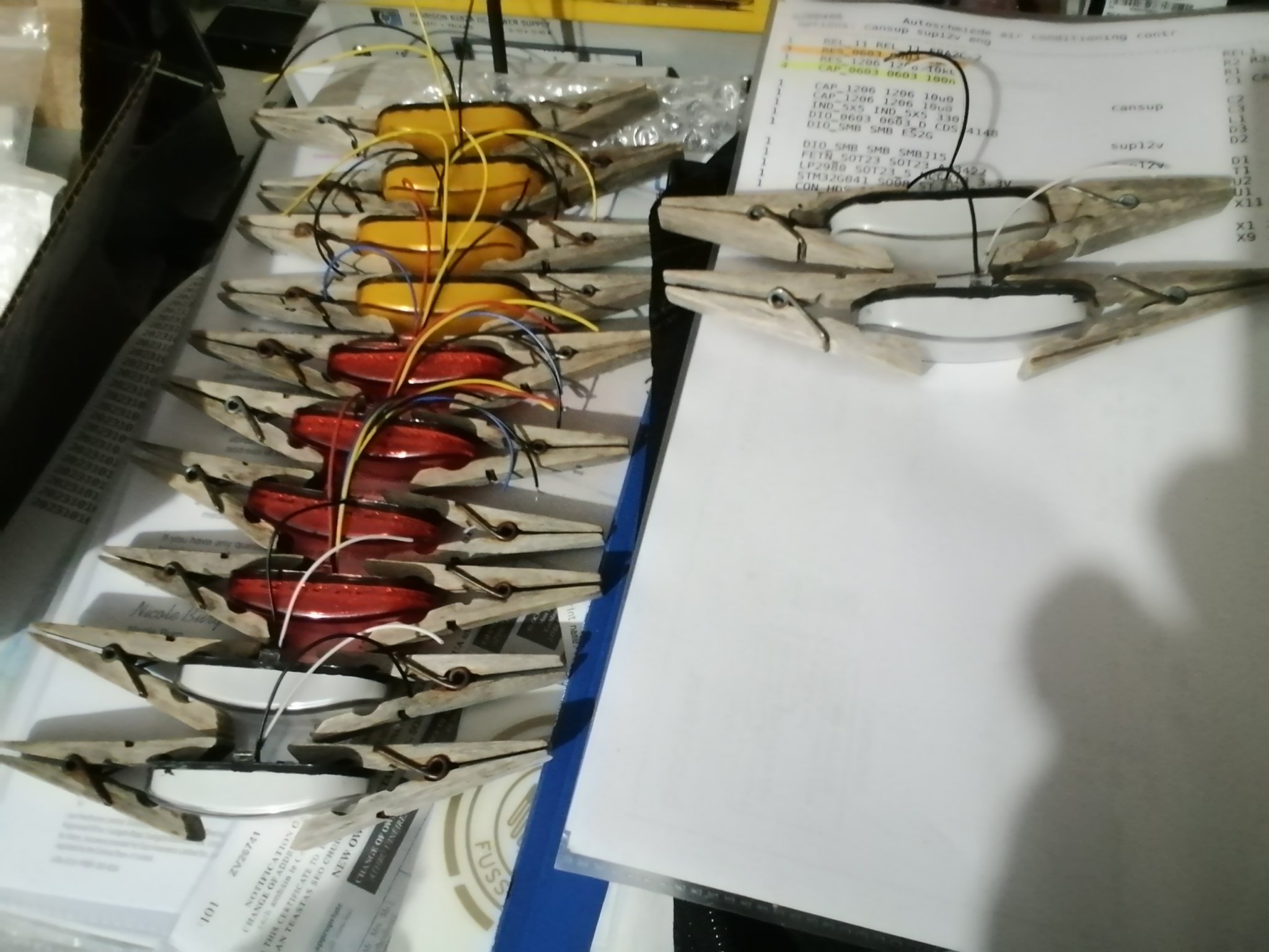

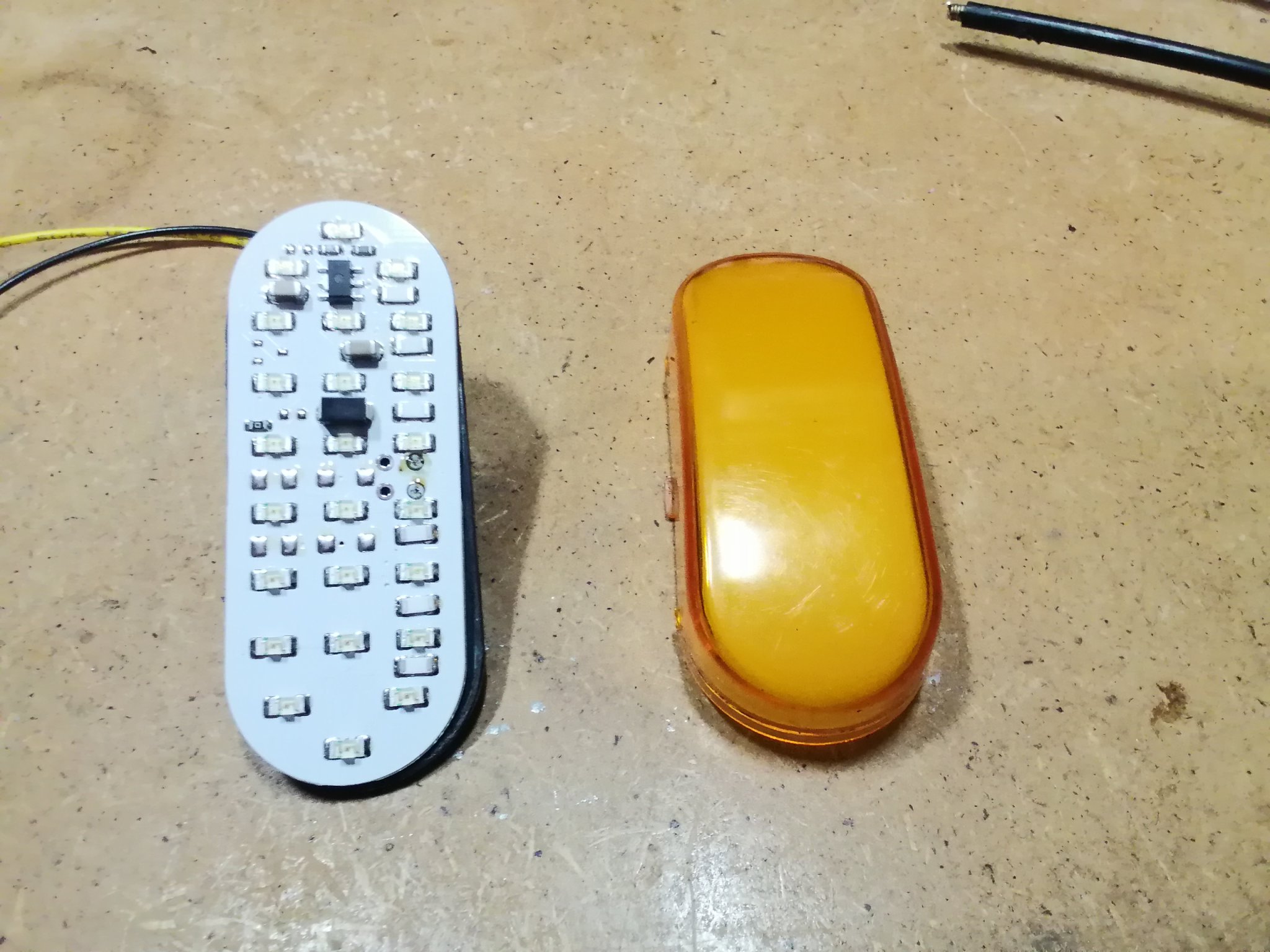

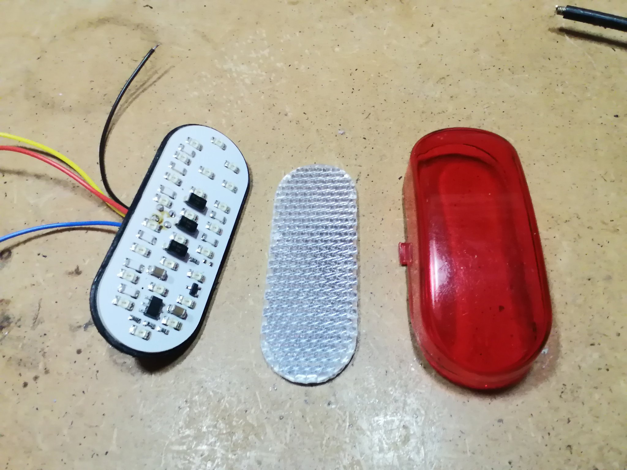

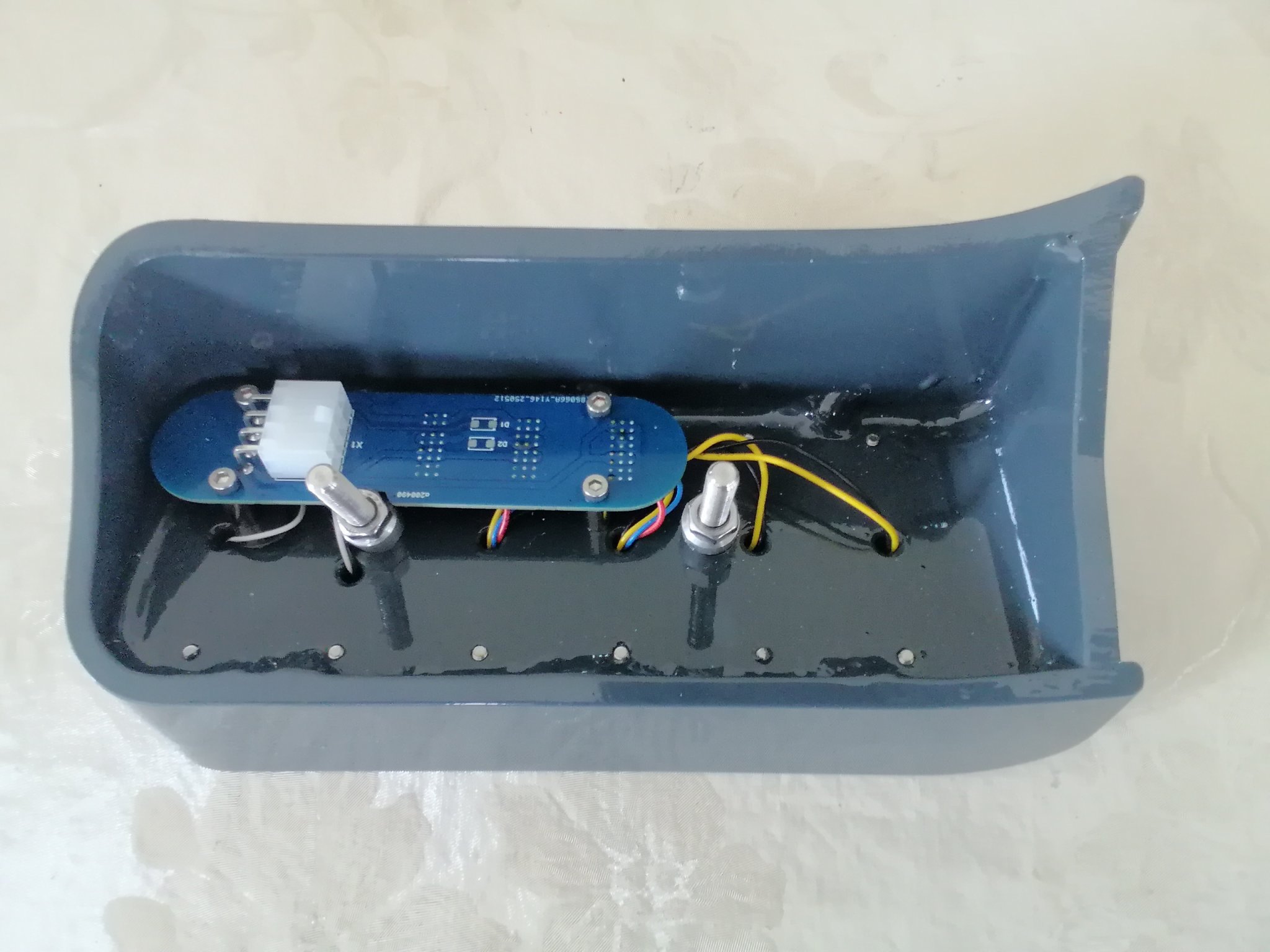

For the lights I had bought truck sidemarkers on Aliexpress. The electronics inside was working but not very efficient, they had 9 LEDs in parallel and then burnt most of the electricity with a voltage regulator.
I made my own electronics having three LEDs in series and then 8 groups of three in parallel. I also used brighter LEDs. So I have more light with lower current.
For the red lenses I included a two stage brightness control (running and brake lights) and also inserted a reflector. Everything is sealed with elastic glue.

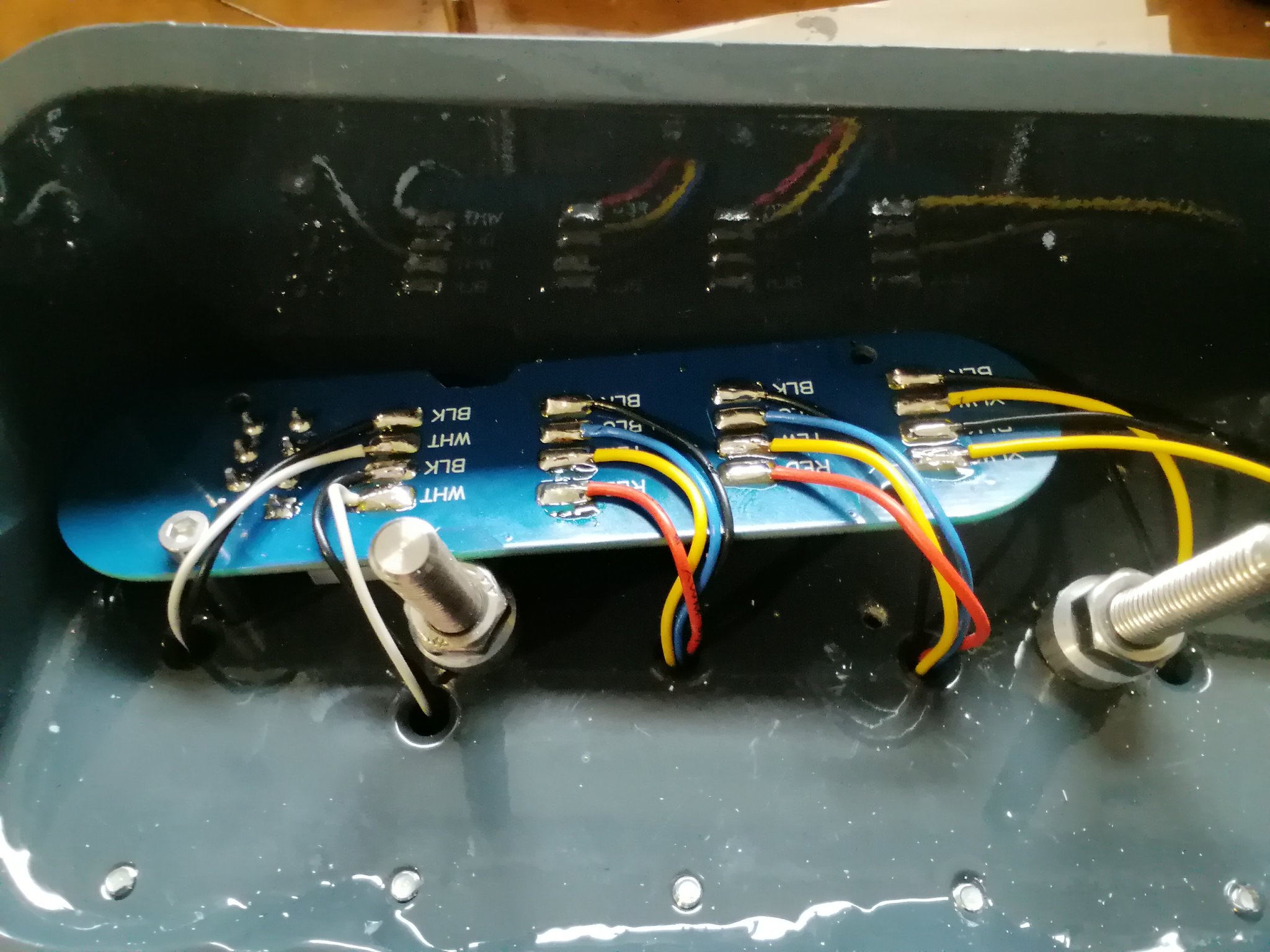

To connect all the individual wires I made a little adapter board and included a Molex connector for the wire loom.
Spray painted the enclosures, unfortunately the satin paint turned out high gloss, have to talk to my paint guy why this happened.

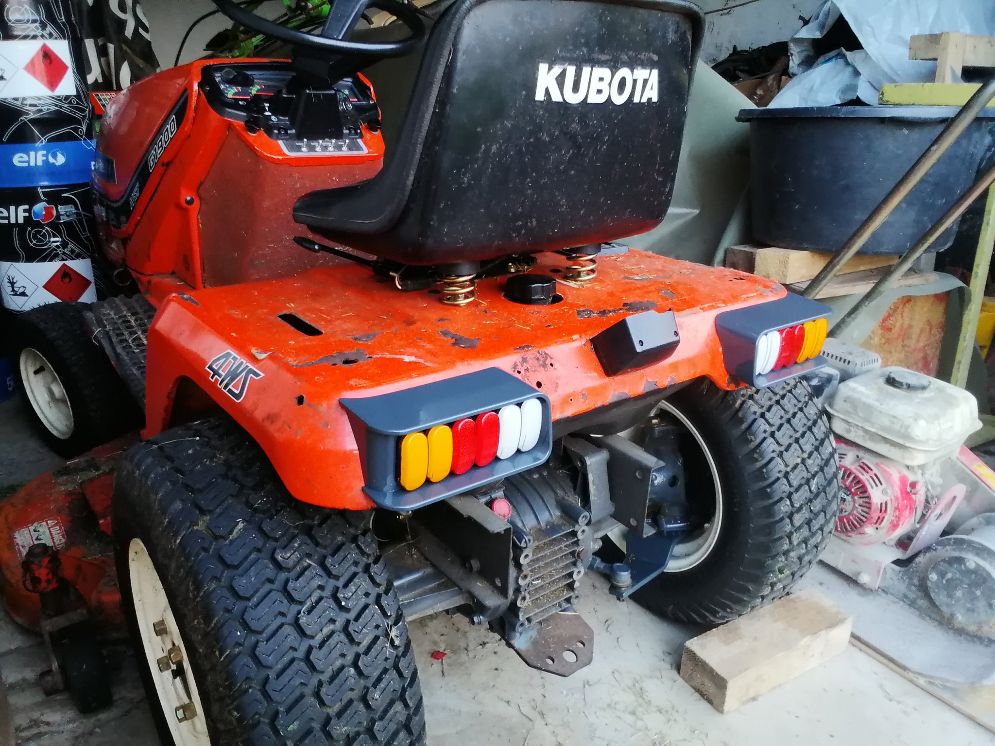

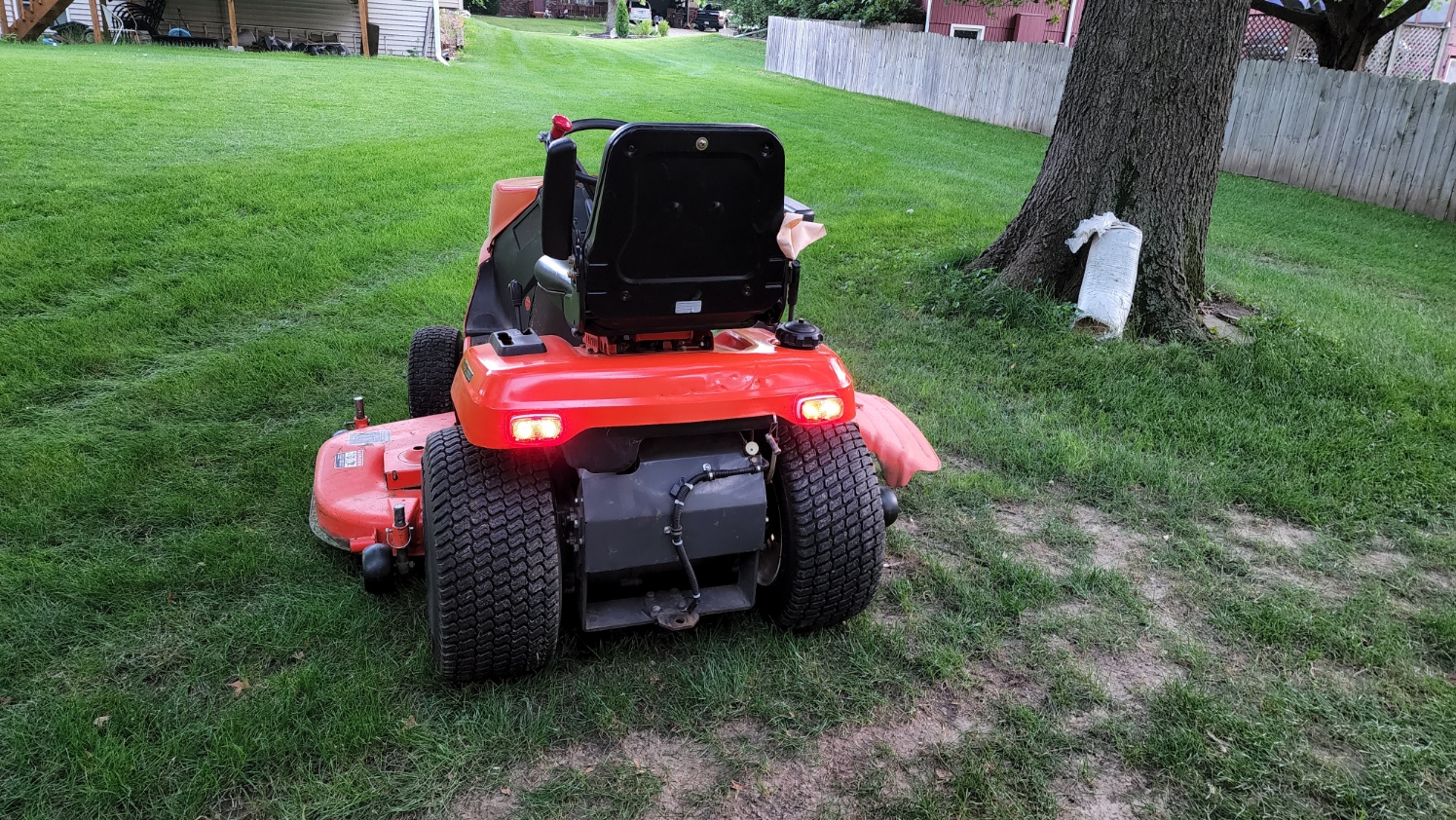

Lights look good on the tractor, I think, very happy with the result. The wire loom will be done when the body parts of the tractor are being restored.

You are gonna have the world's first G1900 valued at over 40K when done.:cool:
Nice Craftsmanship in all you do Sir.

Amazing craftsmanship. And I thought I'd gone over the top with the lighting mods I did on my G2160 retrofitting very bright LED driving lights inside the stock housings and lenses, and removing the rear reflectors, finding truck running lights that nearly matched the reflectors then adding in all the wiring and using relays to cut power consumption through the switch.

Thank you for the kind words Sir, which are encouraging to continue doing up the G1900. (y)
But I do not think anybody would give me 40k for a 35ish year old tractor with over 6000 hours on the clock. 🤣
I just do it for myself, more of a hobby and certainly not economical just looking at the hours I spend. For good reason I do not keep a record of those. 🤣
I just hate throwing things away just because they are old. Often the quality is better and they are easier to repair and maintain than newer models.
Pictures (before, after) show another of those projects where my brain was not functioning properly when I started it :giggle:

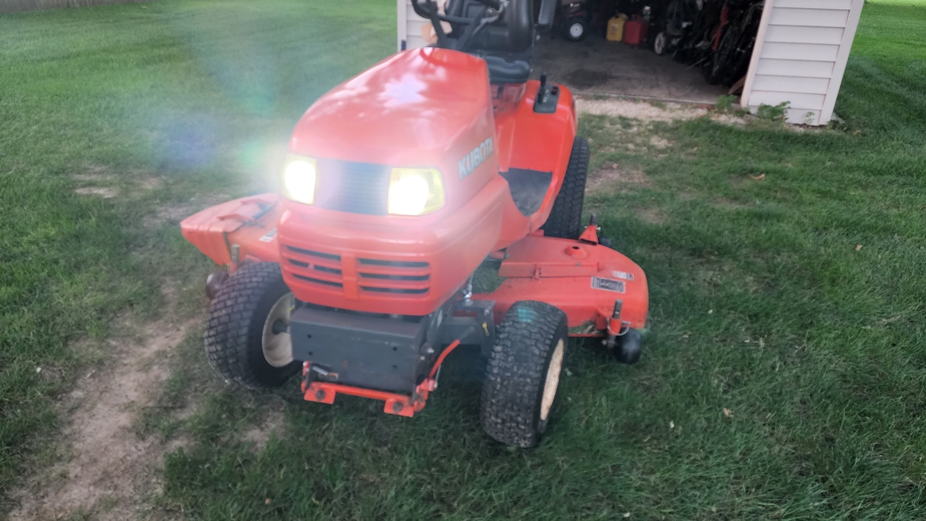

Exactly. I rarely do any work at night and the street in front of my house is not travelled much as it's only about 800' or so long. But when I do work around dusk I use those lights Fo Sho!
I still have to hook up the illumination to my oil pressure gauge and I want a smaller tach and also want to add a water temp gauge. My tach is huge because my brain did not realize the proper relationship between metric and SAE size so it's WAY bigger than I wanted LOL. My final goal with it is to get a temp gauge and a volt meter on it, but, with that giant tach no space on one side.

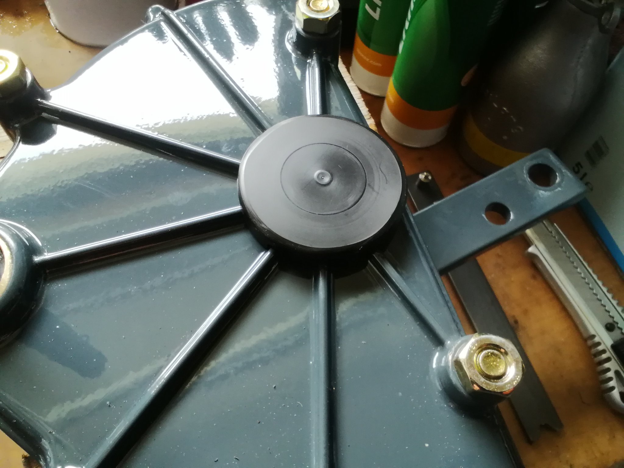

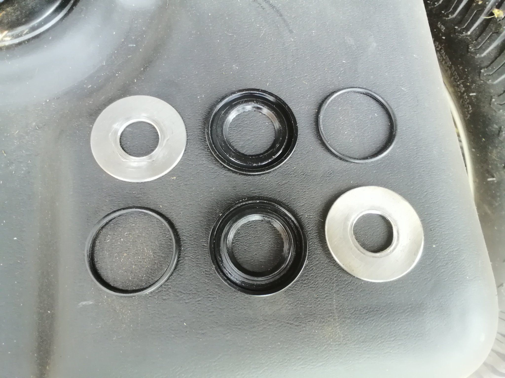

Steering Box Modification

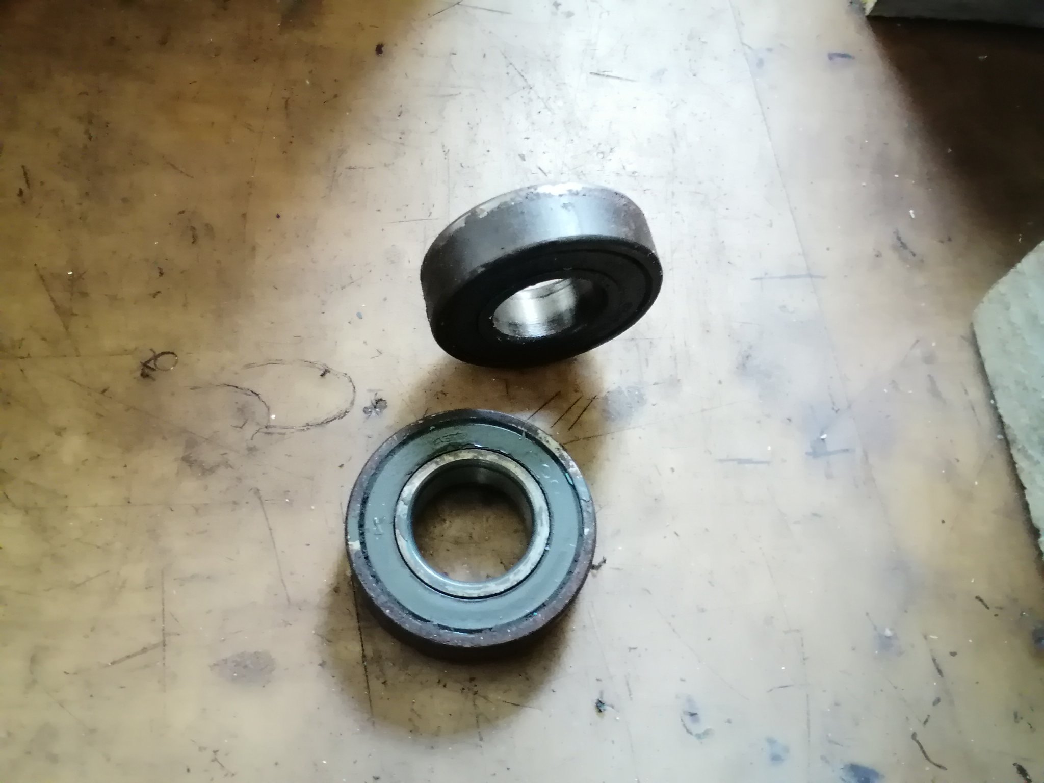

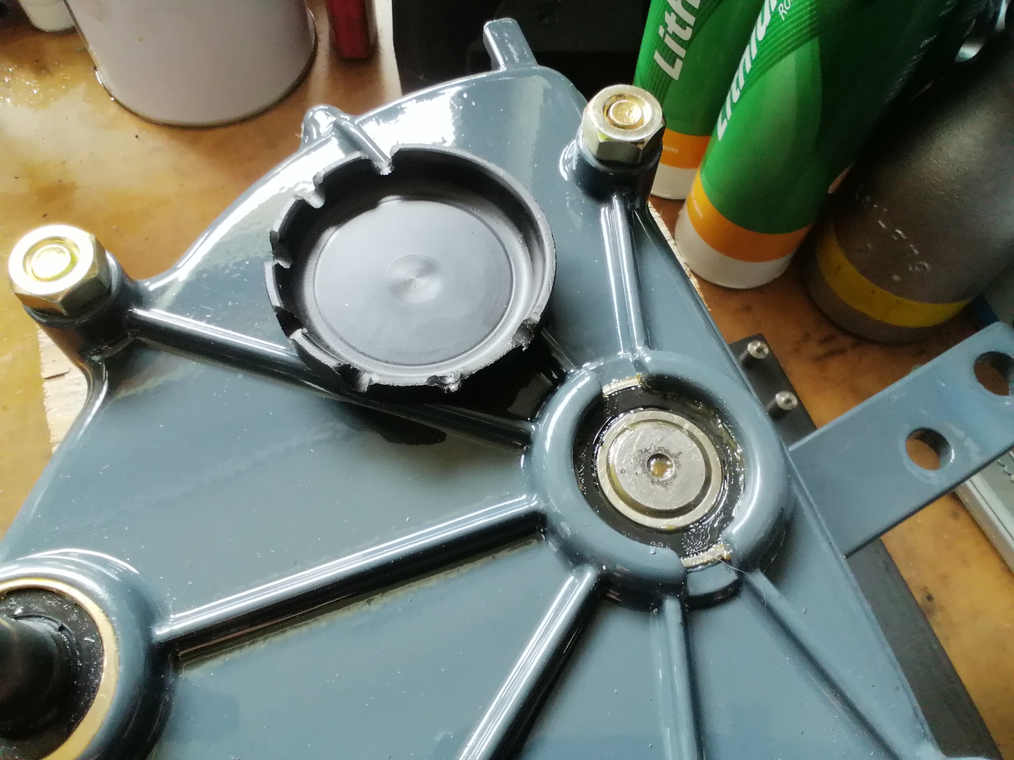

The main bearings of the output shaft were corroded. I had bought that steering box from the US, so I do not know what the history was.
I would imagine that it is well protected from water under the floor panel but I wanted to make sure this does not happen again.
So I made a small cap that goes over the bearing and protects it from water ingress.

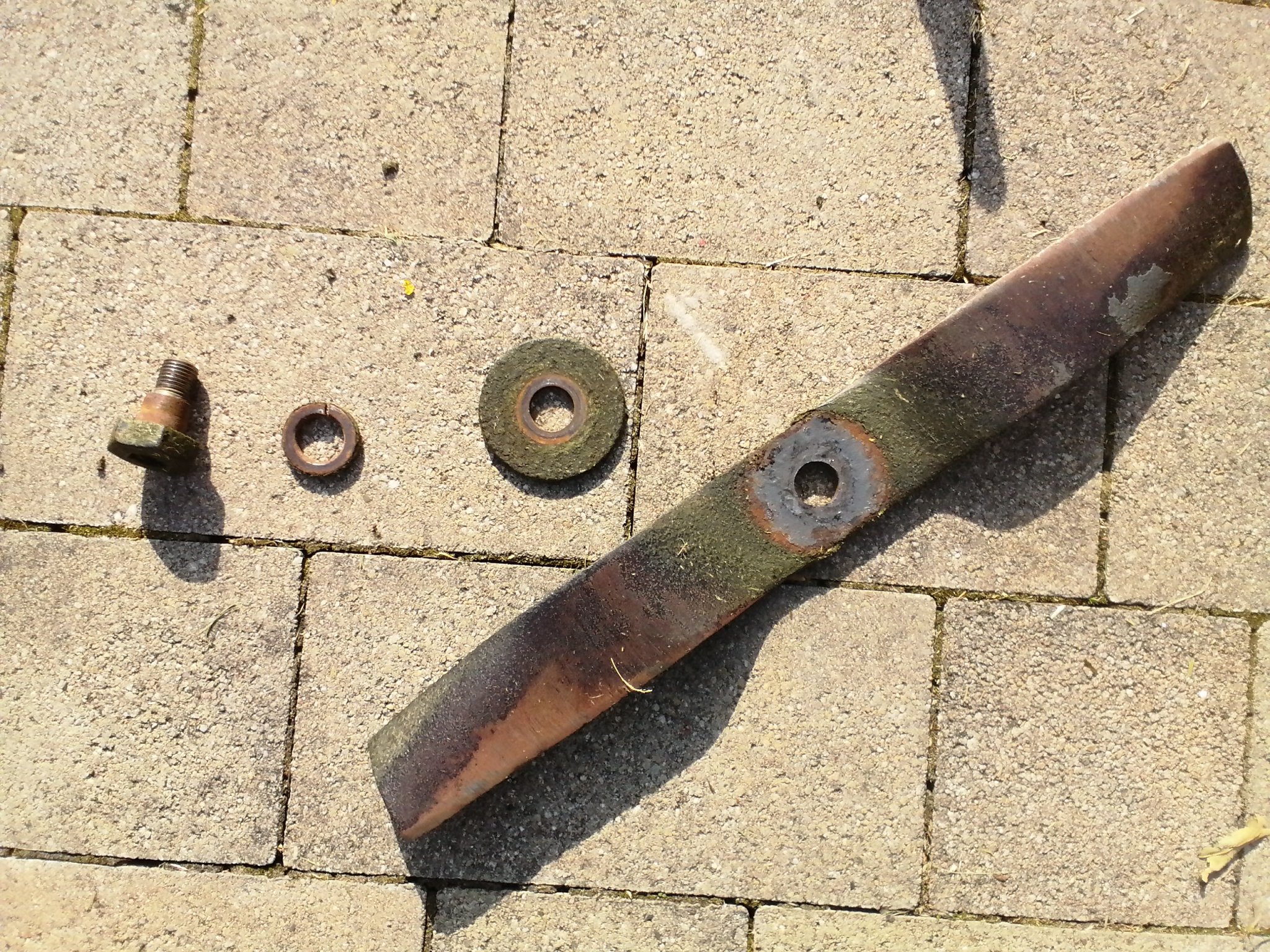

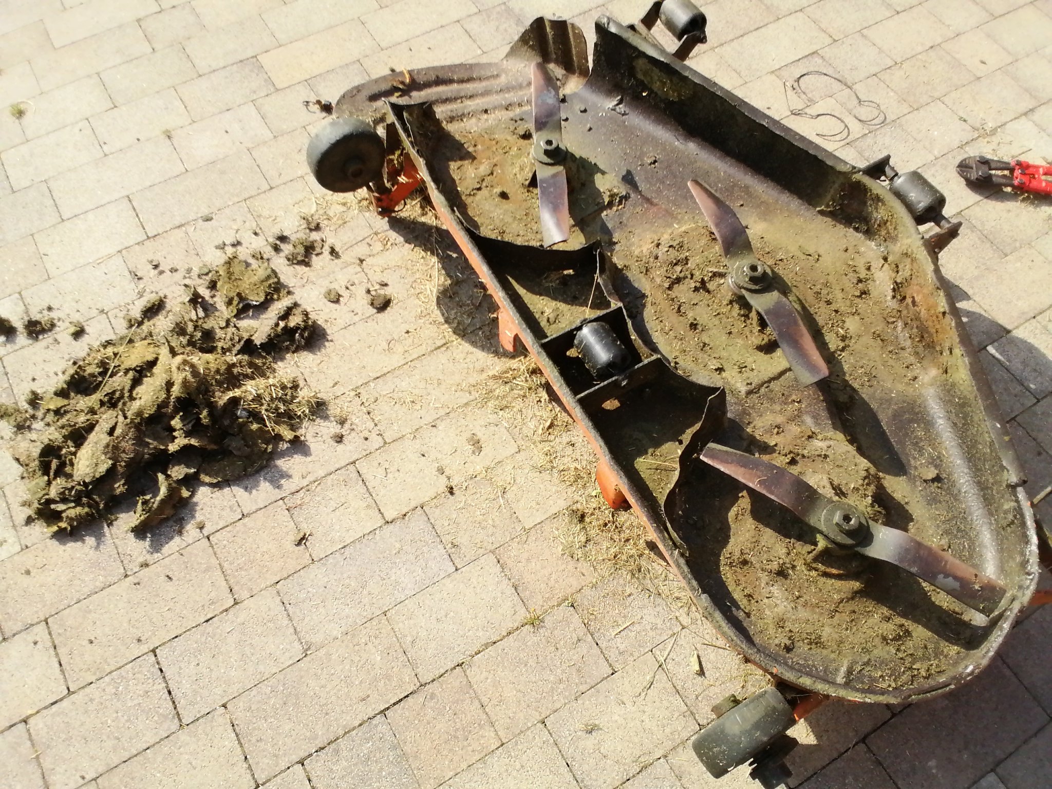

RC48-G20K Blade change

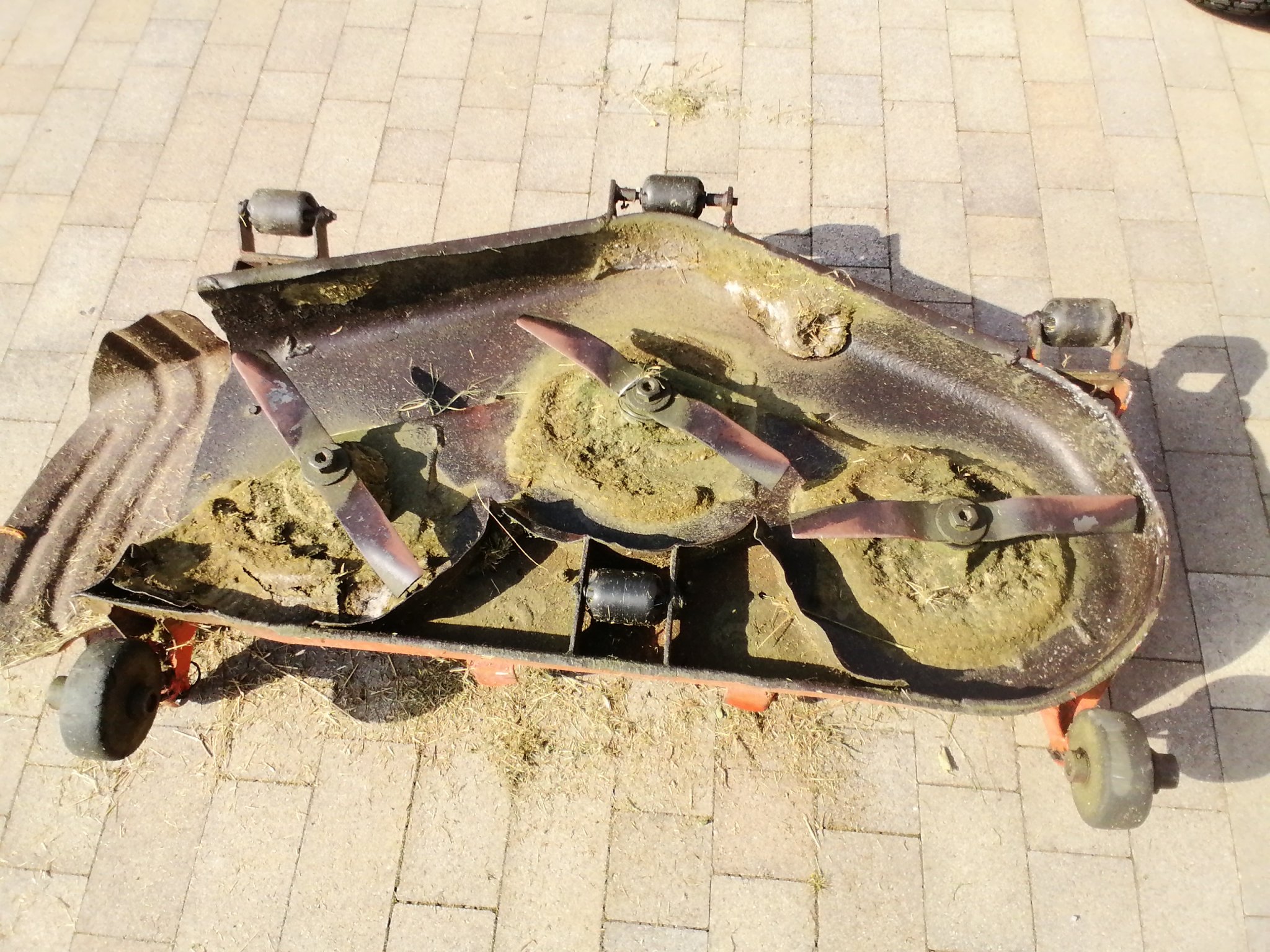

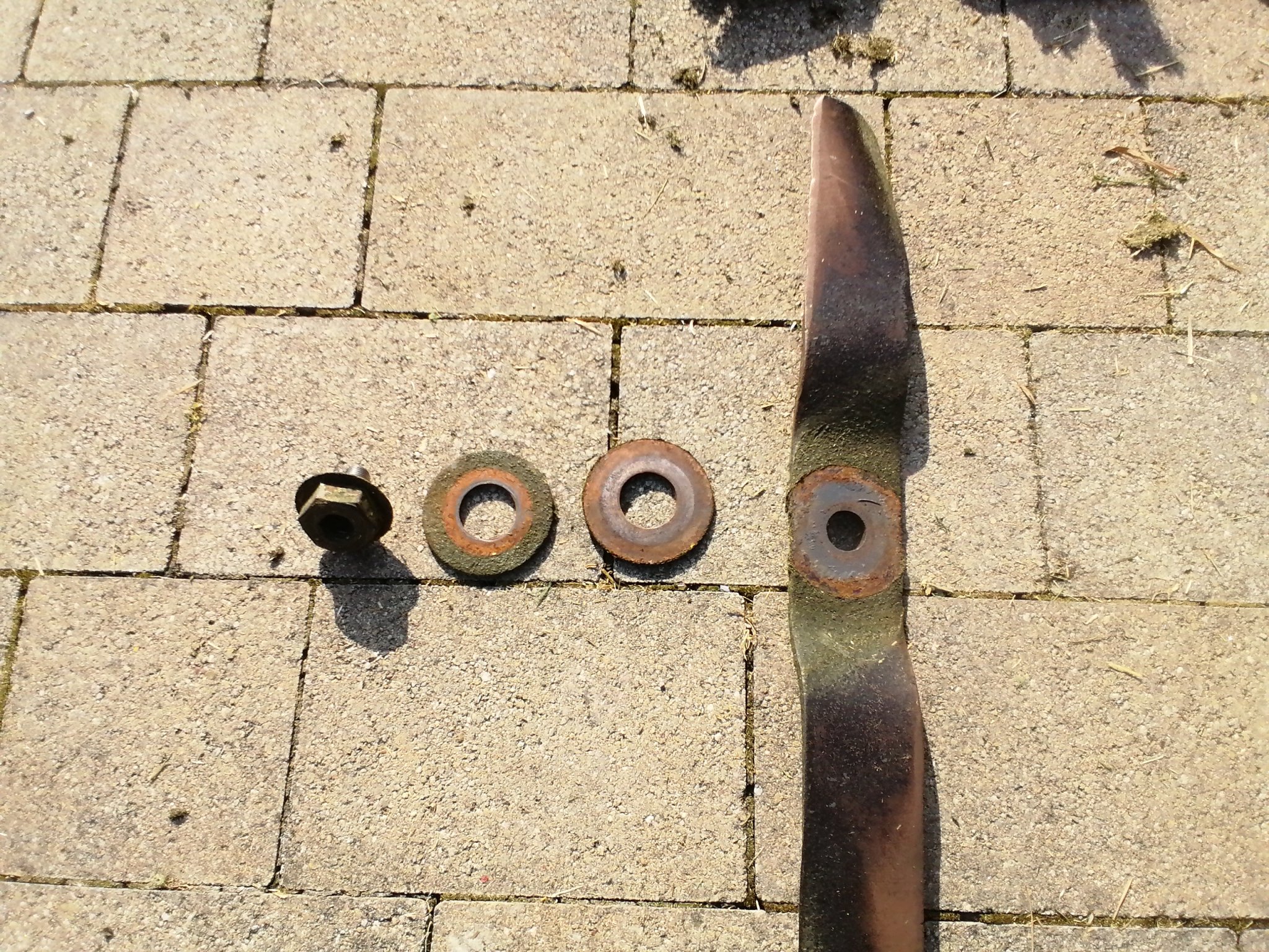

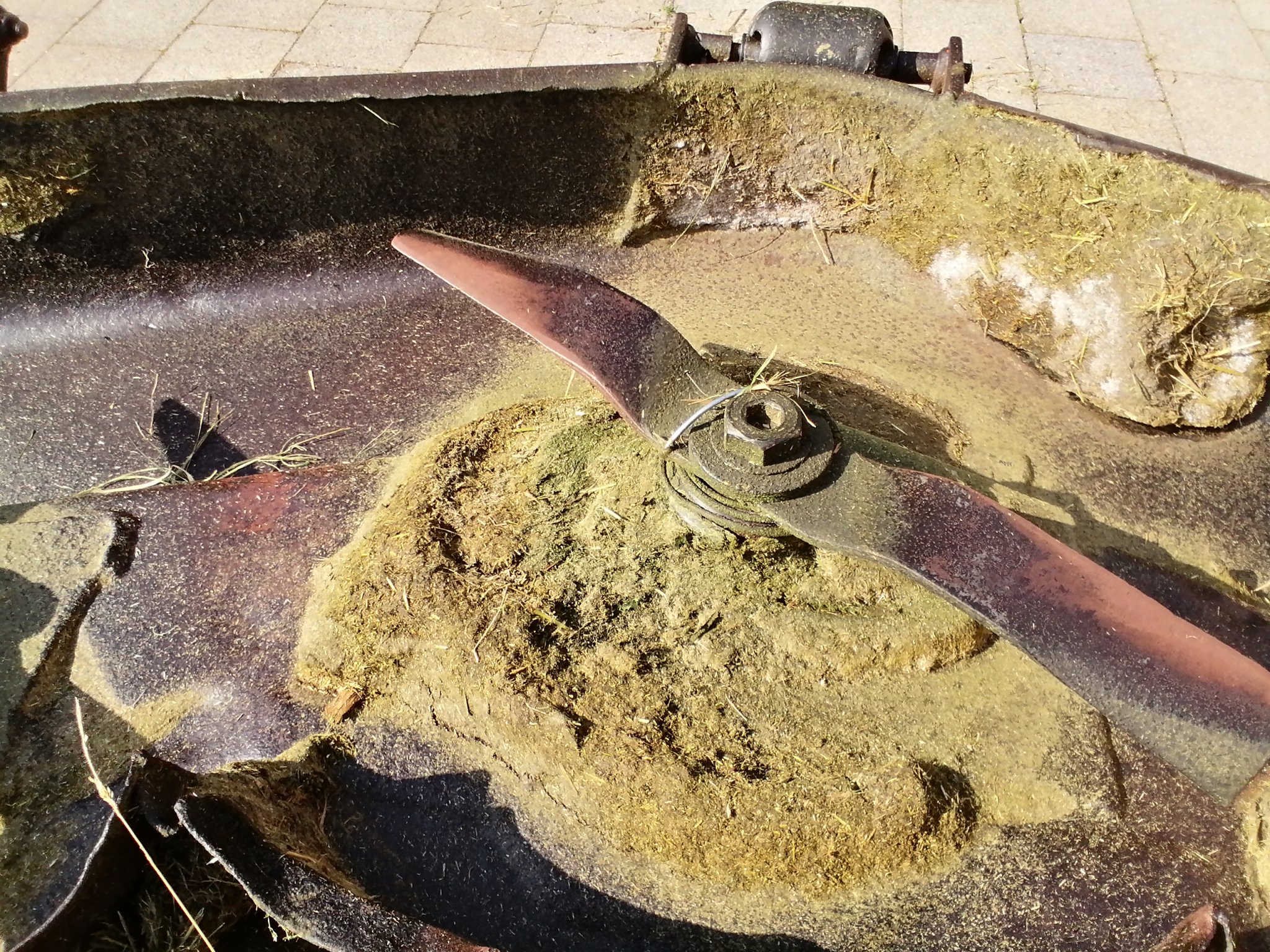

After hitting a few bigger pieces of concrete, ahem 😗 , I decided to replace the blades.
Took off the deck and turned it upside down.

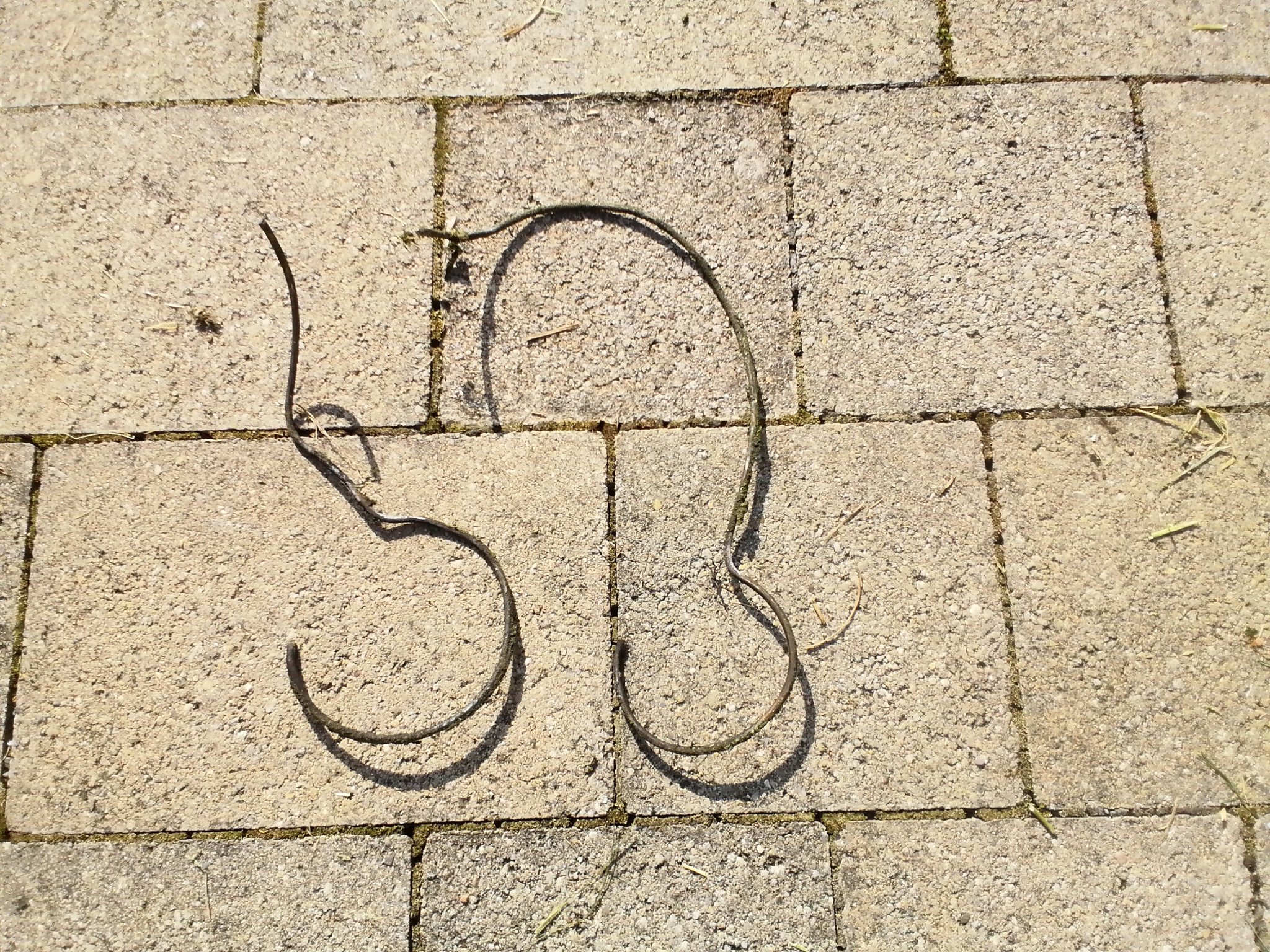

Discovered a wire around the centre blade. Don't know where I picked that one up... Cut it off with a bolt cutter.

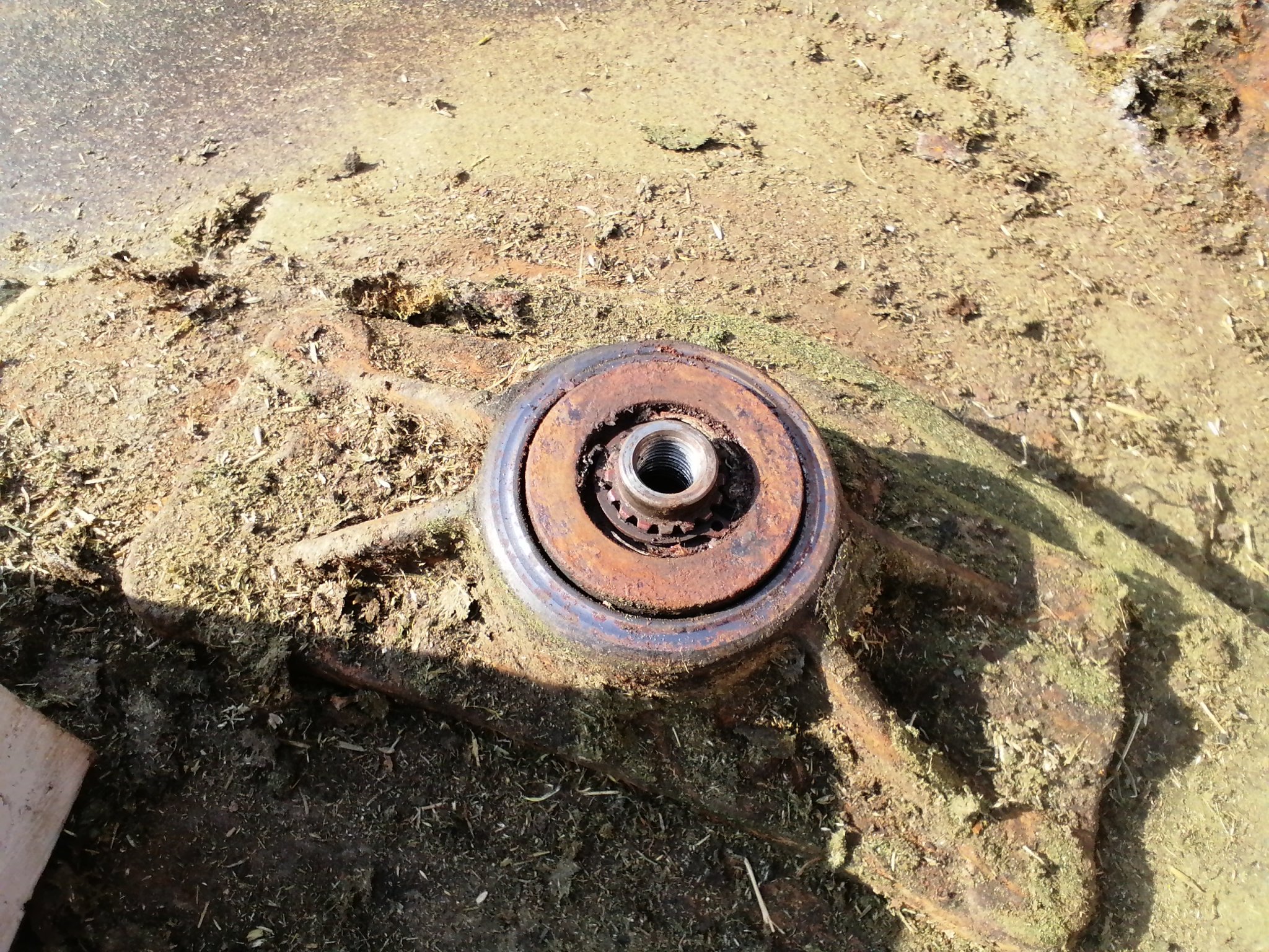

Then cleaned off all the grass that was stuck inside and causes the deck to rust. Mine still works but I consider it beyond economical repair. Which probably means that I will repair it :giggle:

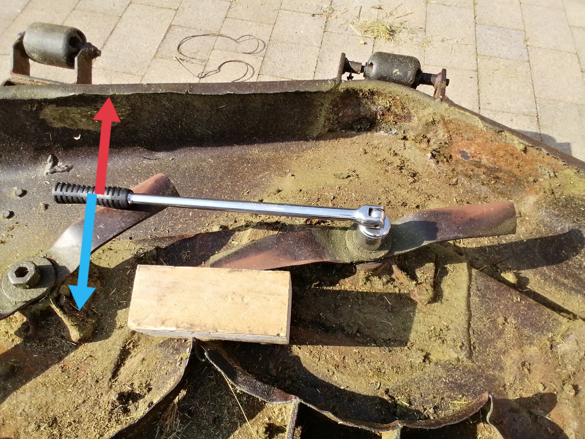

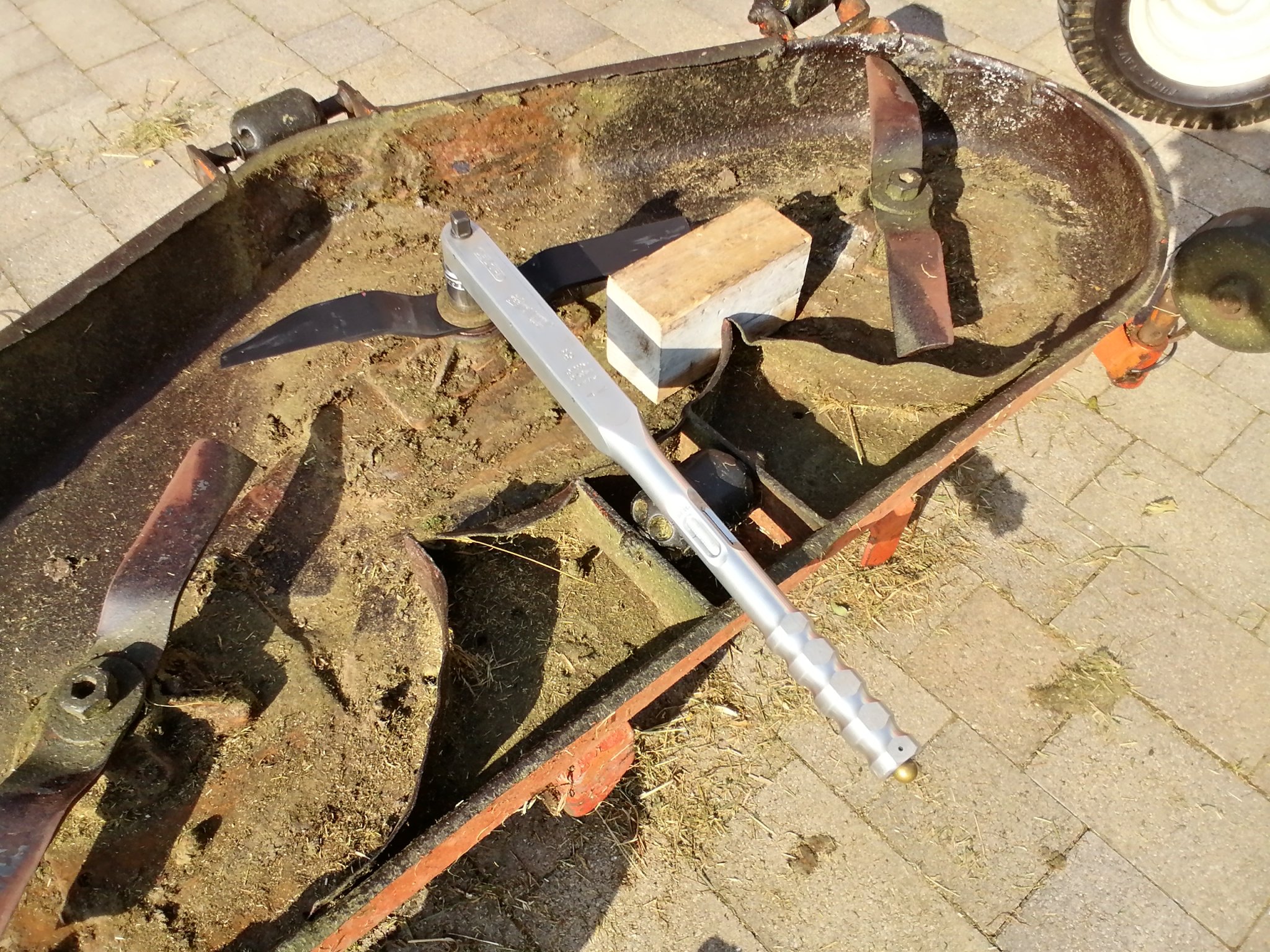

Now open the bolt holding the centre blade (blue arrow) Use a wooden block to hold the blade in place. The nut required is 30mm. Use a pipe for more leverage if required. CAUTION: the centre bolt on the RC48-G20R deck (rear discharge) has left hand thread (red arrow) !

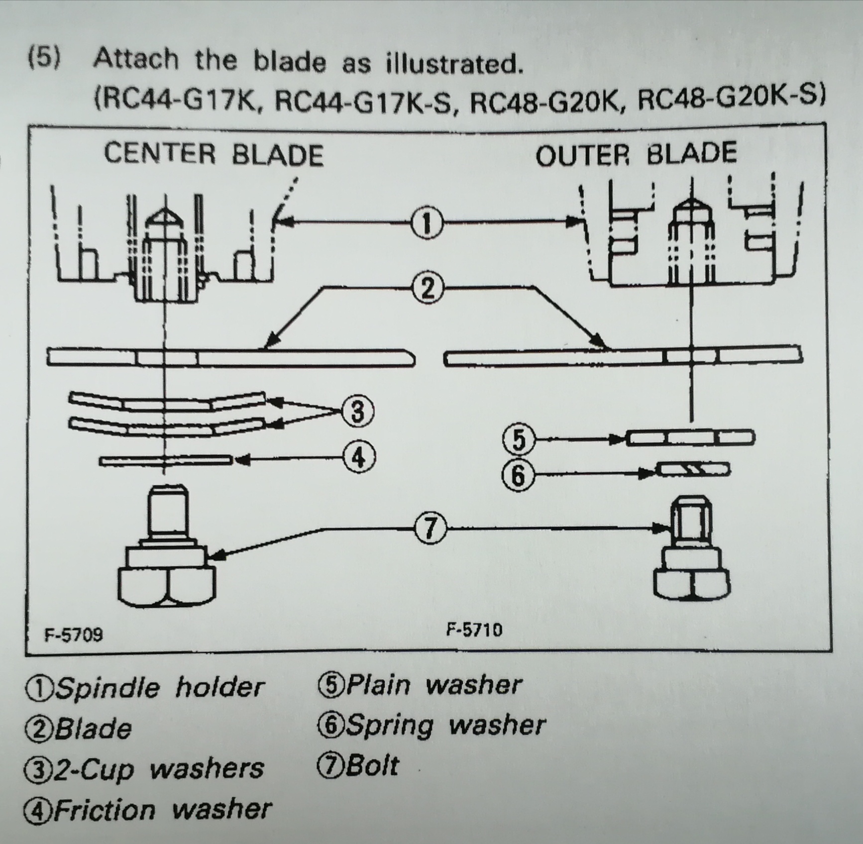

Clean everything. Centre blade has bolt, washer, two cup washers. Outer blades have bolt, spring washer and plain washer.
Put new blade on spindle and attach parts in correct order. Make sure cup washers are with the centre raised part to the bolt side.
Tighten with correct torque using a torque wrench.
Torque is 100-120Nm (72-87ft-lbs) for center blade and 126-150Nm (91-109ft-lbs) for outer blades.
That's it.

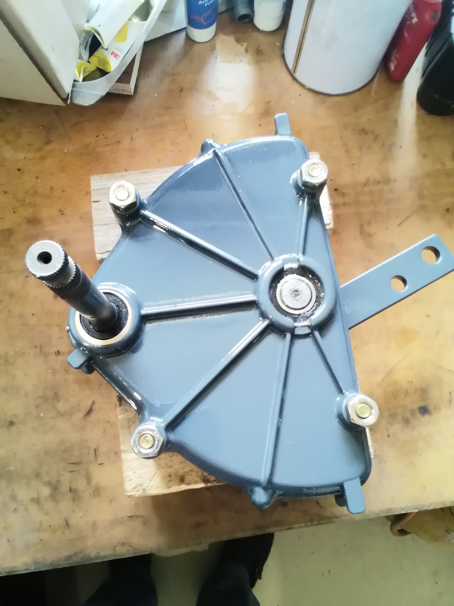

Once we are at it we may as well check the oil level in the gear box, grease all grease nipples (3 on top of deck, 2 on rear wheels), grease the vertical wheel bar, the PTO shaft splines, the 2 PTO u-joint grease nipples, the splines on the tractor PTO shaft and all pins attaching the deck to the tractor.

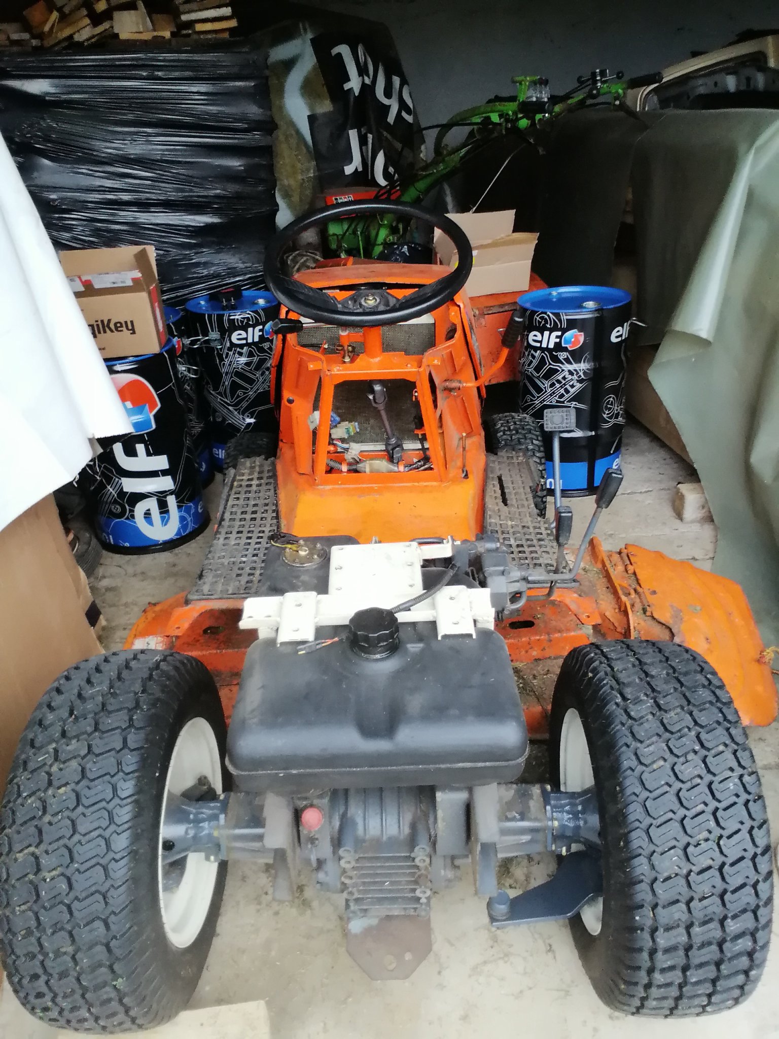

Steering

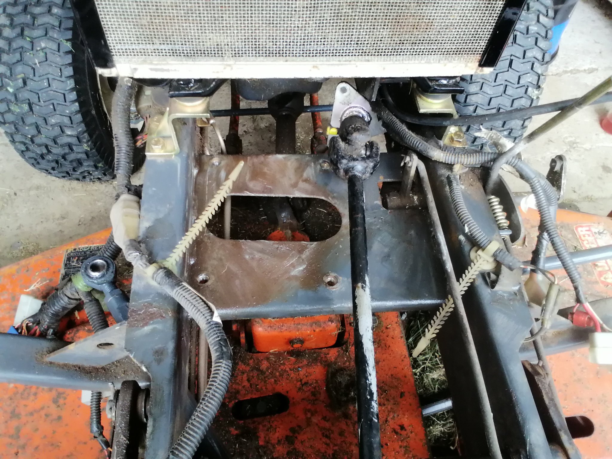

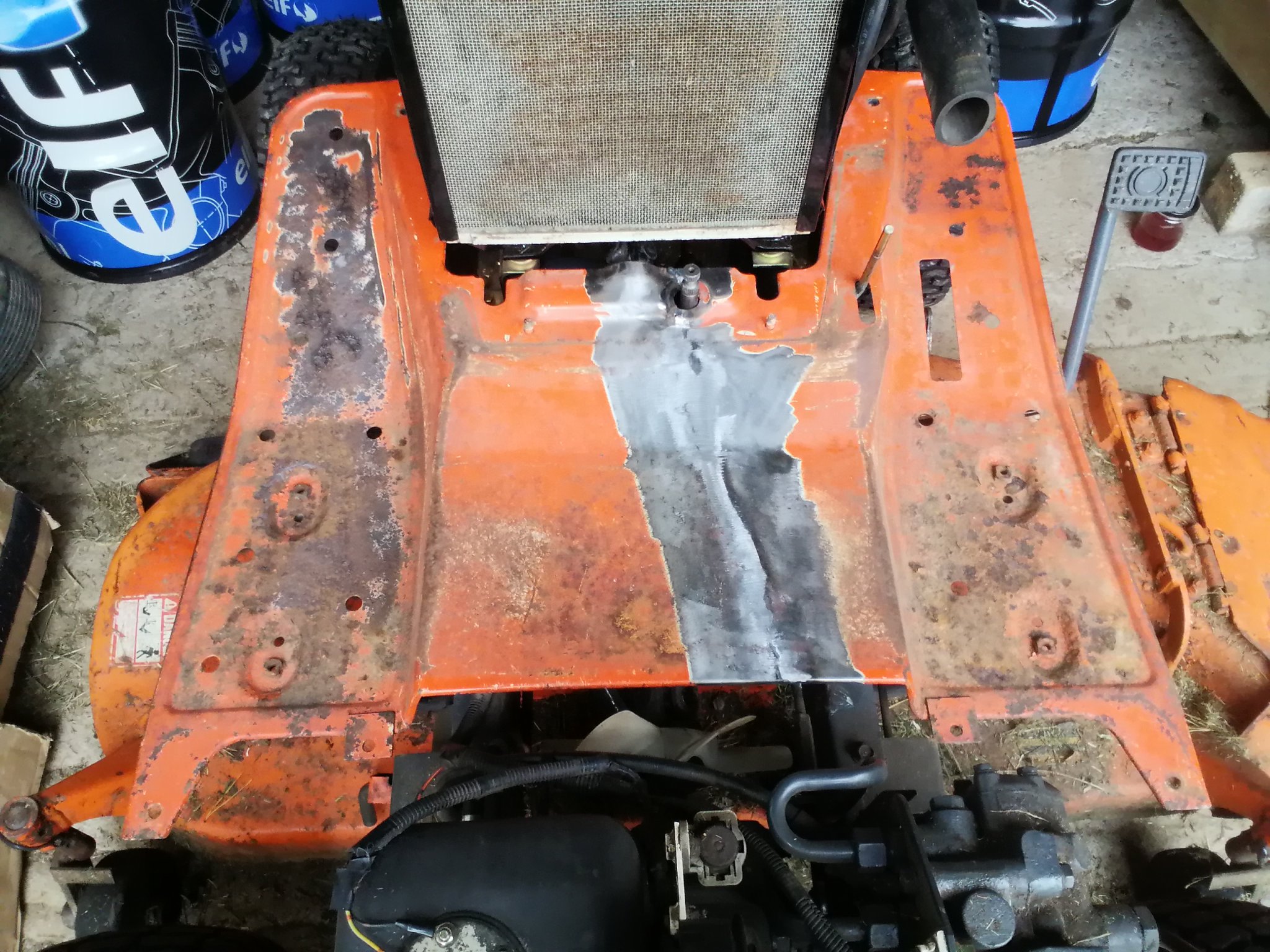

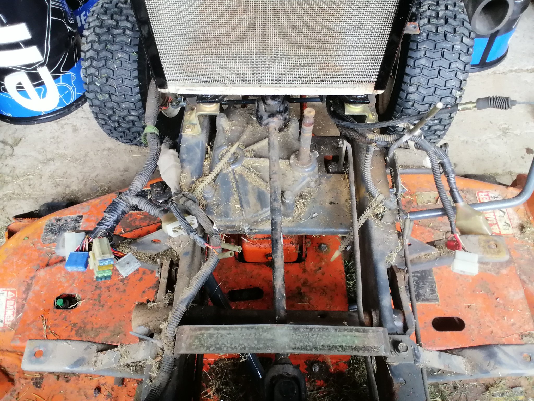

Time to swap out the original to the modifed steering box. To do that the floor panel has to be removed. So steering wheel off, seat off, fender off, instrument panel off, remove throttle and PTO linkages, disconnect all connectors, take out clamp bolts of steering column, remove panel assembly, remove knob of brake release lever and then the floor can be taken off.
Clean everything. To remove the steering box the pitman arm has to be removed. Since it took me a good few hours in the work shop there was not a hope I could do it on the tractor. Instead I removed the driveshaft at the engine side and that allowed the steering box to come out. A bit of rust under the box, but I think everything was assembled and then painted. There was almost no paint under the steering box either. I put some corrosion protection wax over it as a temporary fix until everything is being taken apart over the winter and resprayed.
Modified play free steering box ready to be bolted in.
I tried my new floor panel that I had bought cut in half and that I had welded together. Fits nicely.
Removed it again to remove rust and paint it.

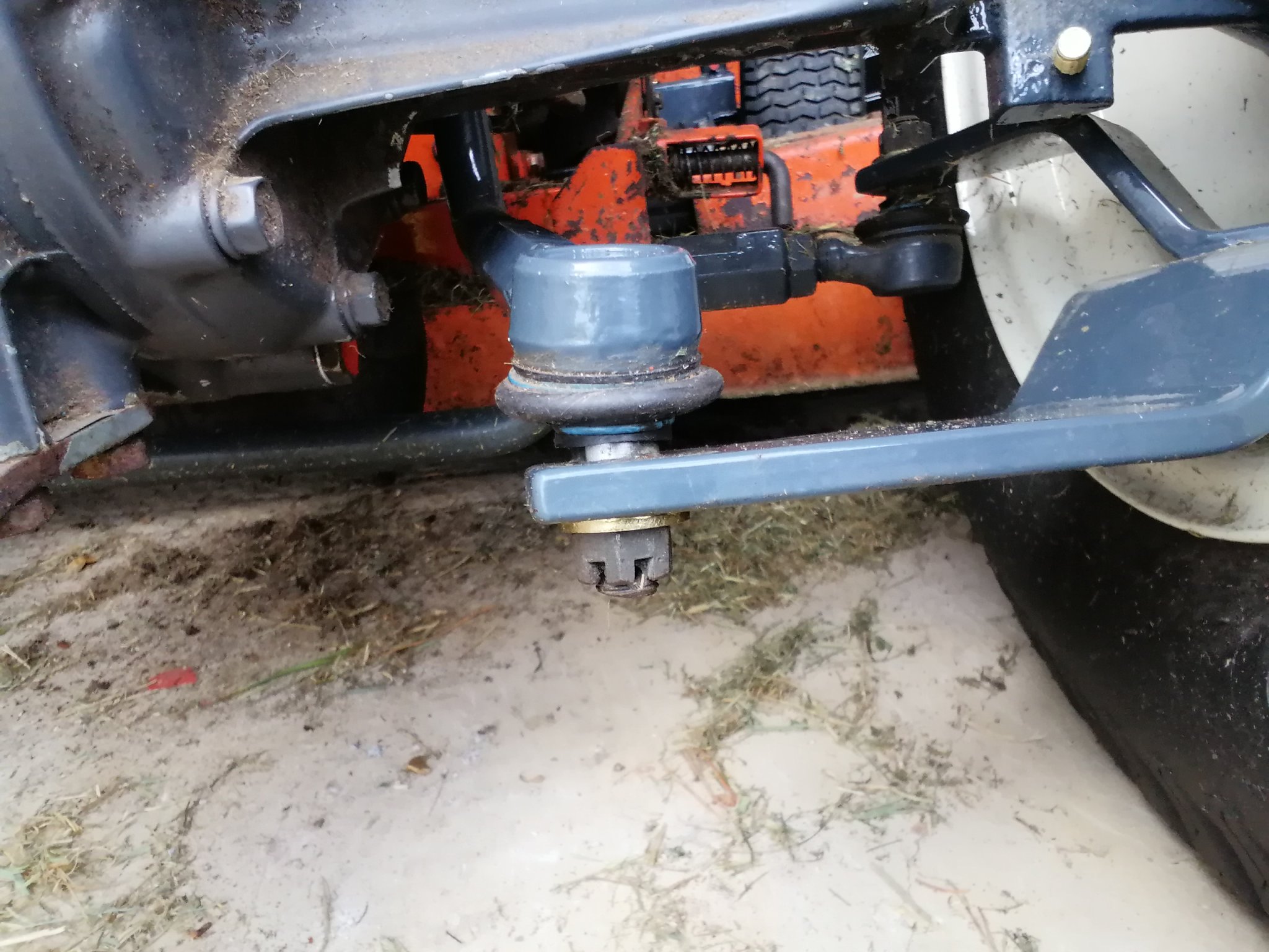

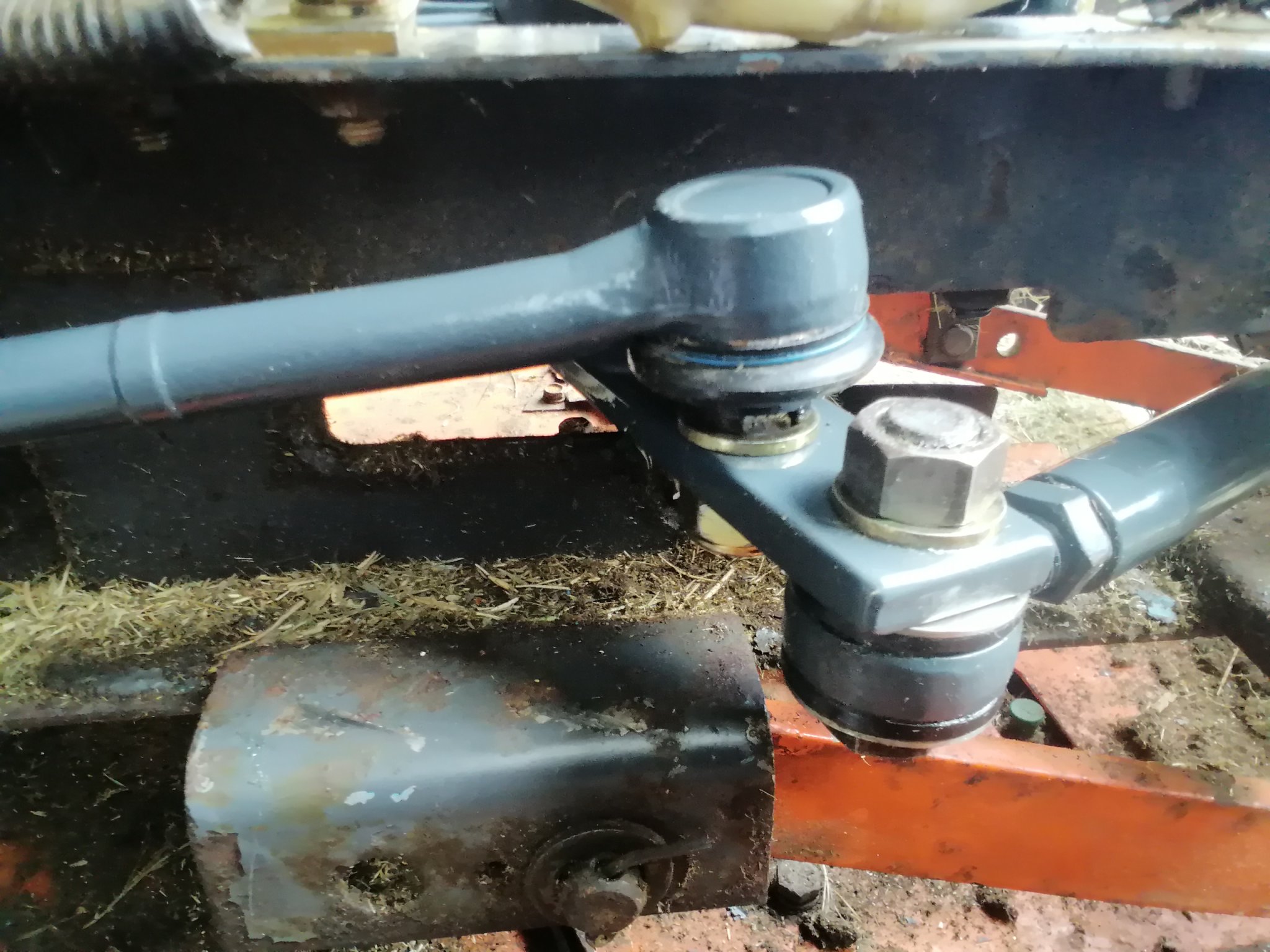

The rear wheel steering linkage is not straight and hence is hanging to one side. Looks awful and the ball joint pin is eating into the material. Not ideal. Also the ball joint at the pitman arm is open, so dirt and grit can do damage. I made two discs from Delrin with an O-ring groove. Together with two O-rings and washers it keeps the grease encapsulated and the steering linkage straight.

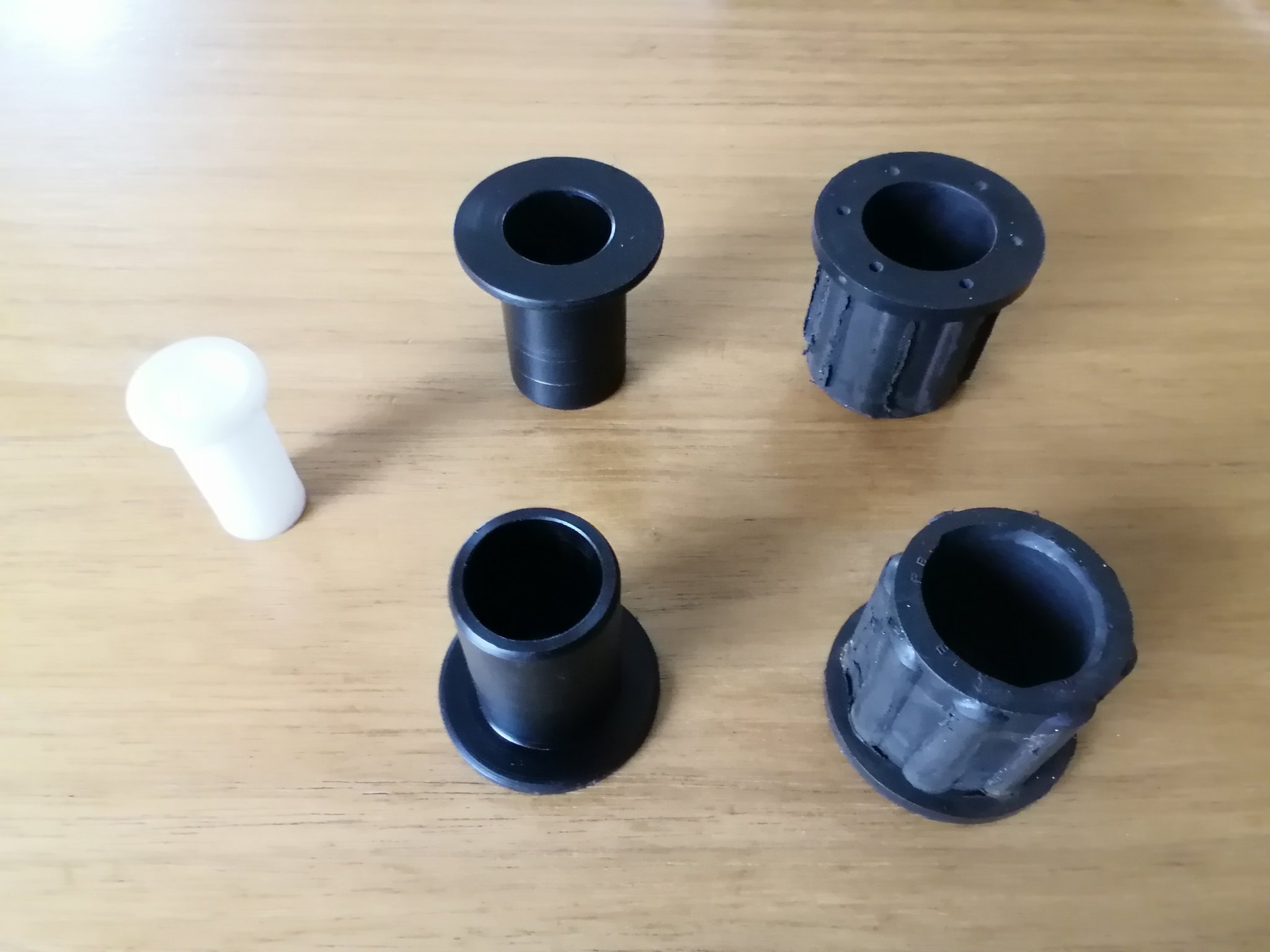

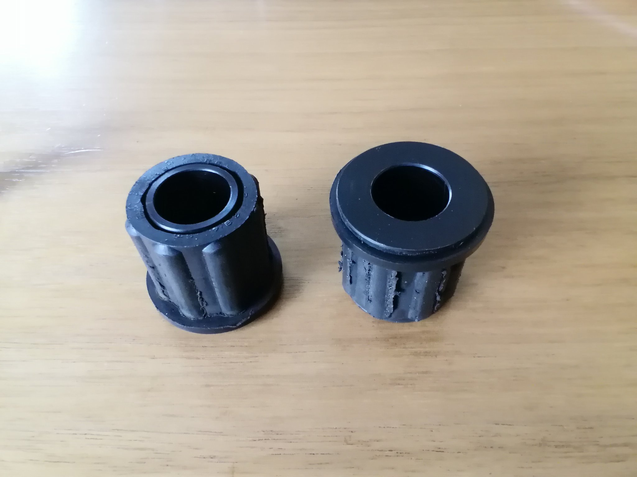

The steering shaft is guided in two rubber bushing. Not ideal from a friction point of view. @lugbolt suggested Delrin bushings. I believe the rubber is there for the purpose of vibration reduction at the steering wheel. So I increased the bore in the rubber and made Delrin inserts. I also made a tighter bushing for the throttle.
Put the panel assembly back and inserted the bushings and put in the steering wheel. The steering is absolutely precise now. One touch of the steering wheel and wheels react. I am looking forward to a test drive when everything is back together.

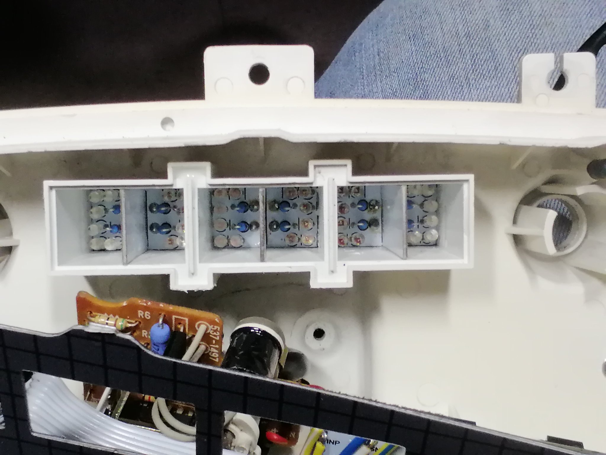

Instrument cluster indicators

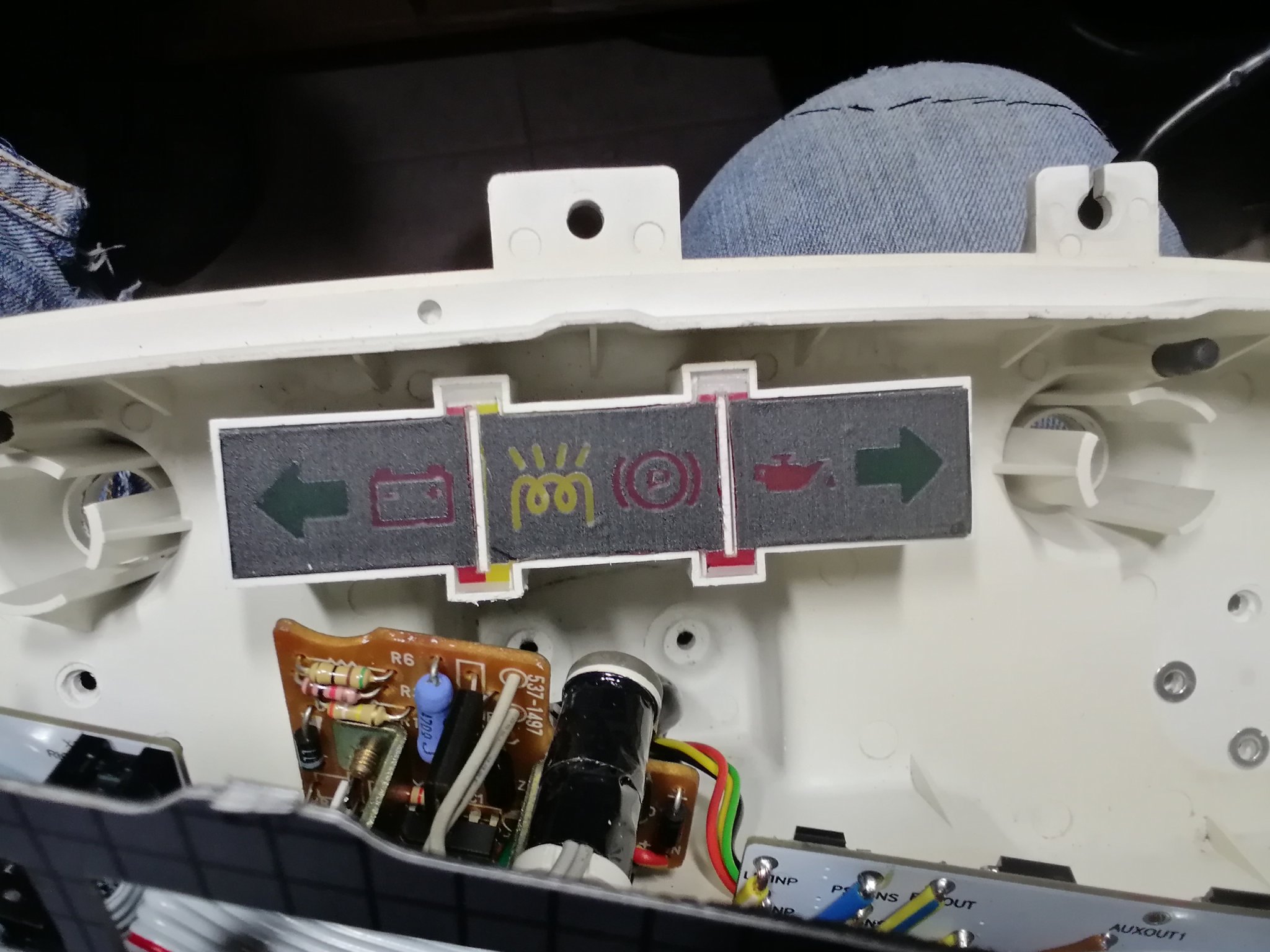

I had doubled up the indicators and replaced them with LEDs. Made a mistake in my calculations and had to replace them again. I have 3 LEDs in series now and two of those in parallel for each indicator. They are nice and bright now. The LEDs are on a small printed circuit board with another printed circuit board as a divider.
I also replaced the filter by a non Kubota G1900 style one where the symbol itself is lighting as opposed to the whole area lighting and the symbol being black. Looks better, I think.
The indicators automatically adjust the brightness to match the ambient light. Originally the lights were way too bright at nighttime.
I also changed the battery charge indicator. I was using the schematics from the dynamo version where the light is to ground. But my generator version has this light to +12V. Changed that, so the light is working now.
In order to accomodate the extra wires for the doubled indicators I had made my own rubber plugs.

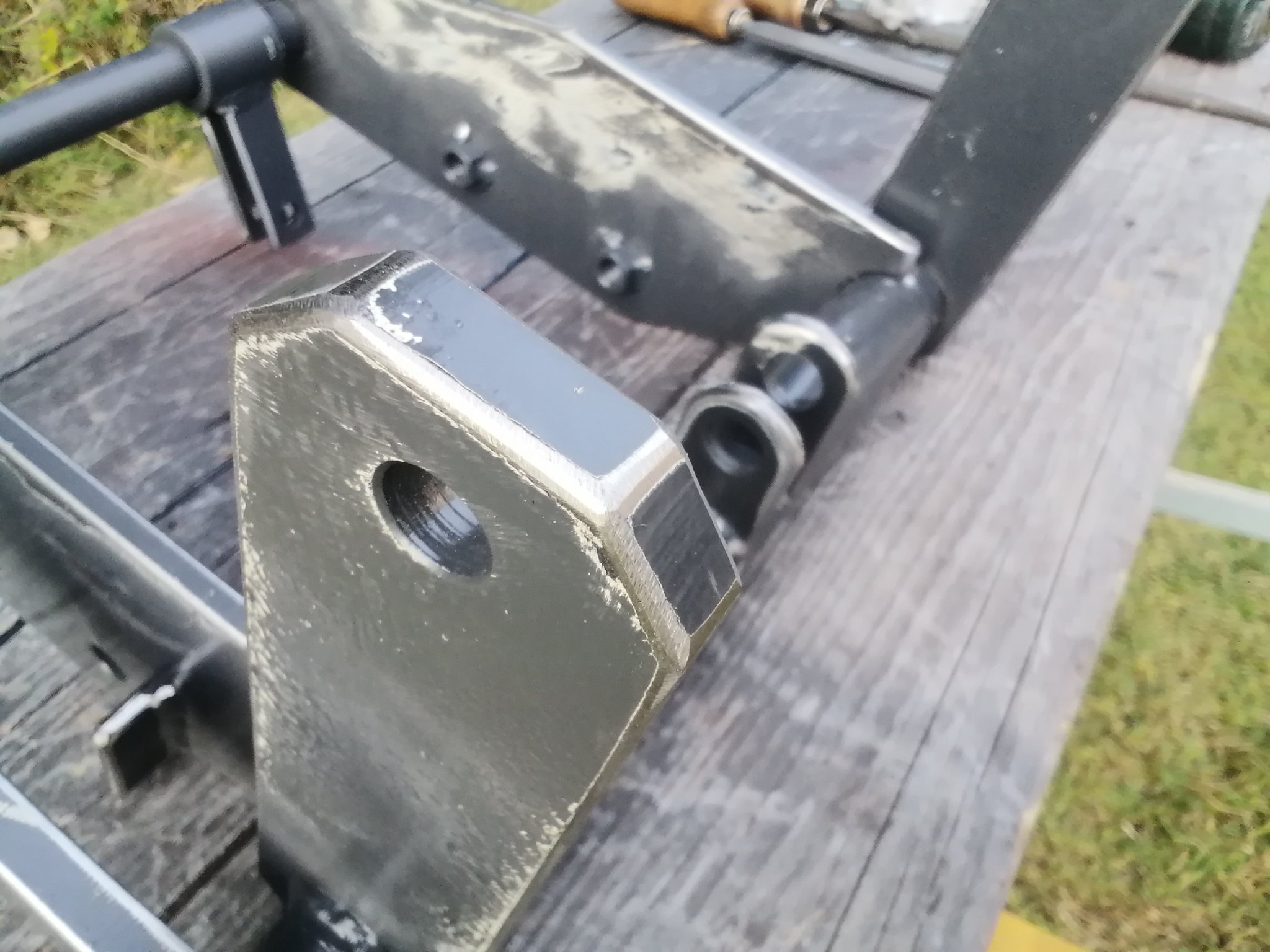

I had bought a three point hitch kit from a dealer in the US. It was new old stock but the packaging was poor and a lot of the paint was damaged in transport. Since there were a lot of sharp edges on the parts I removed all paint, rounded off the edges and sprayed it with two layers of epoxy primer and two layers of top coat.
Mounting it was easy.
Problem is the diverter valve for the three point hitch lift cylinder. The parts are still available but would add up to about $1000. So I used an off the shelf hydraulic valve and made a lever that sits in the original position and linkages that connect it to the valves.
Originally I only had the upper linkage, but it bent too much, the forces required to move the valve were too big. So I added a second linkage between the centre of the lever arm and the centre of the valve arm to take those forces. This works fine now.
I bought two new hoses for the two cylinders from the valve. Measured three times and still got it wrong 🤪 . They fit but not very well, so I will order new ones. At 4 quid a piece not a major expense.

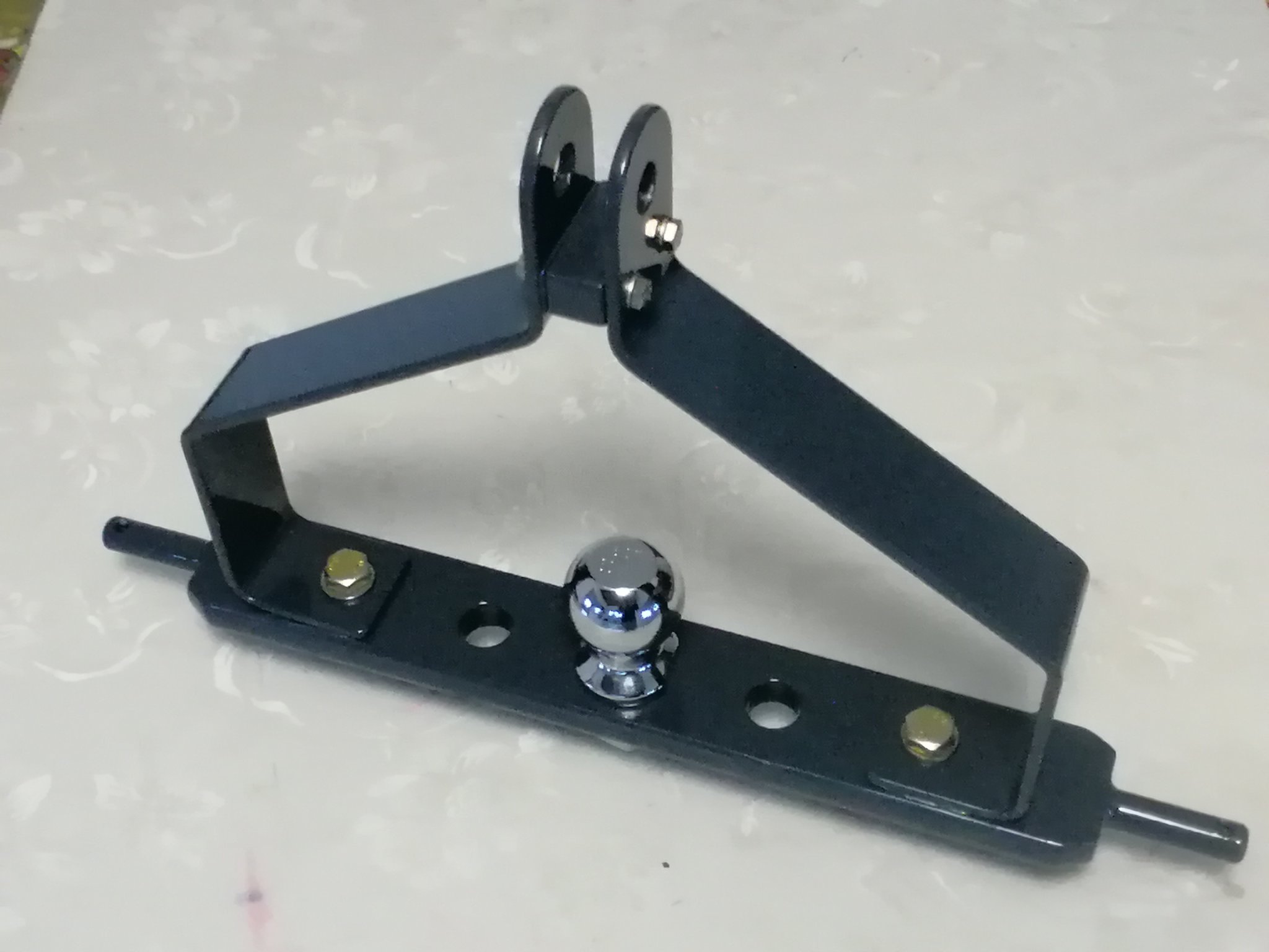

For making a trailer hitch I bought a narrow Cat. 1 drawbar and reduced the pin diameter to Cat.0 and also machined it thinner to take some weight off. Cat.0 components are very difficult to get in Europe. Even bolt on pins with 16mm I had to order in the US, could not find them elsewhere.
The arms to the upper linkage are flat bars bent with a spacer block in between them. I bolted everything together instead of welding so that I can modify or add things easier if required. Tried it on the three point hitch before painting.
