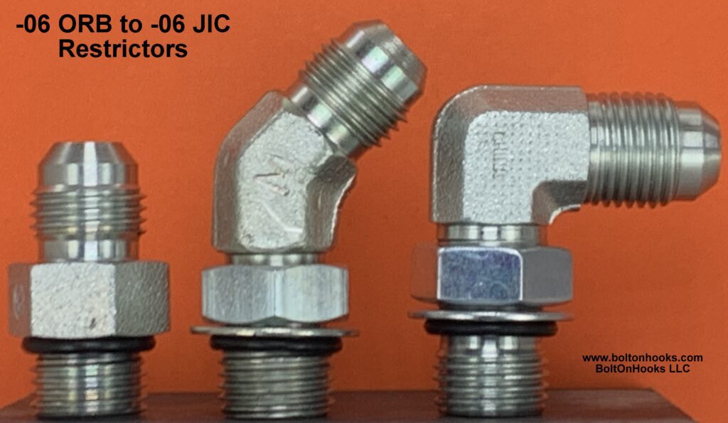

Massive overkill and expense. All you need is these hydraulic adapters.. No guessing, no adjustment, no confusion.

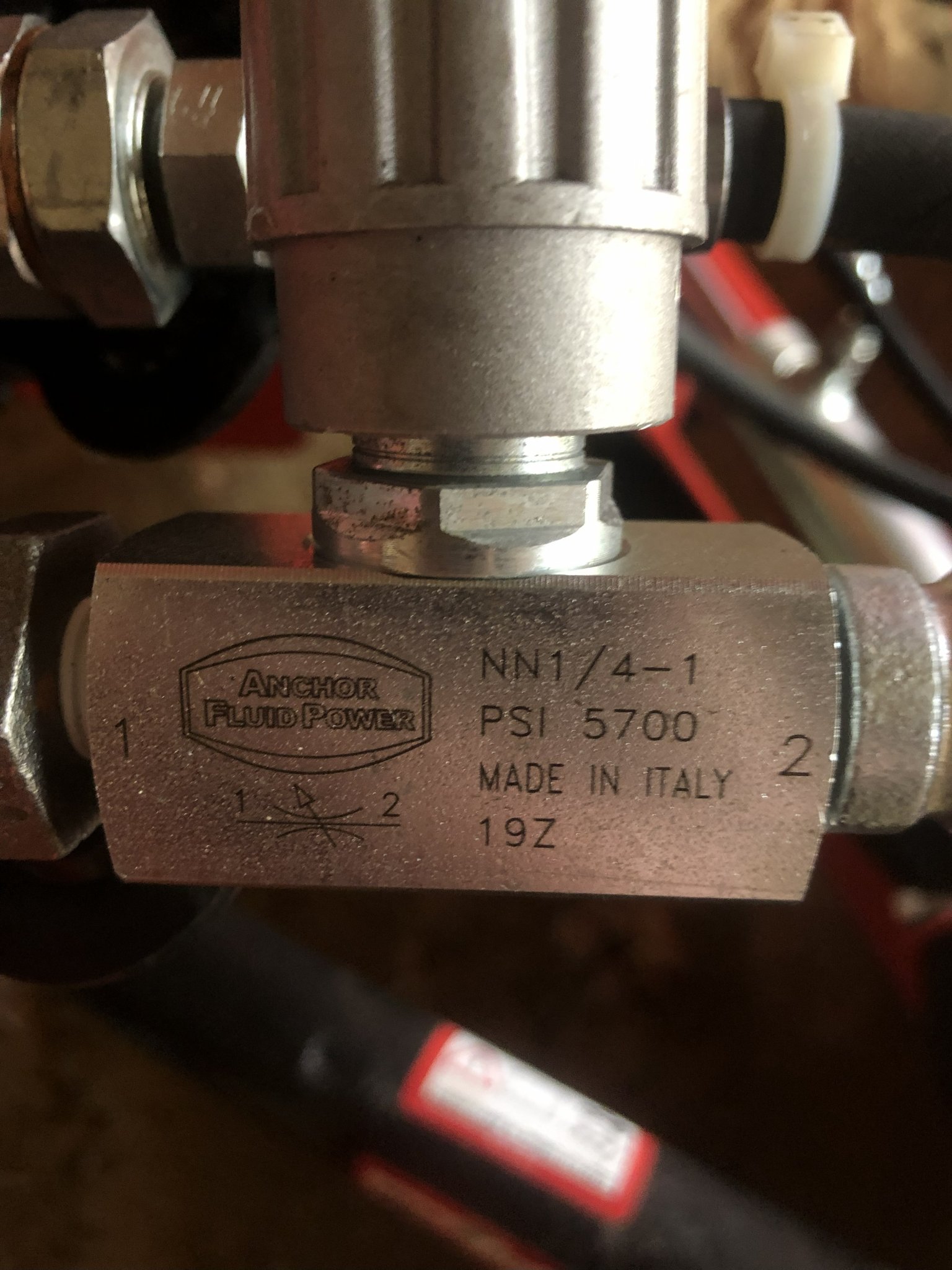

This what I have, it doesn't have a check valve so I'm assuming it restricts in both directions, which it does appear to do.
I have the end labeled 1 conected at the rear romote connector,. I don't know if this even matters being as there is no check valve.
11,943
6,787
That is an adjustable bi-directional flow control valve. It will work but is expensive overkill.
Question about these- For a grapple, or a snowplow, would I need one for each direction? Plow has 2 cylinders, if that matters. Also, I would assume I would need for both implements? Thank you much!
11,943
6,787
For fixed orifice restrictors you only need one total.
