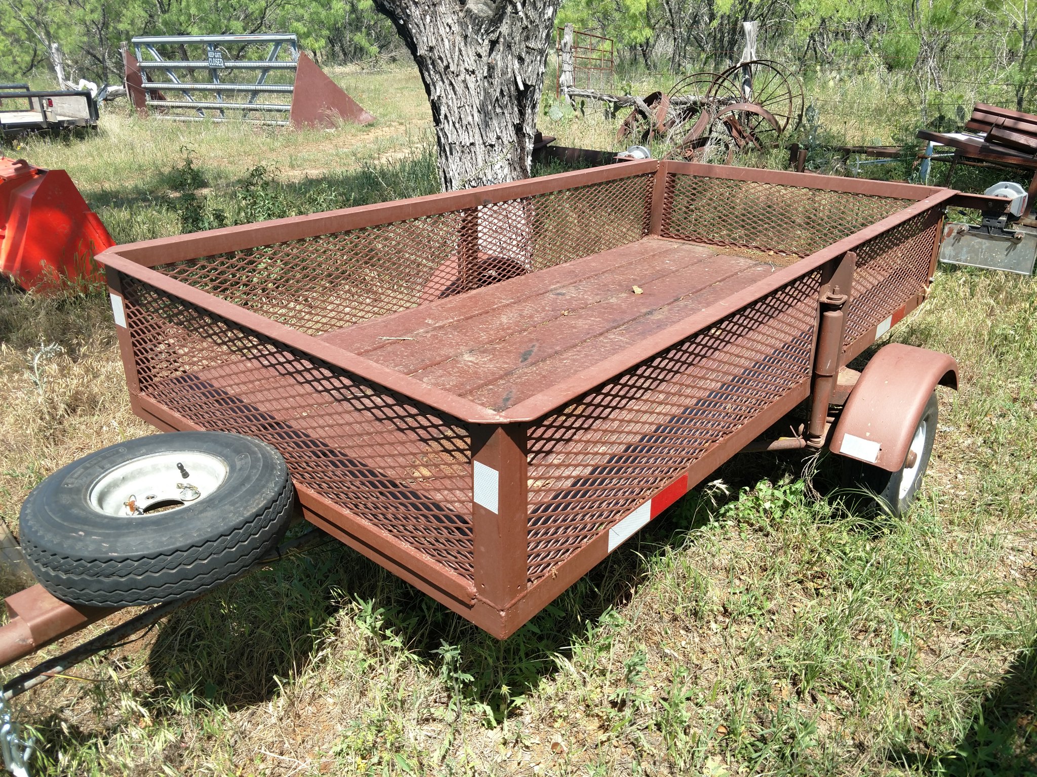

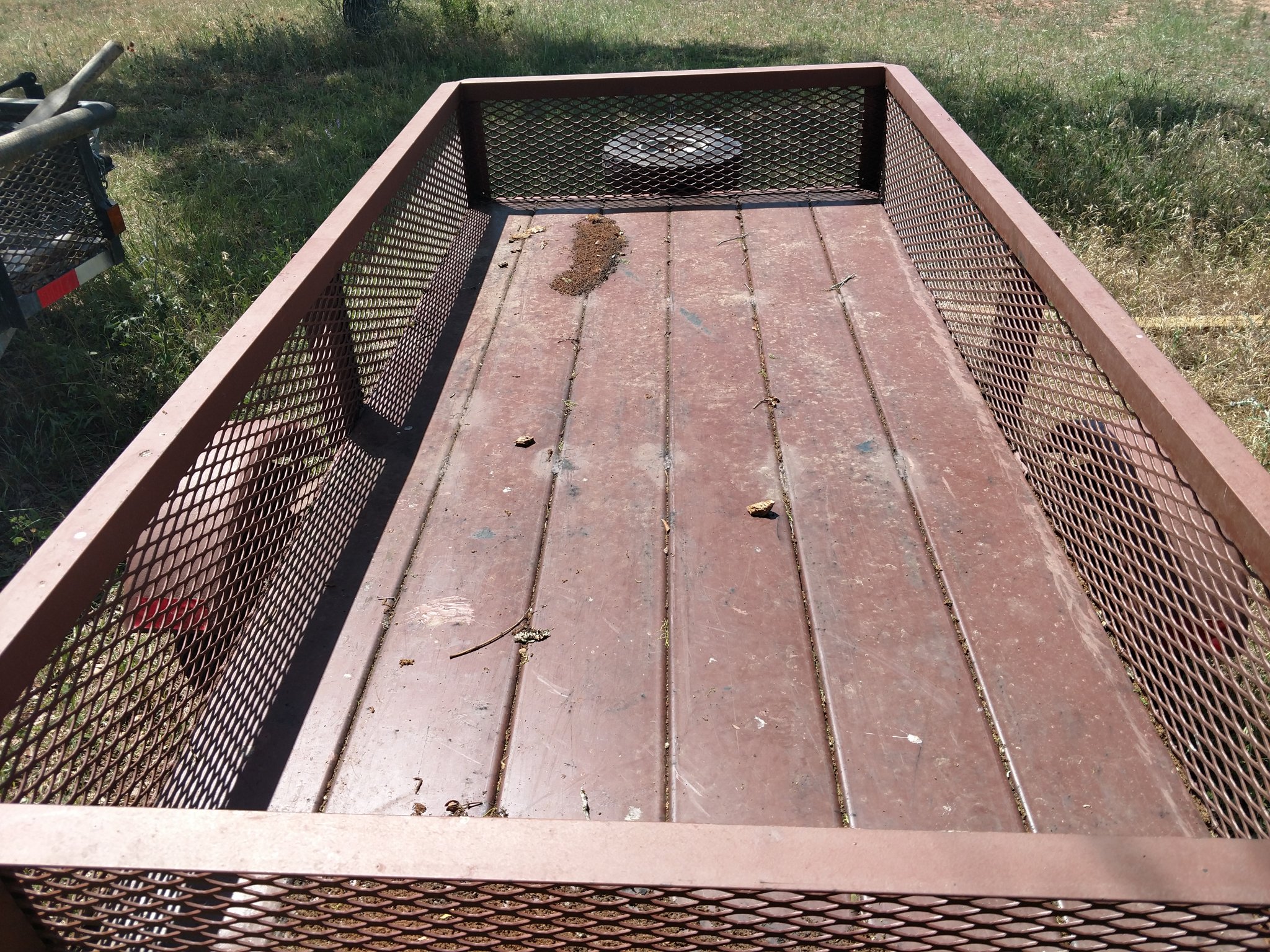

Here are some pics of a little utility trailer which has a 2” angle-iron underdeck...but originally had treated wood floor and sides which had rotted. I used the same technique as on my other trailers to replace the floor with C-purlins and then added angle-iron walls with expanded-metal inserts tacked into them. I used a roller to spread/smear Rustoleum Red Oxide primer on the sidewalls only...the purlins were left with the original primer as sold to me. It’s been durable, as you can see, as I’ve hauled old scrap metal off to the salvage yard with this trailer several times. This was done last year and it sits outside under trees as you can see by the oak-flowers which have fallen into the bed. I also modified it to have a dropping-tailgate. Hope this helps.

They are not slippery, even when wet, is my experience. But they DO allow things to slide easier than dry wood. (Wet wood is also very slippery.)
But so what? Don’t you tie things down? (Wink)
Here are some pics of a little utility trailer which has a 2” angle-iron underdeck...but originally had treated wood floor and sides which had rotted. I used the same technique as on my other trailers to replace the floor with purlins and then added angle-iron walls with expanded-metal inserts tacked into them. I used a roller to spread/smear Rustoleum Red Oxide primer on the sidewalls only...the purlins were left with the original primer as sold to me. It’s been durable, as you can see, as I’ve hauled old scrap metal off to the salvage yard with this trailer several times. This was done last year and it sits outside under trees as you can see by the oak-flowers which have fallen into the bed. I also modified it to have a dropping-tailgate. Hope this helps.
never knew this was an option. If there is a next time I might go this way. Thanks for the reply
