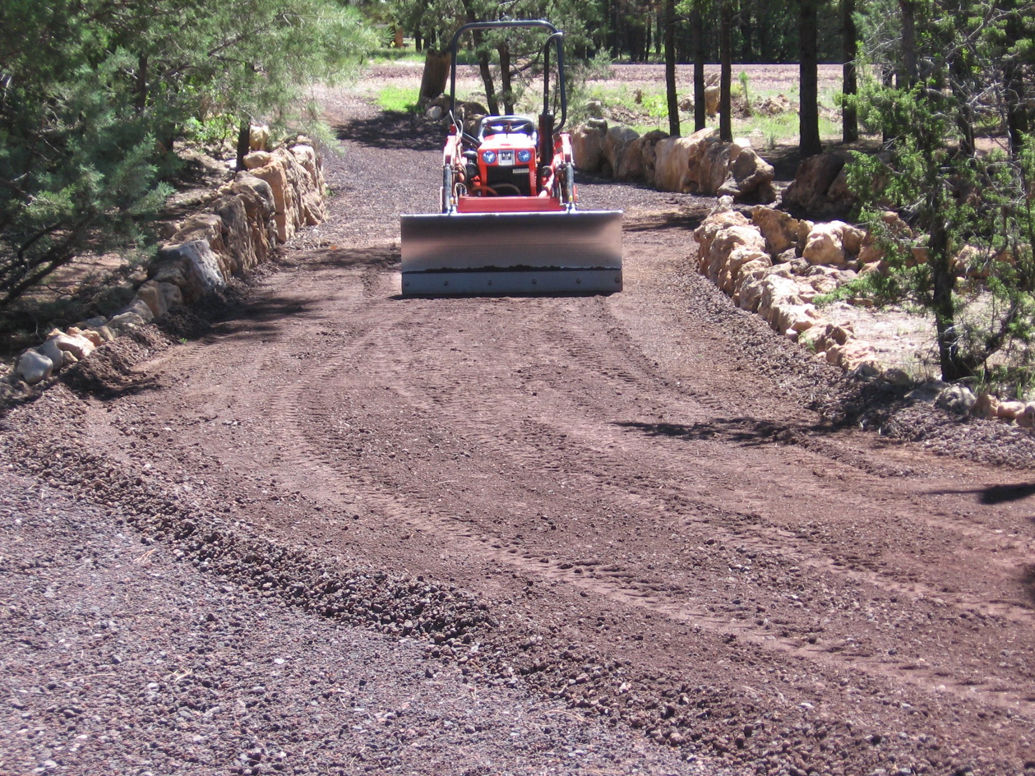

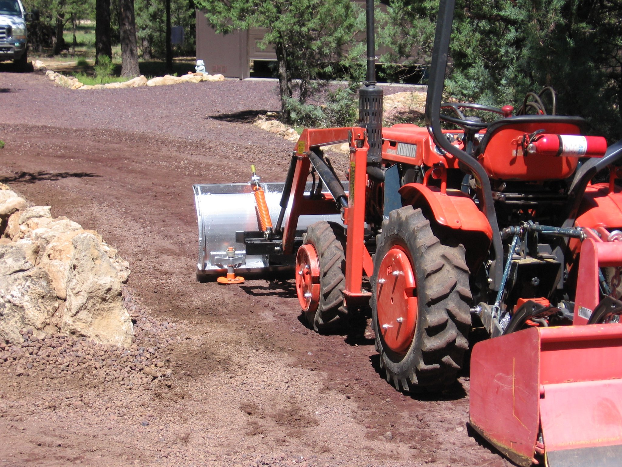

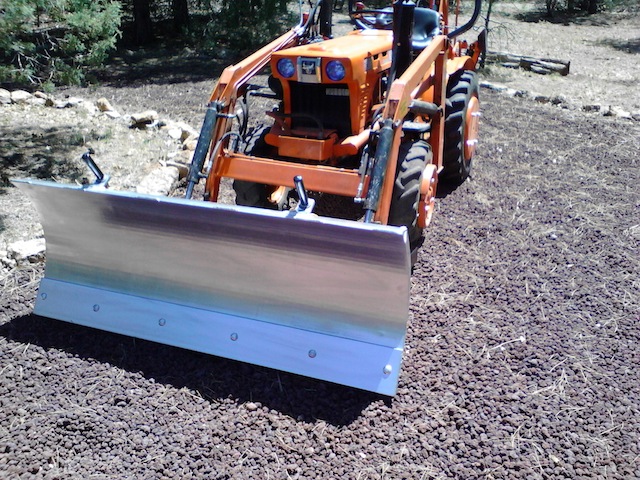

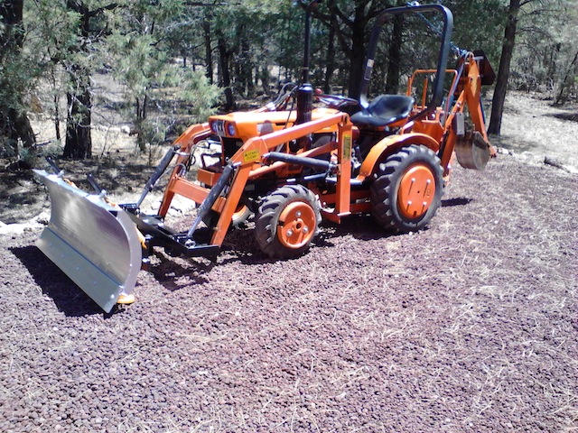

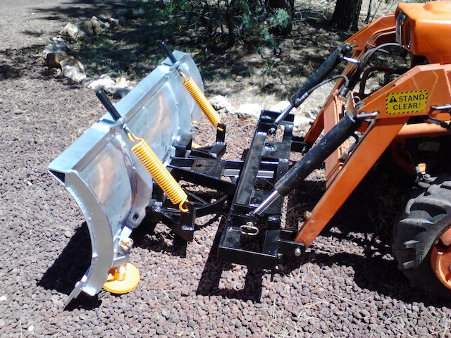

That blade is really stout- I think it began life as a full size truck mounted snow blade,

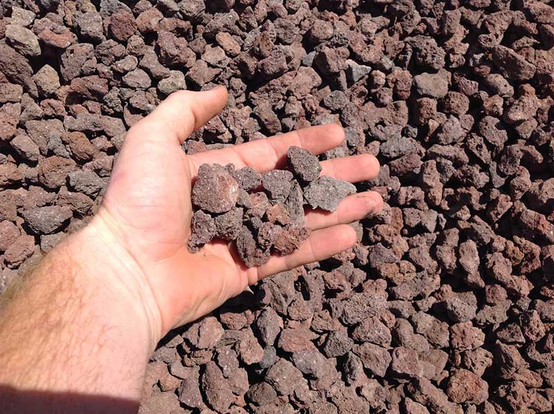

Plus my driveway is volcanic cinders over hard packed dirt.
IMG_20140504_124614.jpg IMG_20140504_124624.jpg IMG_20140504_124634.jpg volcanic-cinder.jpg

I never considered lava rock as a driveway.
It is fairly common in northern AZ, it locks together quite well, gives excellent traction in snow & ice, and it is cheap.
Last load of 3/4" minus I bought weighed 3.2 tons, cost me $19, plus my fuel. (about 150 mi round trip)

That Red Lava Rock, I have it in some of my landscape beds. I figure there's about 8 yards, that's been in place for 20+ years. I can't stand the stuff. When my new BX23S arrives, that stuff is going away..somewhere..I do not care.
I've read and seen where people use it for their driveways, although I'm not going to be adding to mine.
All my driveway coming into the property and near the house is a mix of crushed rock. A 2" crushed base, then 5/8" minus packed in to build the top. It's PACKED like what OP is dealing with. I'm always picking up the bigger rocks by hand, and tossing them to the side.

Cinders are a common gravel road surfacing in Central Oregon, on the east side of the Cascades. Most of it red. They are also used for sanding gravel for improving traction hard surfaces roadways on snow and ice by many of the transportation entities in Oregon.

They are used hre in CA for icy days as well.. crushed lava rock instead of salt. Not quite powder, not quite rock…. I think pea gravel will be better though. With the tufftrack, I won’t have much migration, either.

It would seem that a pair of "Edge Tamers" could work well in this front blade situation
