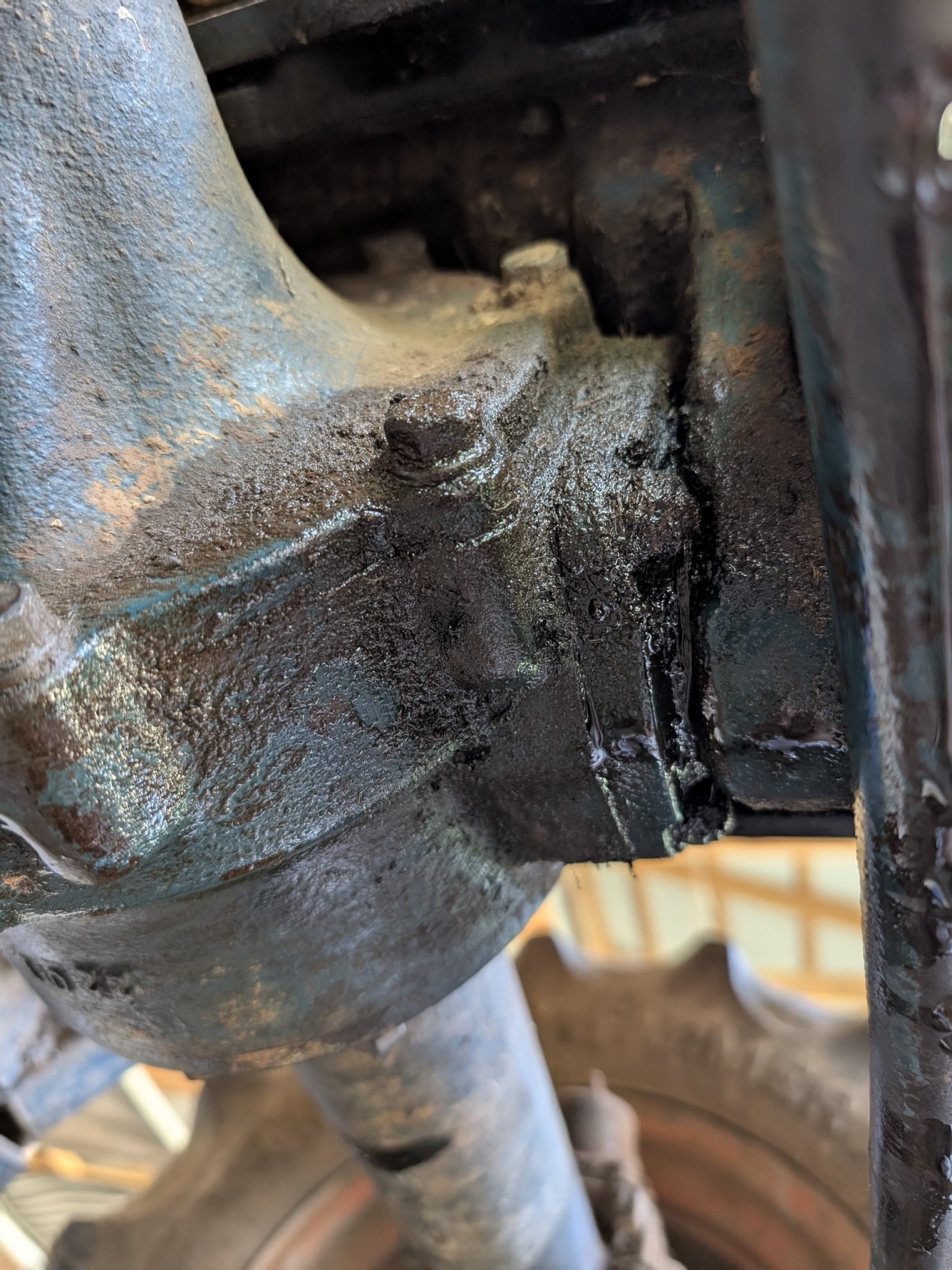

my front axle (4wd) is leaking fluid at the rear where is supported to pivot, I'm guessing rear seal bad. searched around here, havent located any threads on removing the front assembly. Looks to me steering link, prop shaft spring pin and just those 6 bolts on front of axle? doesnt seem to be enough room to pull front diff forward enough to drop down. any ideas would help. thanks

Unless you are actually LOSING a measurable amount of front axle fluid…I’d leave it alone. (and that wetness might actually only be evidence it’s been greased occasionally.)
when i did a full fluid change last week, only a cup came out of the front diff. I was like uh-oh.. when i refilled, it's pouring back out pretty quick. Definitely needs attention. I wiped it down before the pic.

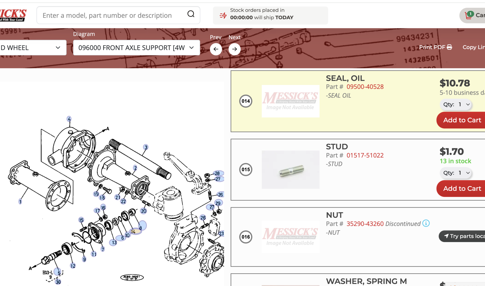

the seal i believe i need is 09500-40528, aka s.50310 with google search. I looked on messicks for the part number.

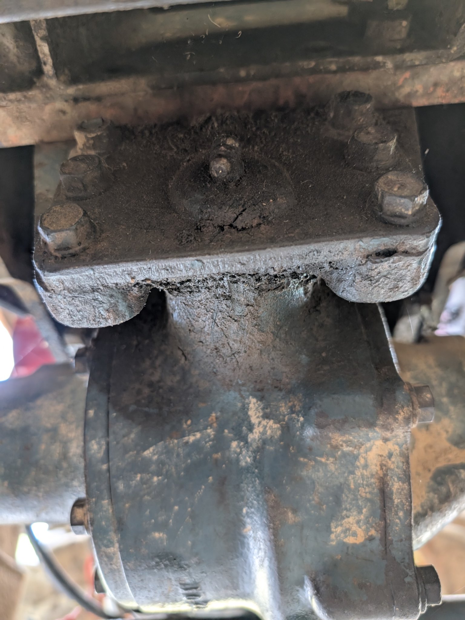

one thing im wondering about is if the loader frame will be an issue. it's barely 1/4" below the prop shaft, hopefully i don't have to remove it. I'll look for the manual on the site stated above.

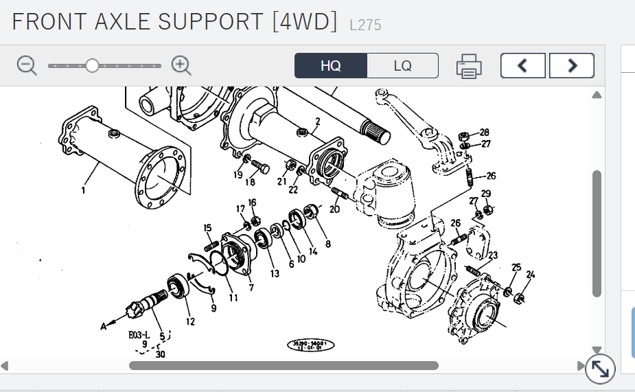

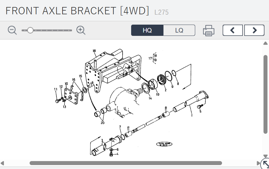

6-10-14 are all seals.
There are the same axle in both pictures, just different views.

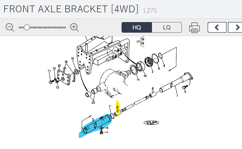

You don't need to move or remove the propeller shaft.
Just remove the bolt slide the shield back (blue) then pull the roll pin (yellow) and slide the coupler back.
