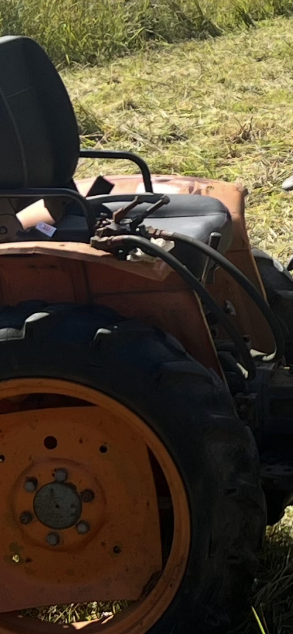

It is my understanding that I can’t just plug this off at the hydraulic cover. Is that correct?
I want to remove it because it’s leaking and currently serves no purpose. I’m likely to replace it to operate a hydraulic top link and side link for the three-point hitch. It was for a plow.
so for now, should I just get two quick connects and plug it into itself?

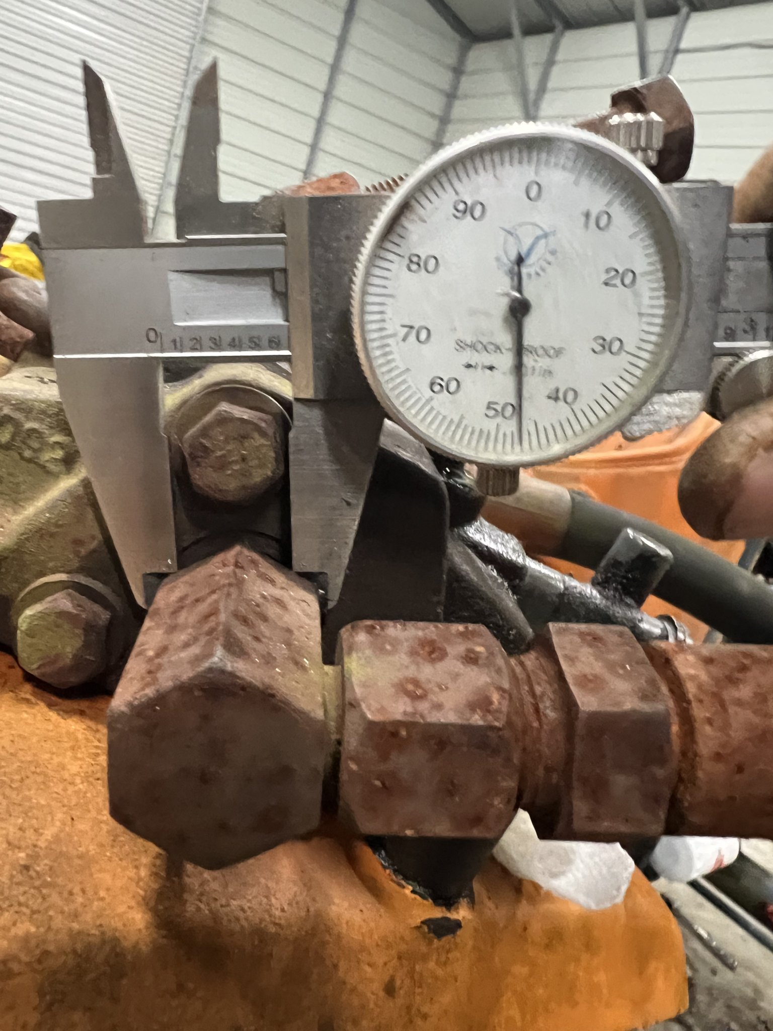

I took some measurements, not sure what the thread size is.
View attachment 161871 View attachment 161872
Yes, you have to loop the hoses together. The two ports on the tractof are likely BSPP.
6,723
2,279
See this thread for some examples of the block you have and how it diverts the flow. You can probably just read the first post to see what you need to understand.
You can remove the two hoses and valve and replace that with one hose (or tube) loop between the two ports on the block cover.
You can machine a new block cover if you connect the two holes together.
You can connect the two existing hoses together.
You CANNOT just plug the two holes in the existing cover!
