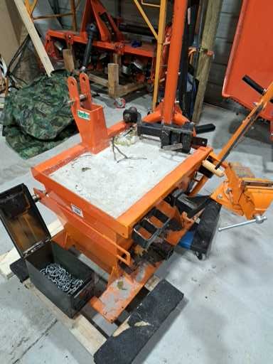

I modified my ballast box to a kind of a "carry all", and loaded it with a flywheel, brake rotors and other assorted steel parts, then used concrete to fill it.
I have no idea what it weighs, but i'm guessing it's at the 900 lbs. area.
However this has become my most used and versatile form of ballast.
It is on 95% of the time.

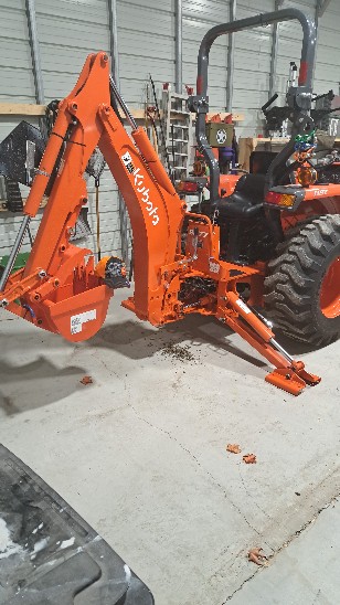

I did something similar when MX was first new…I had been waiting for the BH to come in and finally took delivery of the tractor without it and we split the order since there was a wait period to get the BH (about 6 months a few yrs ago) since waiting dealer asked me to wait with filling tires since they would be taking off to put the sub frame on for th backho when it came in…well the tractor was helpless if using the loader without filled tires or anything. I had my hands full just hoisting the brush cutter off the trailer. Same thing…about same time I dropped the loader, the vinyl seat was wrinkled…after that I asked for some wheel weights to hold me over until the BH came and I could get the tires filled. I ended up keeping the wheel weights on with the filled tires. Makes a world of difference for light loader use. I still use ballast off the back if I am lifting anything heavy. Happy holidays. 🥃
