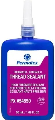

If it leaks you have issues other than the sealant.
This is what I use in lieu of tape. You can find the same thing with a Loctite logo.

Another vote for Aviation Permatex. I have used it for years on any fuel or oil pipe thread fitting.
