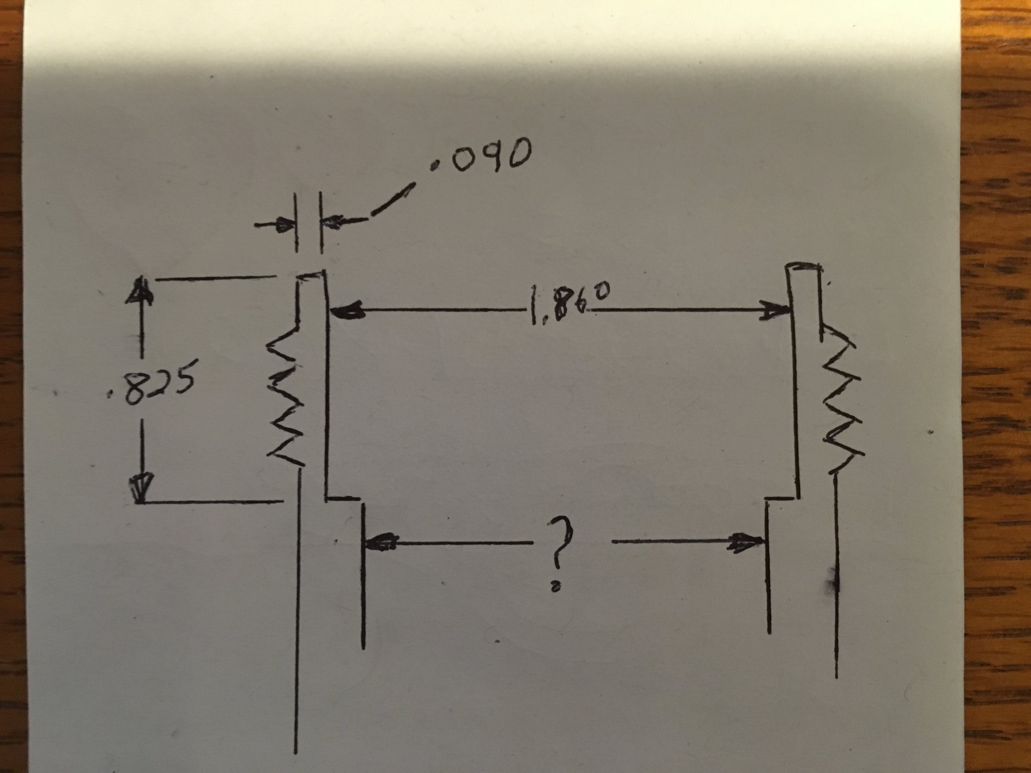

Not sure how much help this may be. I used a dial calipers and got these measurements the best I could in thousandths of a inch. I was not able to measure the inside step diameter that is .825 below the top seating edge for the cap. If I had to guesstimate the step, perhaps .100. I also do not know if there is an addition step in the filler tube before opening up to the tank. Note: not drawn to scale

The BX "Zell Cold Brew filter " will not fit. He needs a filter that is less than 2 inches in diameter.
