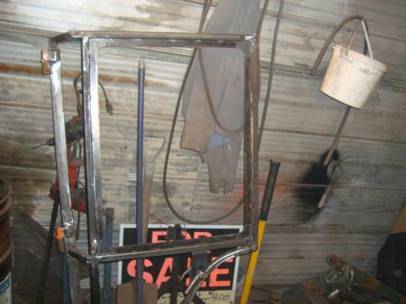

Hey Jerry, Thanks for the compliments. I don't have a metal brake , all I do is score the piece on the backside with a cutting wheel on an angle grinder. It creates a weak point where you want your bend. I use fairly thick material but you can use this method with thinner metal as well , you just have to be carefull not to score it too deeply. And I will be busy just getting this done before snow:D

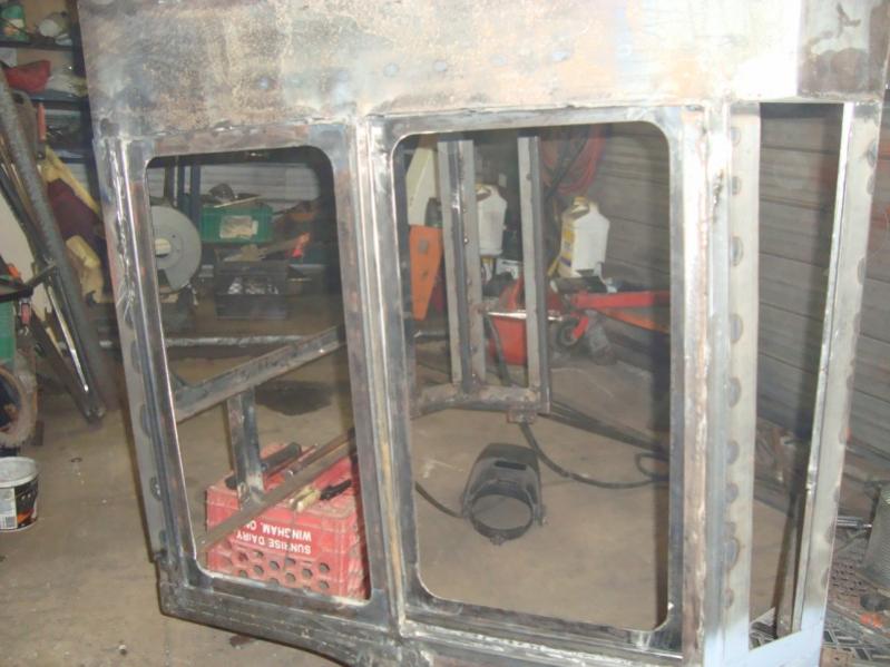

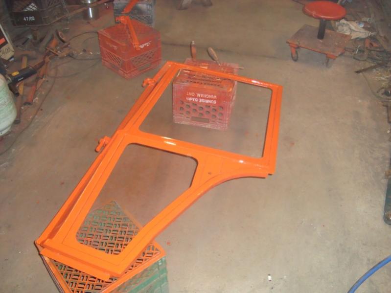

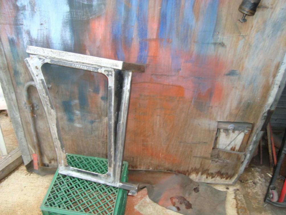

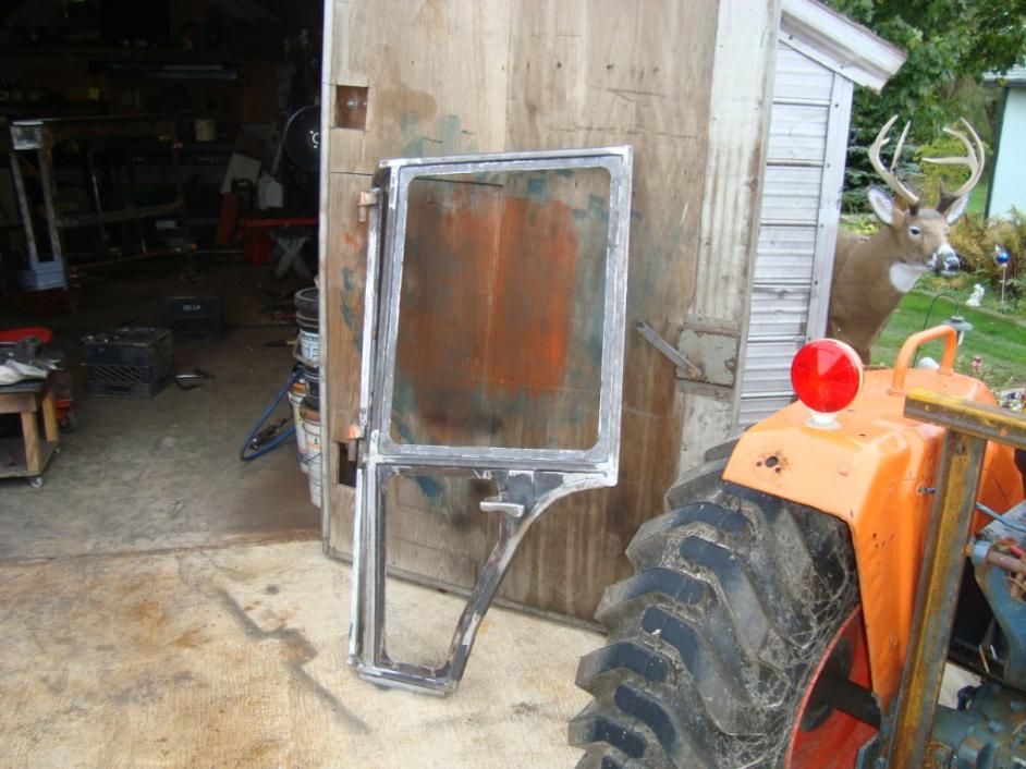

On my b7200 I raised the back of the engine cover up 2 inches and had that open up right into the cab. It never fogged up even in rain. I am going to do the same with the b8200. We will see if you still want to trade when you see this thing finished. I think it is going to look huge on this tractor. And it is going to be heavy. Any way I got a little more done today. I installed the sliding window, and got the window frame in the stationary part of the slider and got one widow frame done on the door. Boy it takes me a long time to do stuff . But I am still enjoying myself.:D

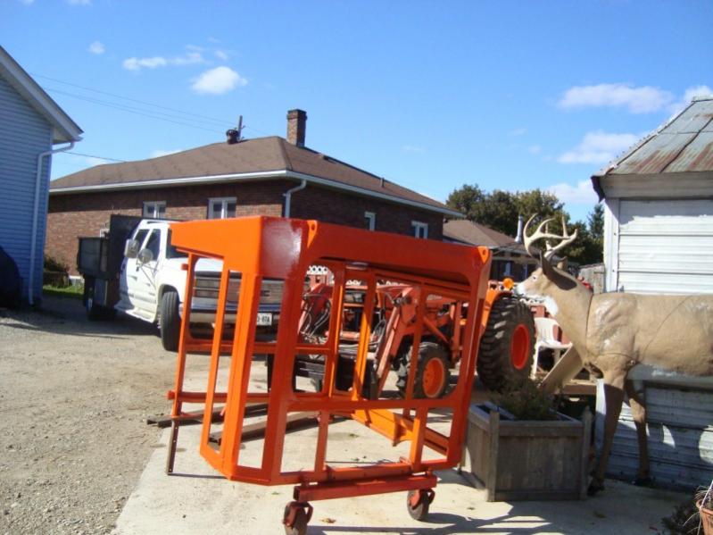

Wow, You have a deer in your house~!!!
Nice looking door... I wish I had a window made onto my door~:eek:
It would been nice to go through the Tim Horton's drive through~:D
Happy Thanksgiving.
Oh~ I finished modifying snow blade...
I'll post it as soon as I take the picture.
Joe.
dusty-t
Feb 17, 2009
974
Mountforest Ontario

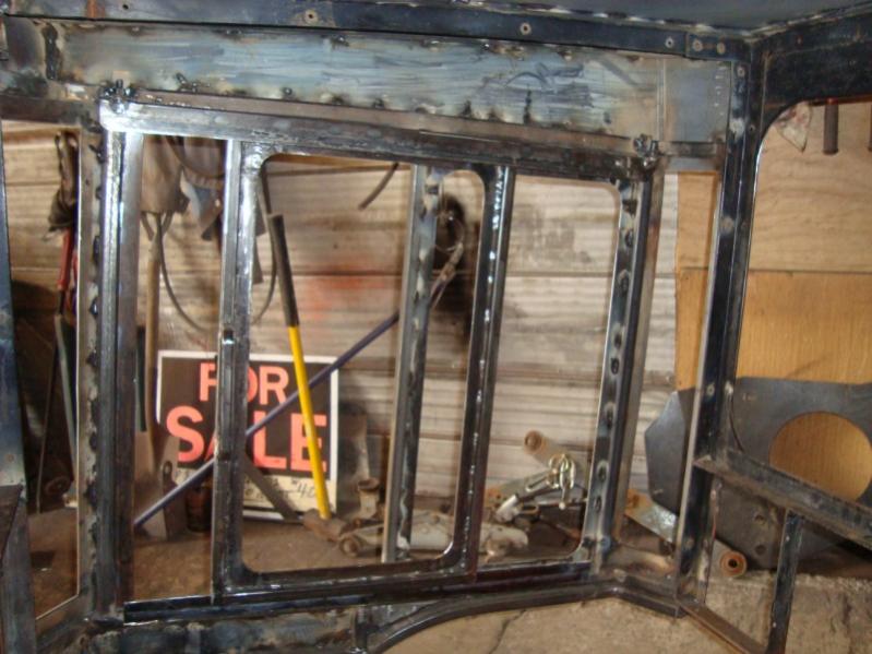

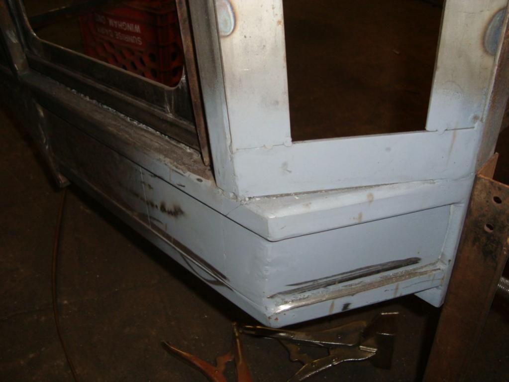

Yup I have a deer at my house. It is a hunting decoy from TSC .My wife wanted a lawn ornament. She got one. My sliding window is on the wrong side for tim hortons. Is there a law against backing through the drive through. OK I made a couple of mistakes on the cab that really stand out. Both of them where the top and bottom separates On the right hand side there is an angle iron facing up and out as part of the bottom ,and a square tube sits in it as part of the top. It means that water and dirt will sit in there. To big a hassle to change it. On the other side (door side) where the front top attaches to the bottom there is an angle iron that joins top and bottom that sticks down 4 inches farther than the rest of the top of the cab. Sooo!!! the top of the cab when separated will sit uneven, making it rocky and a pain in the behind to move. This I have fixed. P.S Joe, I am really looking forward to seeing that blade.

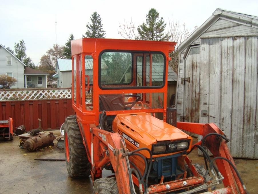

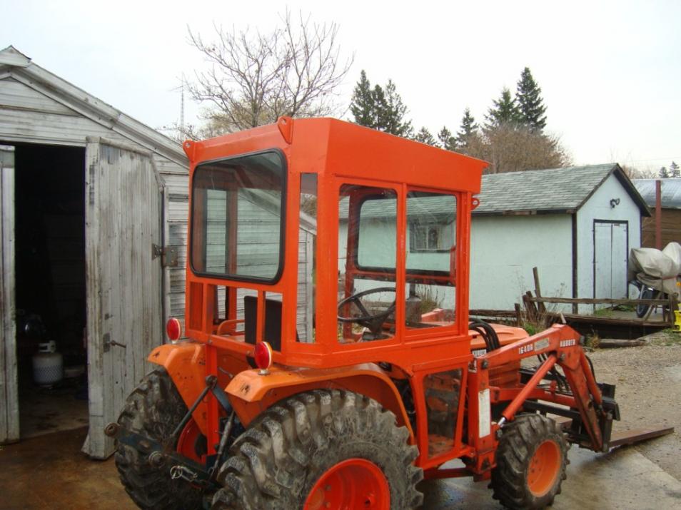

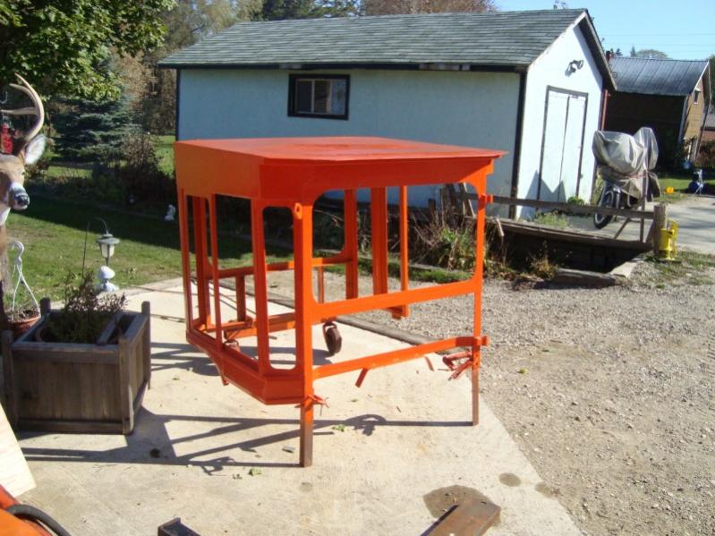

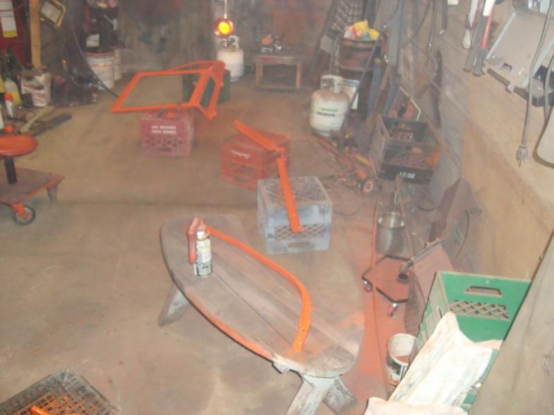

Thanks Jerry, I'm workin away. Still lots to do but its getting paint. A few pics. Roof is nasty I put gravel guard on it and it didn't like the orange going on top. I may have to strip it.My shop is a big time mess. Well better get back to it.:)

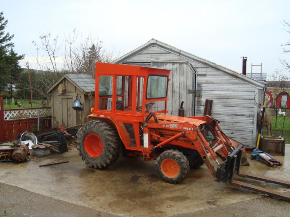

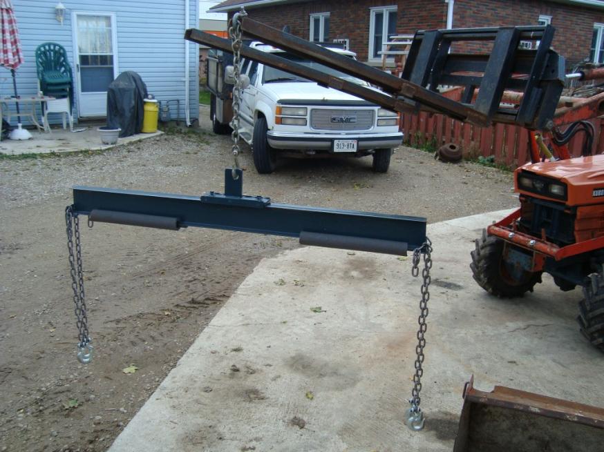

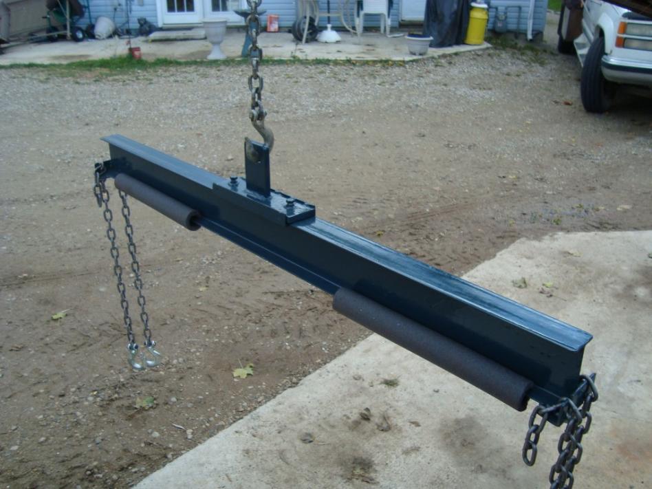

Genuwine dusty-t cab lifter for a genuwine dusty-t cab:D . The center can slide to level the load. A bolt at each end holds it in place. The lifter is made of 2 1/2 x 4 I beam and 1/2 x 2 1/2 flat bar. 1/8 x 1 angle welded top and side to the flatbar. I drilled 3/8 hole in the angle so I could weld to the sides of the flat bar . To hold the chains I welded 1 1/2 angle with slots cut in it so you can adjust the chains to the bottom ends of the I beam. I don't think you would want to lift a ton with it but it will handle anything my tractor will lift.:)

Dusty I was wandering how your cab was coming alone? Glad to see more pictures looks good like your beam also. Are you going to lift the cab in your garage or another tractor? Post a picture when you get it on.
dusty-t
Feb 17, 2009
974
Mountforest Ontario

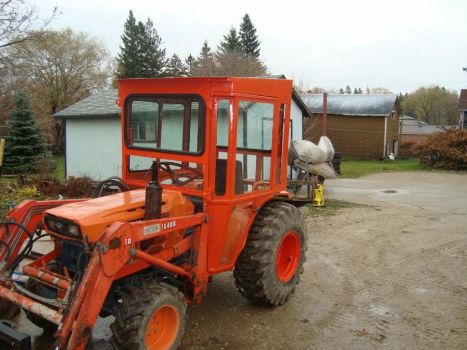

Thank's handyman. The cab is done and I am just installing the windows which may take some time. I have to get my son to help me with the front and rear windows because they are glass. I tried it by myself and I don't have enough hands or strength. The rest of the windows are going to be lexan, so those are just going to be siliconed in and then a few keepers on bolts make sure they stay in. Most of the windows are built to take glass when I can afford it. And I will be putting the cab on in the lean to behind the shop it has rafters high enough and the shop doesn't. I will probably leave a pulley and rope up there and may even build a winch this winter.:D

Dusty congrads looks good and know you will really enjoy it in your neck of the woods when temp starts droping:).handyman
