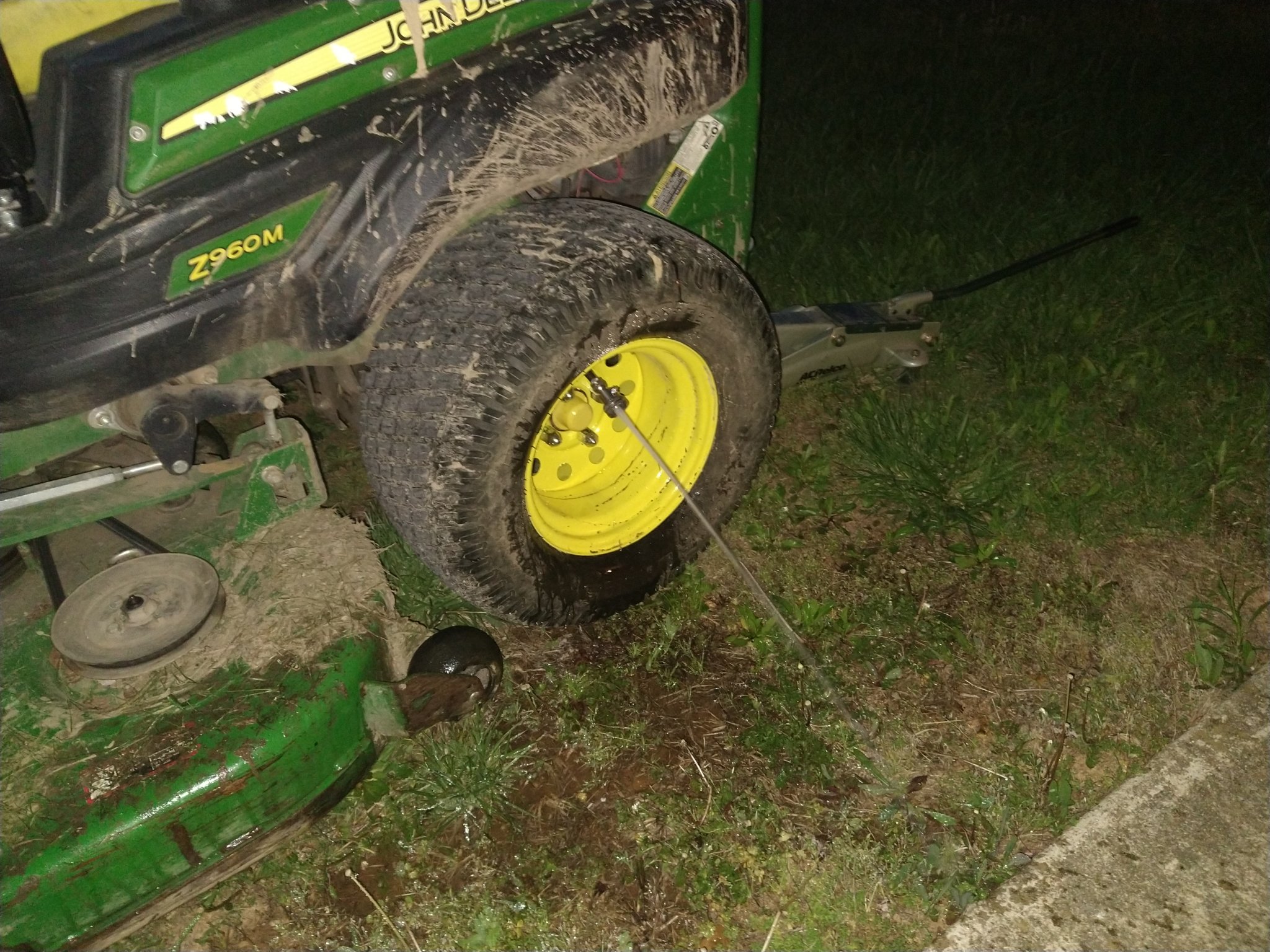

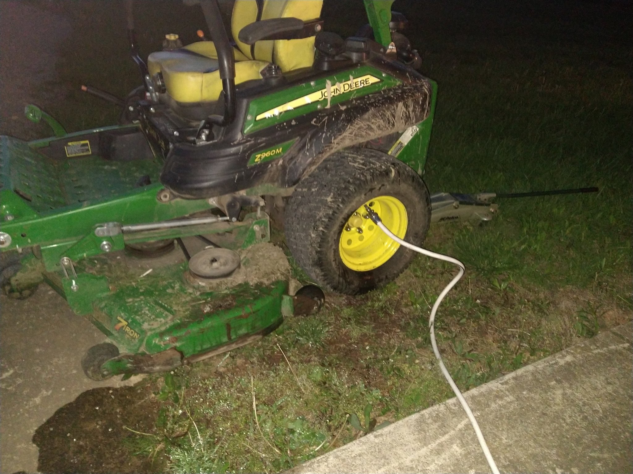

Other than the $15 adapter ... Just need a garden hose . . . https://www.tractorsupply.com/tsc/product/slime-air-water-adapter-kit-with-bleeder-valve
Rotate to the desired level of fill ... And let excess out ...!
OP is looking at about 58 gallons ...

Not sure when, or where you got it for a buck ... I'm seeing $5-$6 a gallon at the truck stops now ... Even bulk 55 gallon drum is $130, plus shipping ...

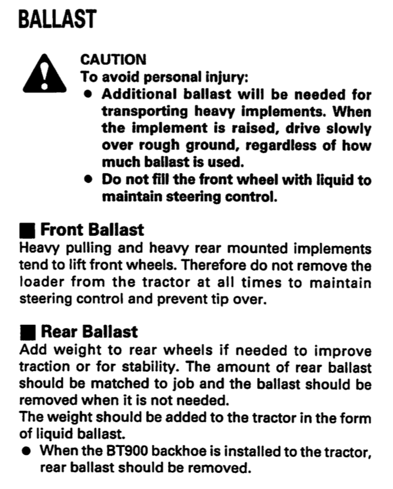

This is a timely subject, since I have the backhoe off my L35. Kubota recommends tire ballast for traction or stability, but not with the backhoe mounted. As if adding and removing ballast is a trivial pursuit.
The front is very heavy and the loader can't be removed. Even with the grapple weight sitting on the floor, the rear tires are noticeably light. Tomorrow I need to mount the rear blade on the 3 ph. It's a cat 2 convertible, so it's pretty heavy. I'll have to turn the lift pins around to fit it. I think it'll work fine as a counterweight with the loader, but It'll be interesting to see how it pulls when I take that weight off to grade with it.
