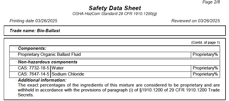

I did notice that the SDS sheet that they provide on their site lists the contents as: 30-70% organic based components and the remainder is water (so 70-30% water). I would expect that Rim Guard is very similar.
@jyoutz @Elliott in GA
Very different. Rim Guard is approved for animal feed use and does not contain sodium chloride.
