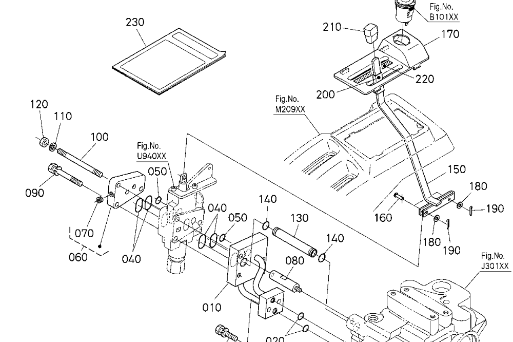

The factory remotes are pricey but very nicely integrated. About $700 for the first remote and another $500-600 for the second depending on whether you want float or not.. Parts diagram shown below.

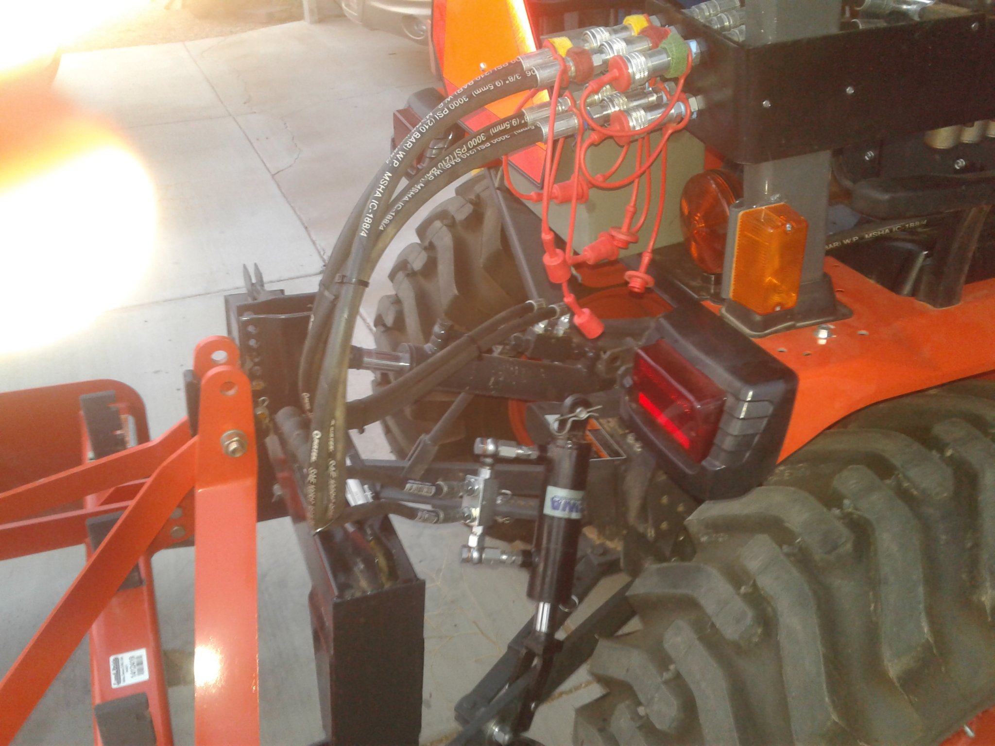

I added 3 rear remotes via a kit supplied by Fitrite. Brian walked this hydraulic newbie through the install. In retrospect it was really easy.

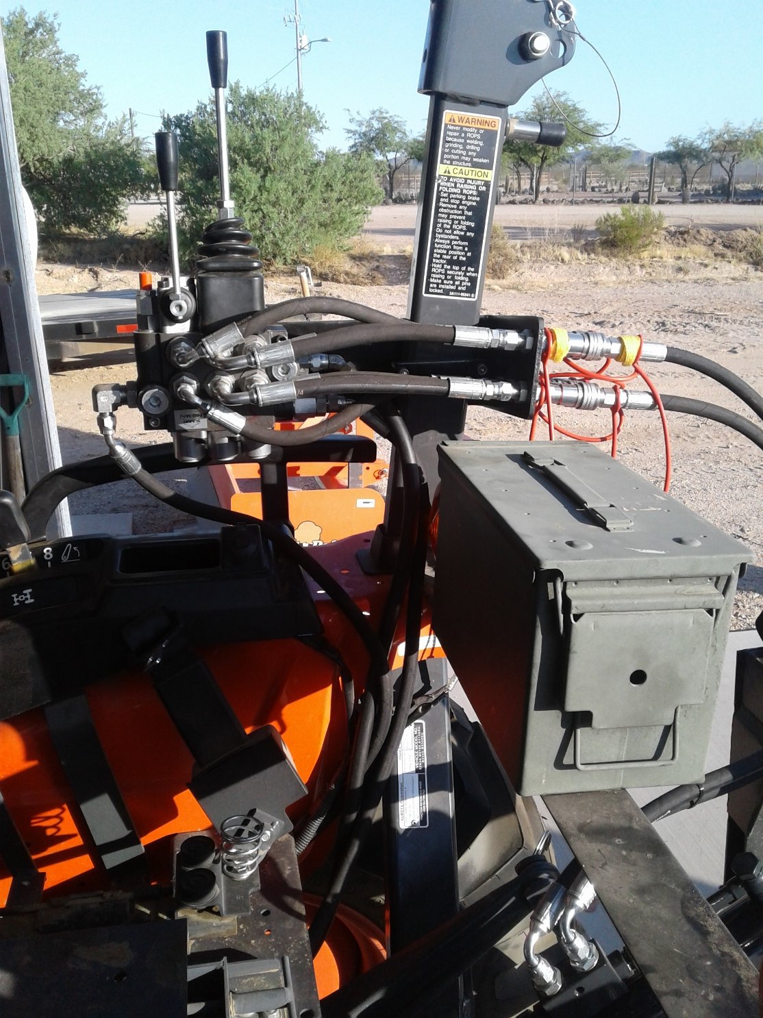

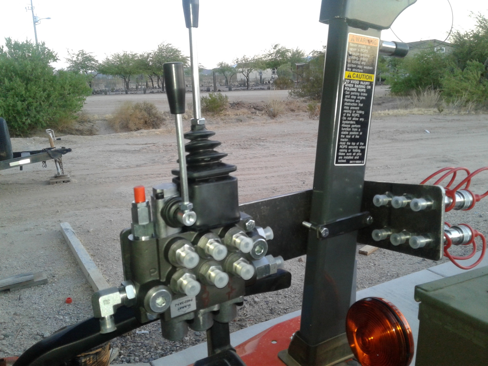

I I didn't want to wait so I did my own. I did three so 2 for the top & tilt,and 1 for a grapple for the front

joearizona Nice setup . Great way to use a loader joy stick. I like the tool box too. I had one on my Agco for years. The MX-6000 will probably get one when the current plastic one gives out.

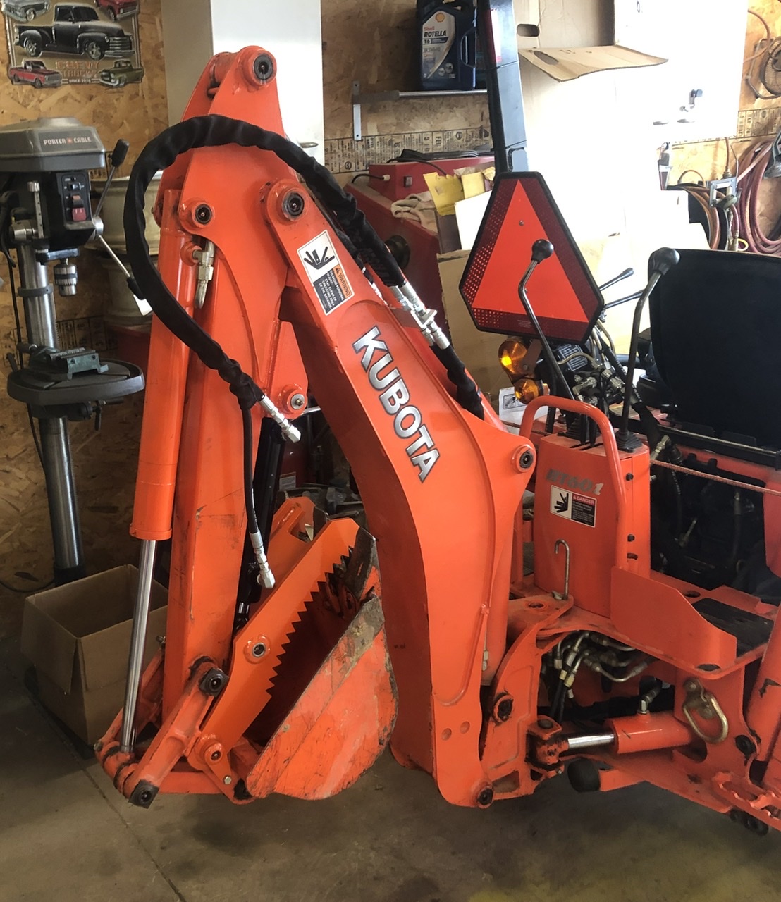

Homemade setup on my BX24. Plugs into the backhoe hookups so I can use them to control my thumb.

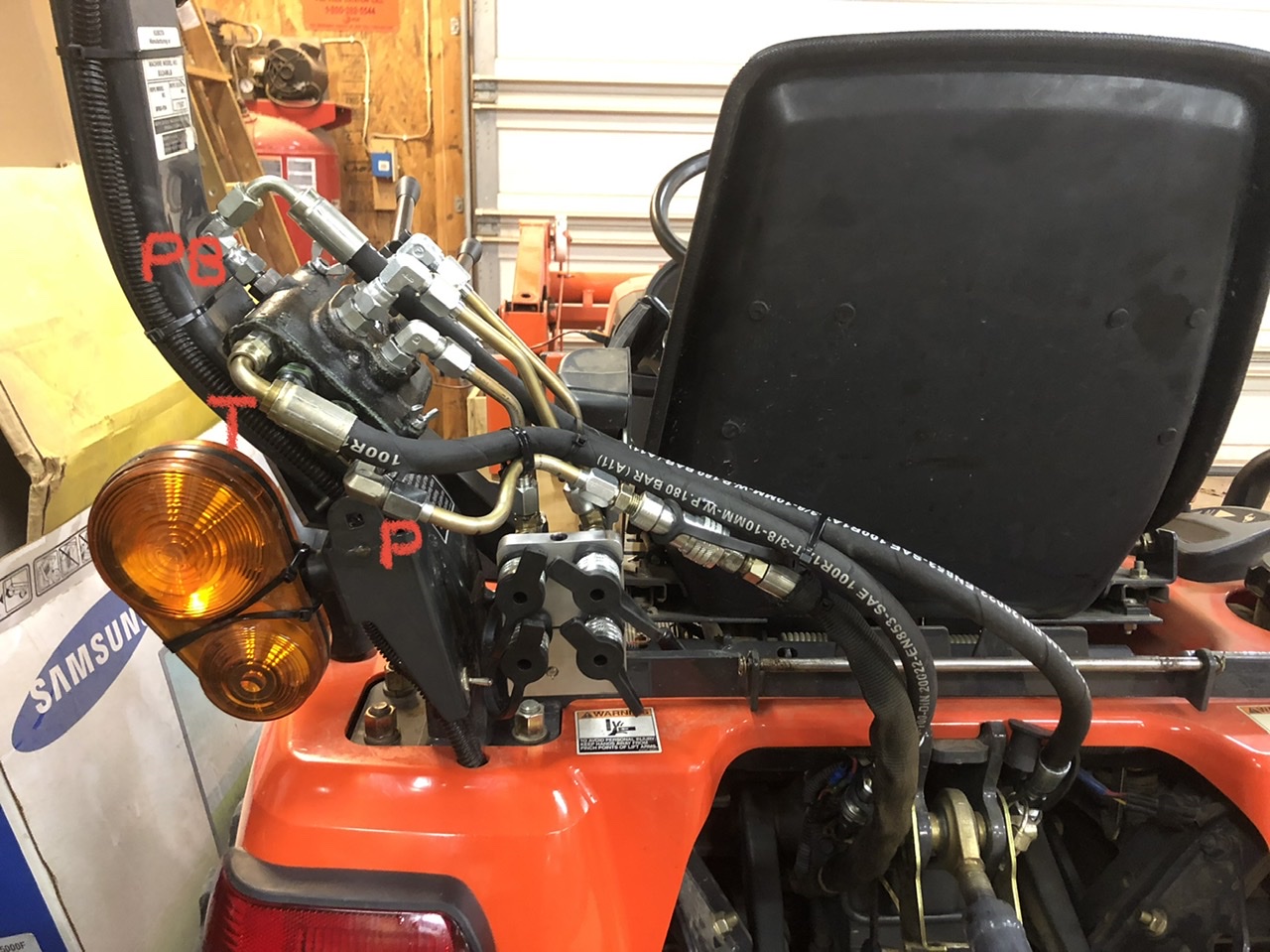

Easy Peasy: This is what I did for a Great Experience and Great Result:

You can put real remotes on the tractor for considerably less. This single spool valve and one set of remotes was about $200. That particular valve is made by Prince and a little pricey. You could do 2 sets of remotes using one of the 2 spool P40 valves from Summit for about $300. The plumbing is no more complicated than that selector valve from Tractor Innovations,.

The solution I posted was truly a 30-minute plug-n-play., absolutely nothing else to buy or invent. YMMV

My point is that is a very dirty half solution and very expensive for what you get. The only thing it has going for it is it installs quickly.
I guarantee you I can configure, right down to the individual fittings, a complete full function dual remote system for less than that kit. Even a novice could install it on any Kubota tractor thats similar to the one in that video in less than 2 hours. It wlll give you a two spool valve mounted right next tp the loader valve and two sets of push/pull couplers mounted in the exact same breakaway bracket on the rear ROPs.
I could make money by doing nothing more than cobbling up an instruction sheet, kitting the parts, and selling them for $500.
