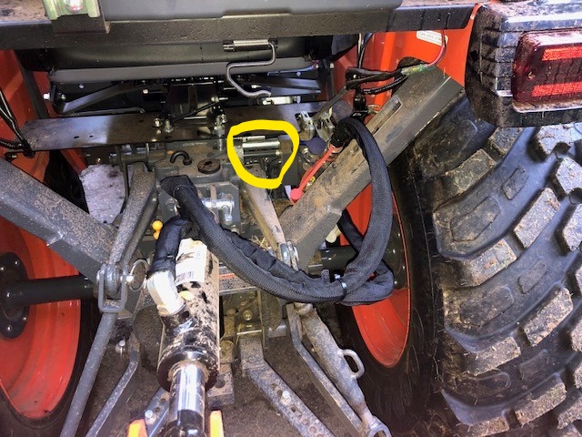

I have the same setup as this picture, can not figure out how to plug/unplug the couplings(only spent 5 minutes on it). Can anybody can help this idiot out?
They are push pull connections. Just push them in to connect and a firm tug and they pop off. They need the pioneer ag style, ball, or point. It is for safety if you drive away from something, the hose connection will let go.
Have you tried relieving the pressure in the hydraulic system?

Push in, pull out all in 1 quick motion.
If there is pressure in the hydraulic system, you won’t be able to connect it. I have the same problem when I try to connect anything to my ports, 3rd function, backhoe, rear remotes... I have to turn the tractor off and pop the loader into float in order to connect anything
This pretty much holds true with any type of std couplers. The pressure always needs to be relieved. You do not need to use float mode, simply relieve the pressure. ( Move the lever for the set of couplers that you are connecting-disconnecting with the engine off.

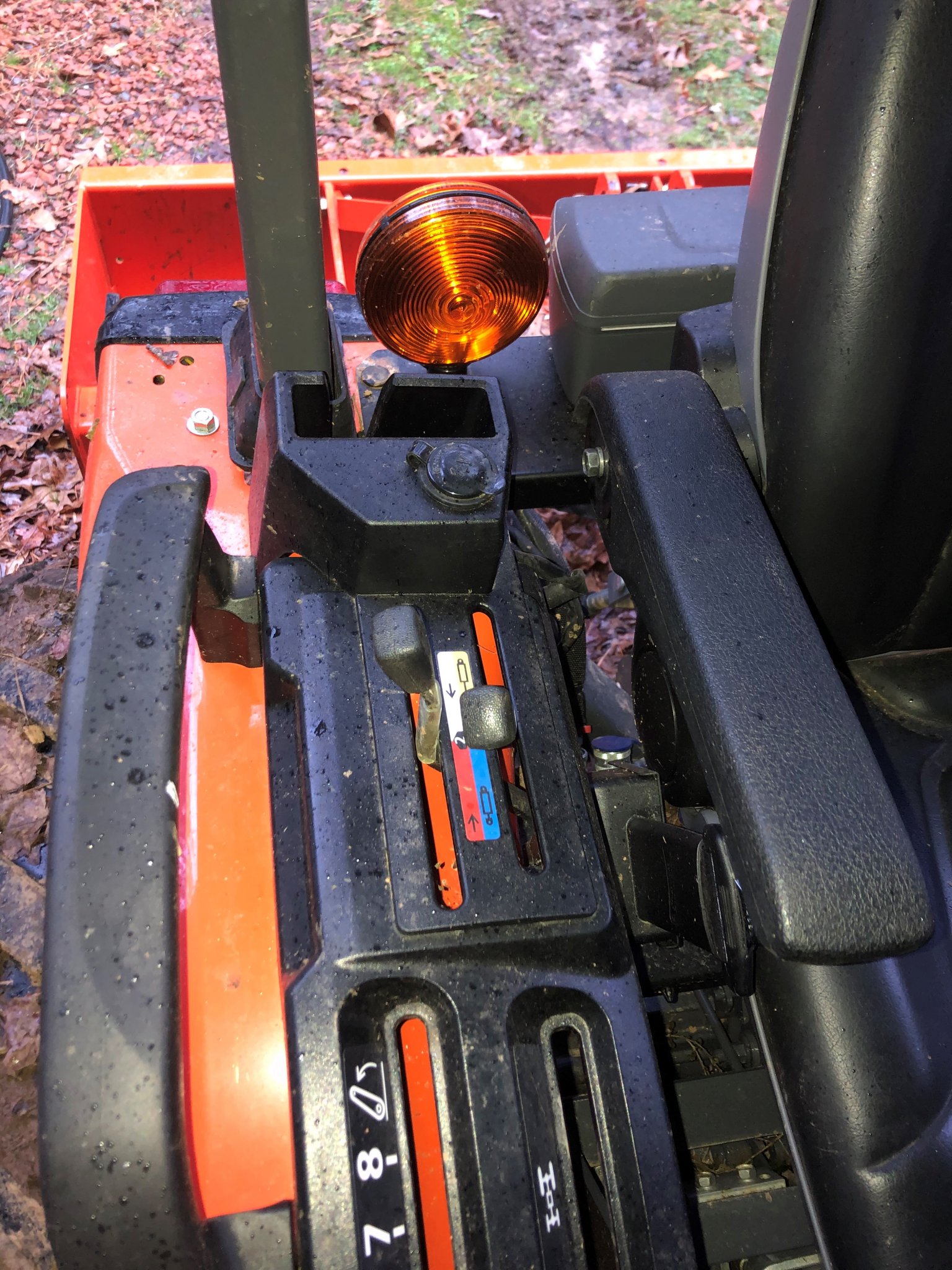

View attachment 59451 View attachment 59453
Here is the piping for the factory remotes on my 2610 non cab, as well as the levers.
I can't help with your other question.

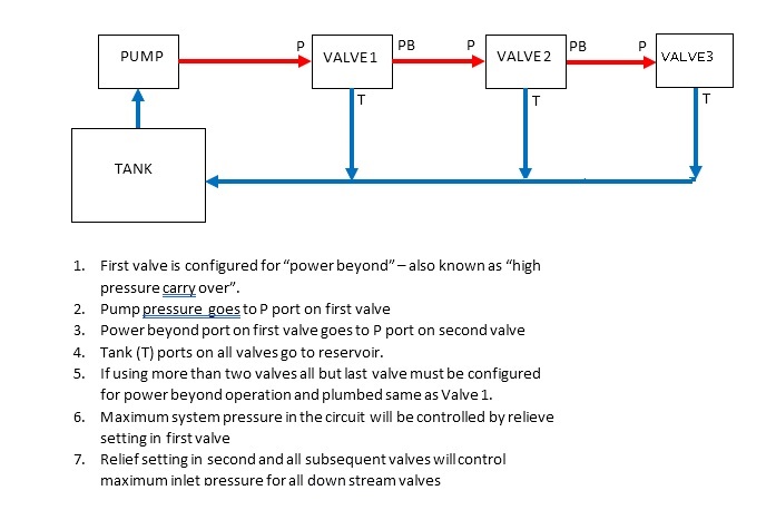

Thanks! That's what I thought. Just getting used to the terminology....pb return makes sense.
It doesnt to me. Power Beyond aka High pressure carry over is pump pressure to a down stream valve. A valve with a power beyond circuit will have a third return port which is low pressure back to tank.
