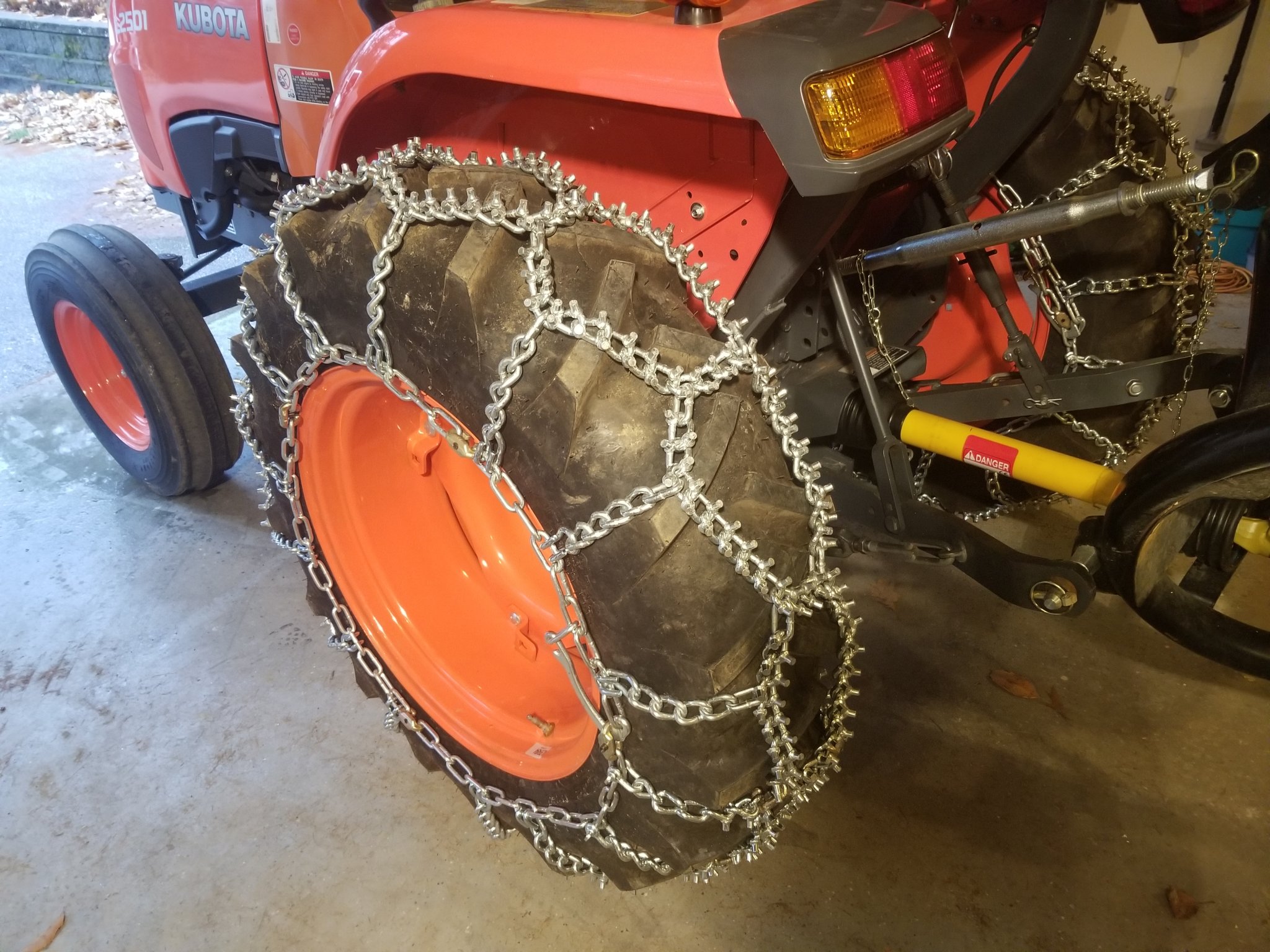

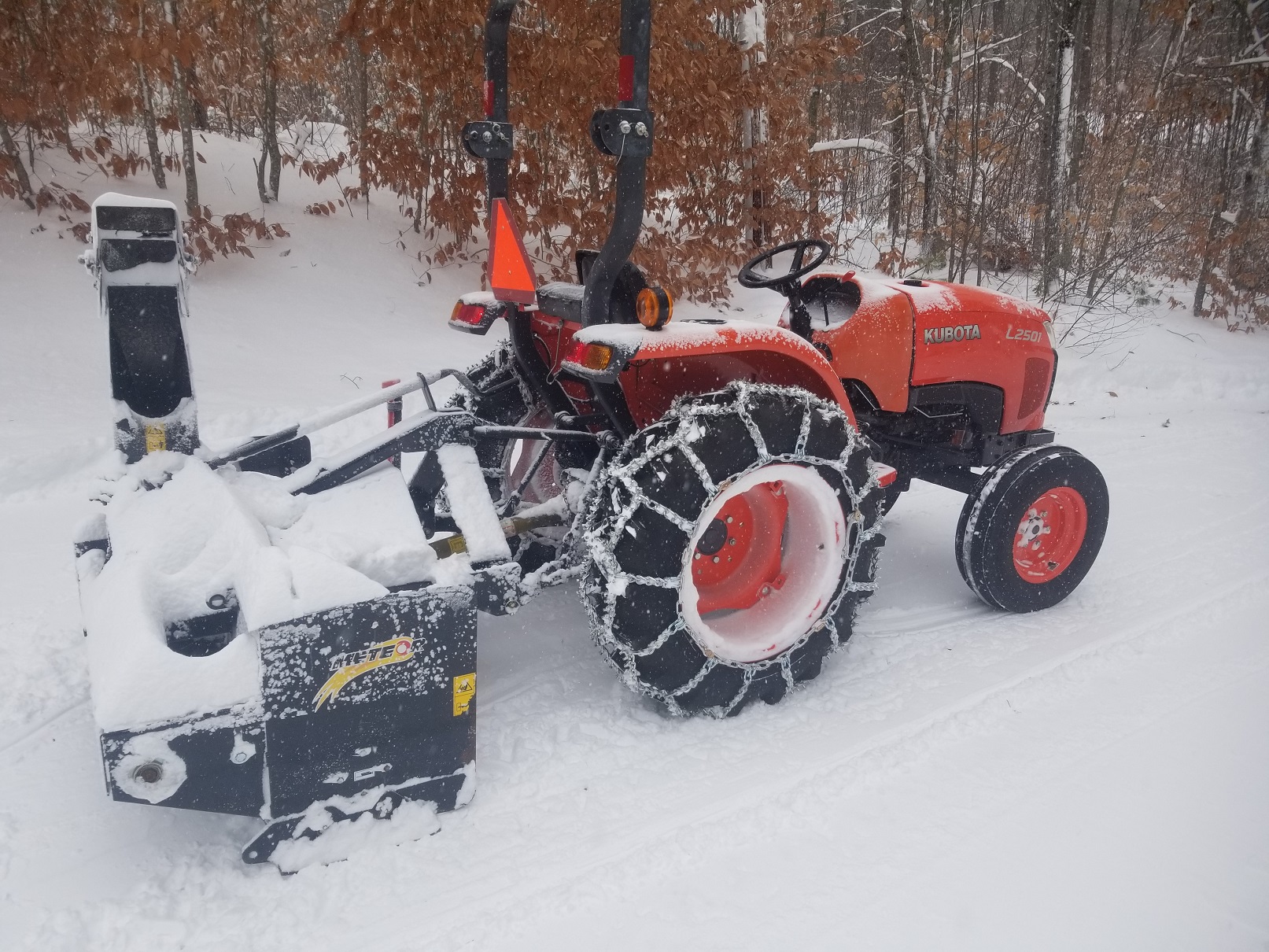

Ag tires are tough with chains. If the cross links ride in between the lugs then they are useless for traction. If they ride on top of the lugs then the tractor rides really rough.
I went with diamond pattern studded chains, amazing traction and they ride nice. I'll never get anything else after having these.

Those are really nice chains.
Would also work well on R4 tires, which I have. Ladder chains mostly fall between the lugs.

That's the beauty of that style chain. They work well on both R1 and R4. Ladder chains are good for turf tires if you get 2 link but I'm not a fan of ladder chains on R1 or R4.

Thanks DB73, I have similar rear tires with the big dealer supplied chains that ride across treads and in between them. Good traction, but terrible ride. Can you refer to where you got those chains? I may switch over.
