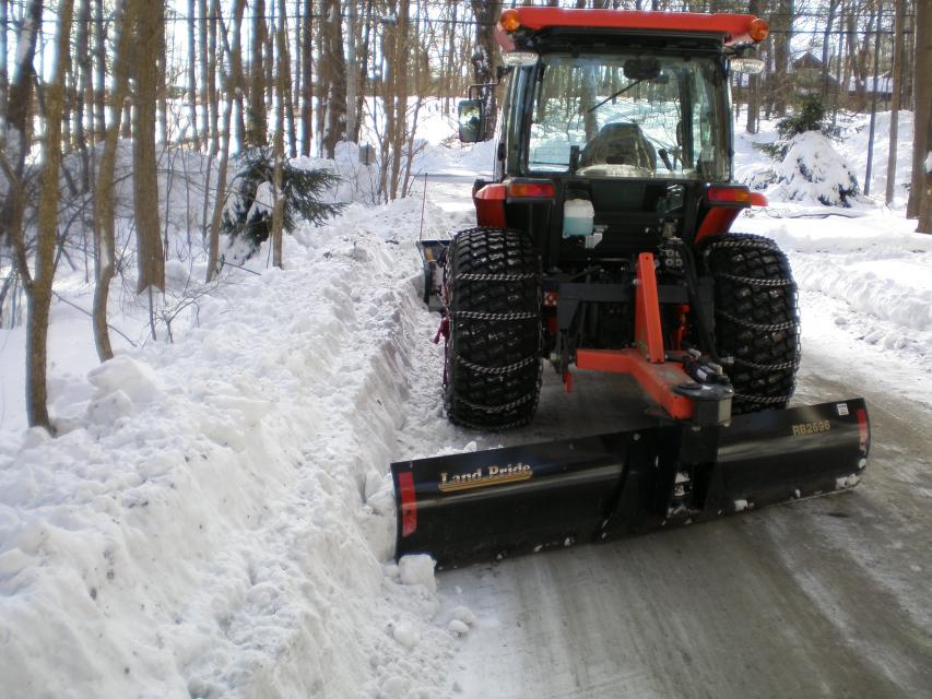

I have both, but rarely use the blower on gravel. I don’t get nearly the snow you get, but the kicker is I plow about a dozen residential drives and have to be able to clear a potential large snow quickly.
Were I getting a lot of snow and plowing a long gravel drive, I would still have a rear mount blower and move off the bulk of the snow with the blower raised. Follow with a blade as necessary.
Also, a 60” blower is not wide enough for a 3901. Start looking at 72” blowers (jmho).

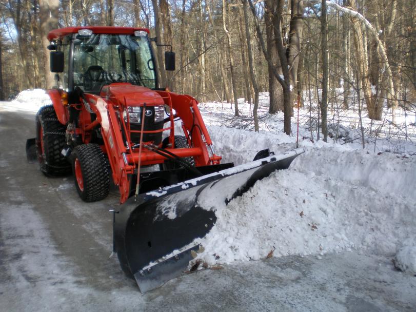

I have a Quick Attach front plow blade and a rear blade that I use backwards on my gravel 1000' drive. I thought about getting a blower, but have been doing this for 20 years plus and just can't justify the added expense for a blower. Like you said, I use the blades for other things, the front one you can put pins in and it becomes a dozer blade for light material. I use the rear blade backwards when the gravel drive is thawed out, the first and last storms are the worse.

I got a new tractor with a loader this month - it's gonna have a blade on the front for winter, one way or another!

If you get a blade get one that will pivot 180 degrees, that way you use the blunt/back of the blade to plow snow and it will not dig into your driveway. When the other member said he used his backwards I did not know if his pivoted or if he actually ran his tractor in reverse. Blade would also be useful for dirt work in the summer. I also have a front snow blade so between the two I get some good results.
