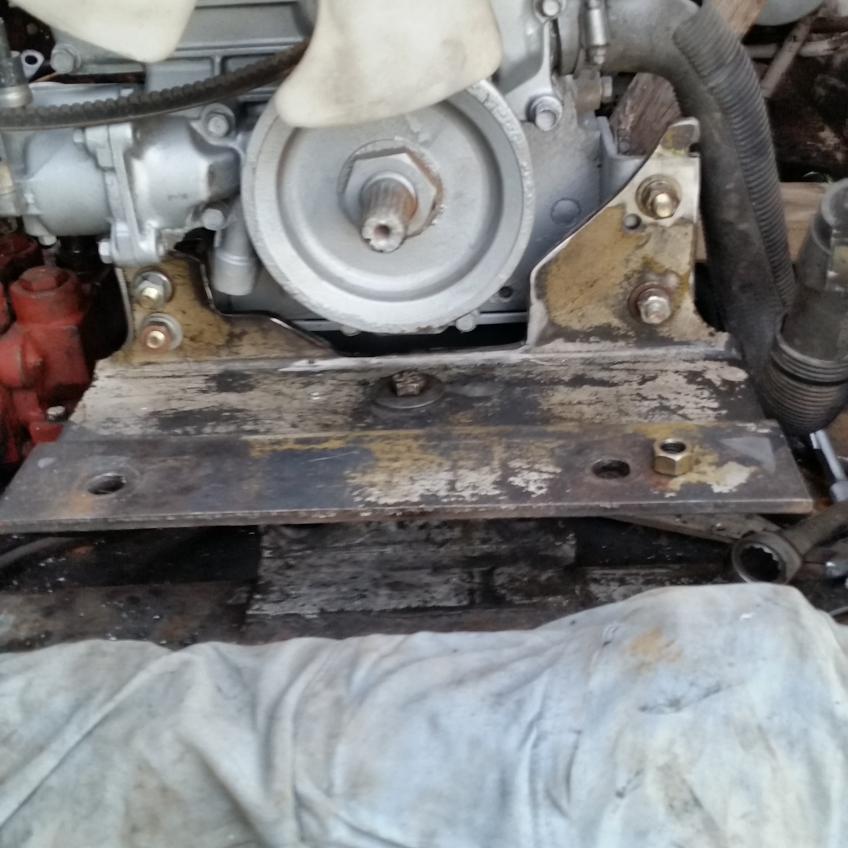

Not much visible progress, but I got the rear of the engine mounted with the front needing attention now.
I removed the mounting plate from the Perkins engine and began modifying it step by step to get to where it is.

I have a Perkins motor coming in from England stuck in EPA customs right now. I really would love to see pictures of the throttle linkage and mounts. I would do this in a heart beat. Any other pictures to post up? Thanks for making this a thread!

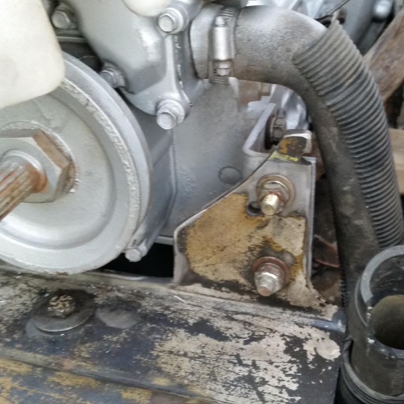

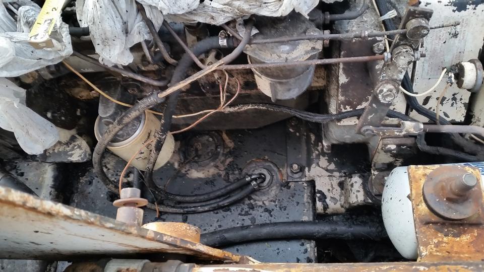

I was hoping to get a few pictures or theories on how you would hook up the throttle on the new V2203. The perkins had the injection pump on the right side facing the FEL part of the bobcat, i think the V2203 has it on the right ?Any issues with height or depth. In the one picture is that a 1x3 keeping it up off the gas tank so it mounts nice? Attached two pictures of my project.

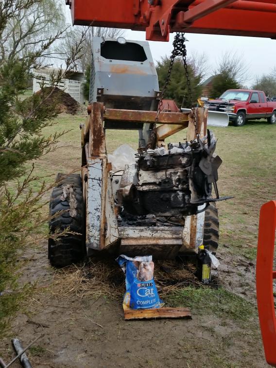

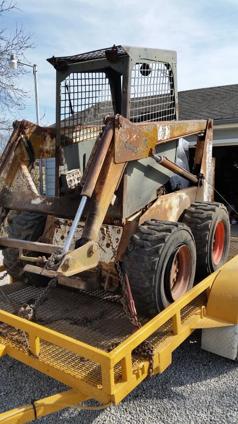

I'll post a few pictures. In one picture you'll see a cat food bag. That is filled with grease soaked dirt. I removed with a putty knife, two other smaller bags of the same material. I then power washed the thing three different times after soaking with Purple power, diesel and anything else I had around!!
You can see, by the pictures, it was pretty dirty.

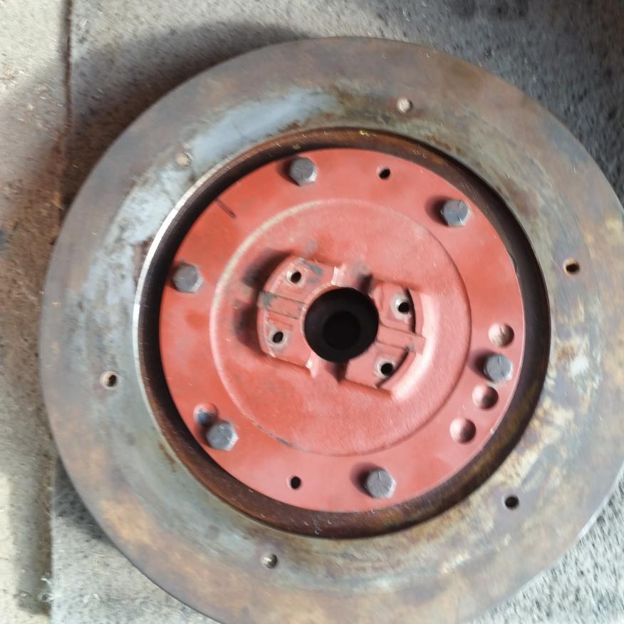

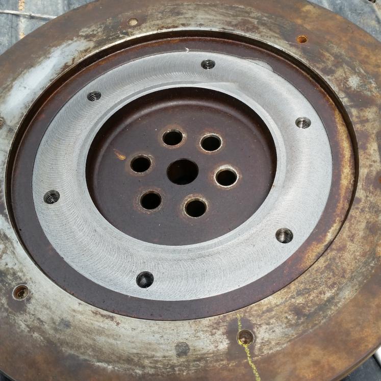

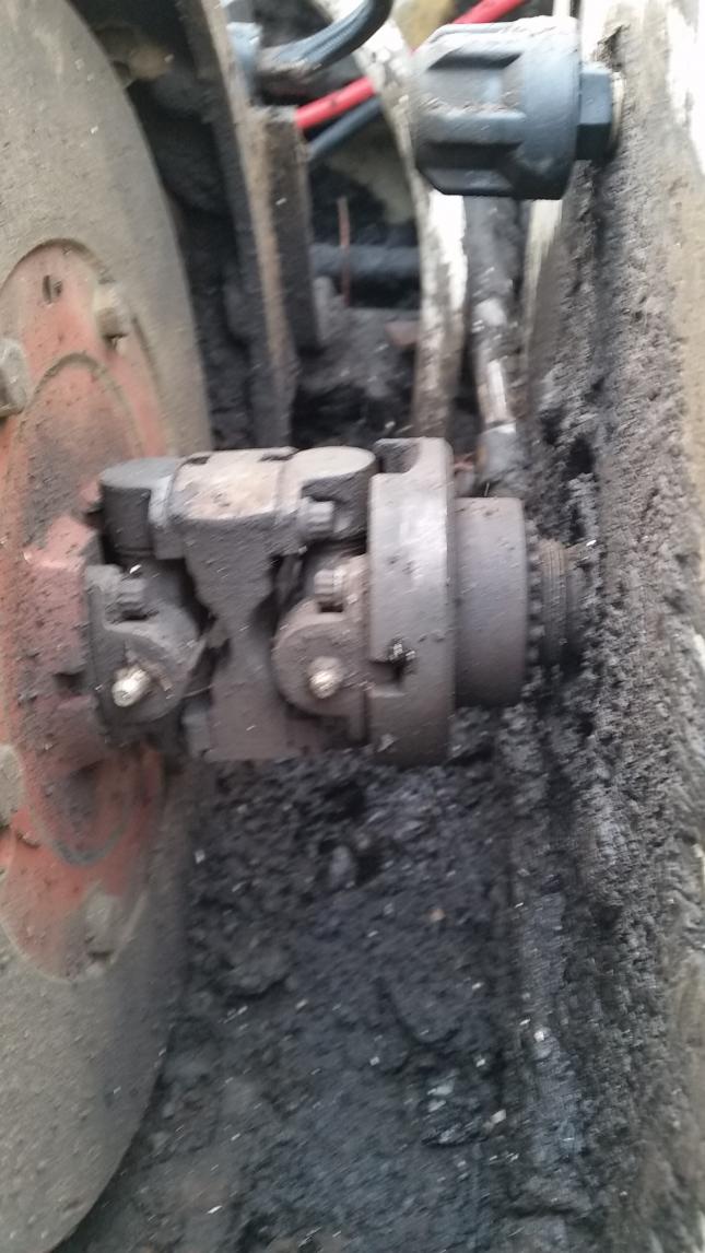

A few more... I had the flywheel from the Kubota machined to accept the flange for the U-joints going to the hyd. pump.

Here are a few pictures of the current and original state. paint is a little messed up in the back because i need to replace the rear seal on the pump and had to cut it off since it is a tapered shaft and i couldn't get a puller to yank it for the life of me.
Believe it or not i was able to get all the grease off with a few applications of oven cleaner. I mean this stuff was thick enough that i could grab fist fulls of grease/pine needles.
