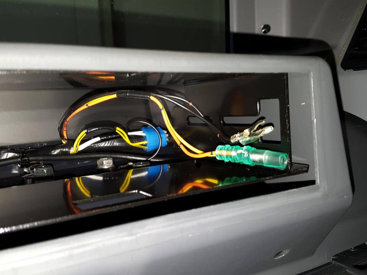

Hi guys, new to the forum and rather then start a new thread I figured I'd tag onto this one if anyone is still watching it. I just bought a new Kubota U35 w/ cab and am trying to install a radio into this unit. It came with the antenna, speakers, housing for the stereo etc. "prewired". When I first opened the housing there were no wires available, they were all taped to the back of the unit. I had to take the housing off (pain the butt) to get to them but I took the tape off & this is what I now have. There seems to be 4 wires (maybe 6 if the yellow and white ones in the back (with blue tape around them) should have come apart as well. There is no connector and the Kubota harnesses I am looking at online seem to have way more wires then I do. Any help on what I should be looking for/at would be appreciated.

You're going to need a Work Shop Manual, or a schematic for your machine.
It will show you the color coding for the wiring you need.
At basic, +12VDC power, ground (gnd), antenna, speaker left + and -, speaker right + and -.
Looking at the thumbnail, it appears to show a coax cable which would be the antenna conductors.
You would match the Kubota to the new radio like for like. Using connectors will allow you to pull the radio to replace it.

WOW thanks for the quick responses. I've gotten a bit further. Sure enough when I took the rest of the blue tape off, the speaker wires revealed themselves. With my test light I realized I had zero power to any of the cables so I popped open the fuse panel on this brand new mini ex and what do you know, bad fuse. Fixed that but now am scratching my head. There is no constant 12v power on any of the wires. There is power to the yellow wire when in ACC or when started, but when I go full stop, there is nothing to keep power to the stereo which means everytime I turn it off, I will lose the clock and the station presets. I don't have a cream colored wire just what I'm showing. I've attached a better picture if anyone has any other suggestions. I am in the process of trying to buy a service manual.

It might be wired so theres only power when the switch is on

The +12VDC is wired the way it is to keep from running down the battery.
When you get a schematic you will find an unkeyed +12VDC to tap into. You may want to take the existing wire and move it to a new fuse if you have an empty slot in the fuse box.
What you're wanting can be done.
