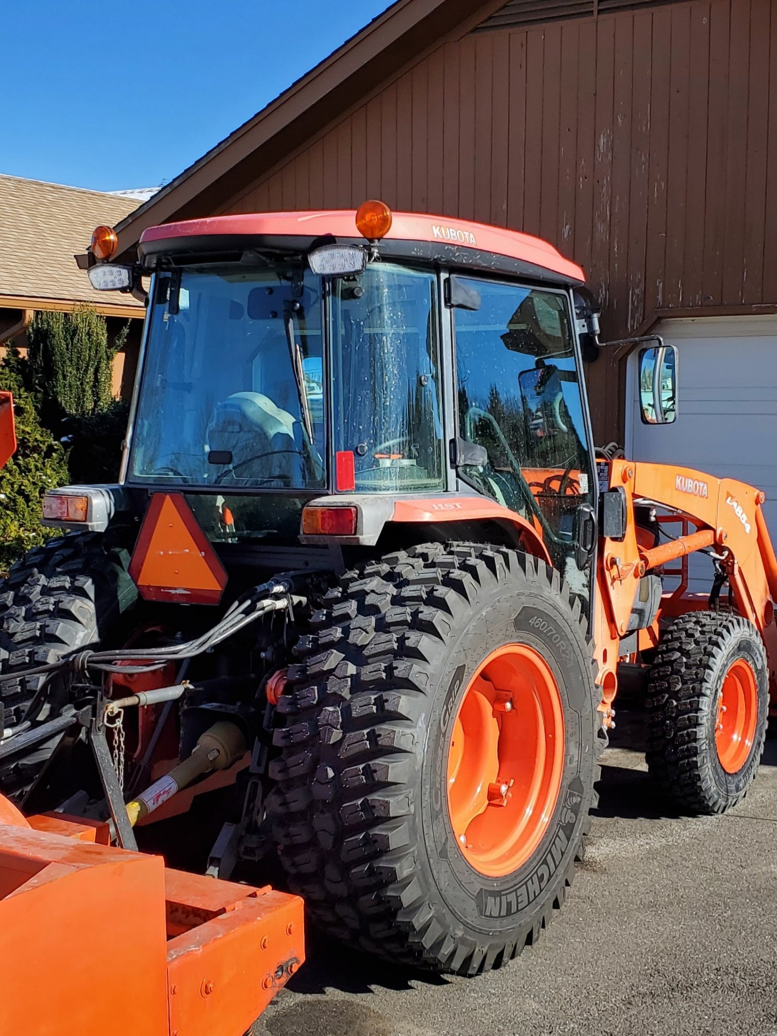

I was able to get my 4240 shod with Michelin Crossgrips to help my snow removal hobbie. Had to buy new 16x8 front wheels to replace the oem 16.5 wheels. 250/80R16 fronts and 460/70R24 rears. I had @ 9" of snow to deal with from WS Orlena and using the Crossgrips for the first time, OMG, Shut the front door!! I was impressed ! I just finished grooving my half warn R4's slicks which did improve traction. The Crossgrips, however, are like using invisible tire chains on all 4 tires. Vibration free road travel, smooth steering as you maneuver and ultra traction with no beet juice or extra hanging weight. Yeah, tractor tire replacement is pricey , but you get what you pay for. I feel like the Crossgrips were the correct choice for my application., plus they look awesome.. Ill post some pic from my phone.

First storm using those big "ol truck tires was amazing.

Hi Botabart, Actually I learned quite a bit @ tractor tires and why choosing the correct tire size for a MFWD tractor is so important. As it worked out, the metric size equivalent was the same as the eom sae size. i.e. a 16.9-24 Titan is a 460/70R24. Had to purchase new 16x8 Kubota wheels for the 250/80R16 fronts but they too matched the 10-16.5 SS/loader front oem Titans . I did all the math to insure that I had a positive % lead, which was ( .77% ). I was hoping for a 1.5 to 2% lead but your choices for that type of tire are quite limited. I was thankfully impressed with the performance of the Michelins on my first outing as I layed out some serious cash. I'm gonna play with the TP in the rears. You can run much lower psi with the radial Crossgrips as the 4240 is not a high speed tractor. I observed 15 mph at 2200 rpm ( HH ) which I considered a sweet spot on pavement and the cruise full forward. I'm hoping these tires will treat me right.
