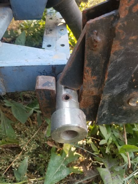

They are bushings to increase from your Cat 1 lift pins to Cat 2 or 3. Your QH is probably Cat 2 or 3 compatible.
The ones Wolfman linked are ideal for ground-engaging stuff, and on line is they way to buy them. I use them on my box blade, but not carry-all. $15 on eBay....$30 at TSC.
A simple bushing will also work for some stuff. Takes away slop. Different sizes for lift pins and top link pins. If needed, a Cat 2/3 bushing will slide over a Cat 1/2 bushing to shim out a Cat 1 pin to 3. So far, I haven't used a bushing on the top link pins, but have on lift pins.

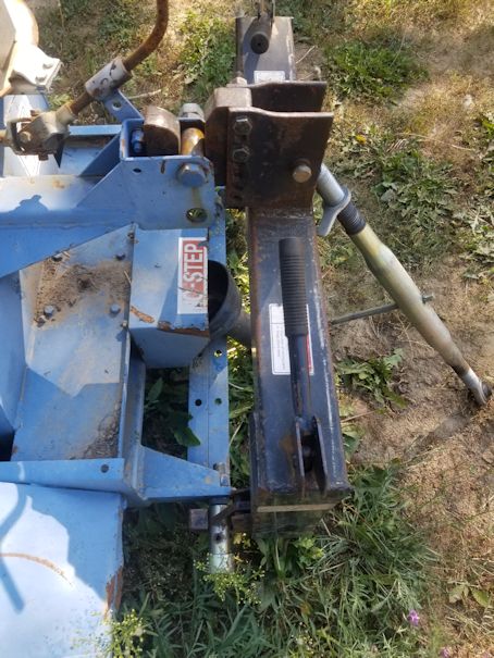

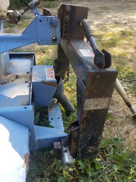

30,210
6,382
Thanks North Idaho Wolfman! You're saying put the Cat 2 adapters over my Cat 1 implement lower pins to make there be less slop in pin-quick hitch connection.
I'll pick up a couple of adapters, thanks.
Bingo and notice in the pictures how the hook is on and the only thing holding it up is the QH as i don't even have it attached to a tractor at the moment...Tractor in on post hole digging duty! :D
5,367
1,415
Also notice the bushing is attached to the implement using a roll pin through the lynch pin hole. Get a set for each implement.
