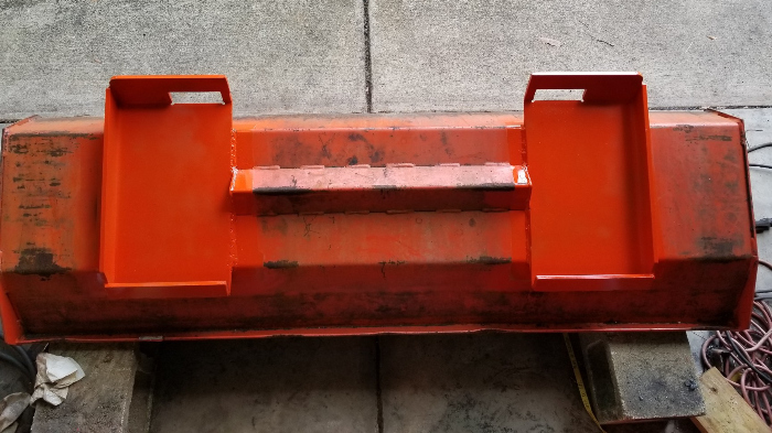

Here is where I am now. I cut the middle out of the plate. I had to cut the angle iron support on the bucket down to 25" to fit between the mount plates. There was a ton of rust and scale under the angle iron and the old ears, but fortunately, not much of it was in the areas where I'll have to weld.
It looks like I'll lose a couple of degrees of bucket rotation, but I can't think of a time when I have felt I needed every available degree. I could make some supports to increase the angle, but it seems like a waste of time.
I plan to paint the areas where the old paint was destroyed, but I am too tired to paint the whole bucket. I feel like I've been running angle grinders for a year.
I want to put the plates on the FEL, lower it to the bucket, and tack them in place. Then I can back the tractor out and weld them. I can't do it right now because I have a hydraulic leak, and I don't want to move the tractor until I fill up the reservoir.
After this, I get to chase down the leak!

Here is the final product. I wish I could have just bought a bucket, but you do what you have to.
