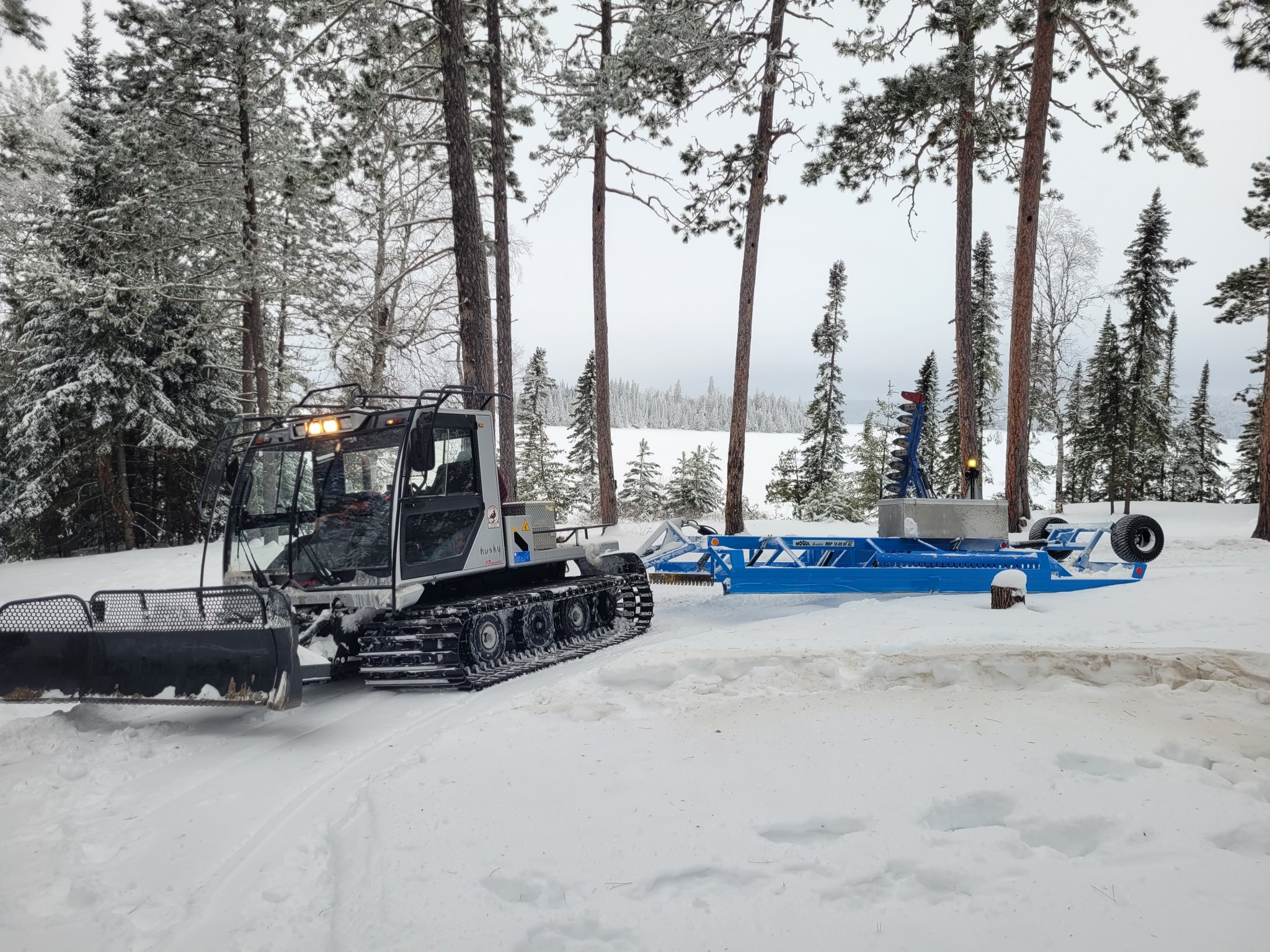

You could ask what snowmobile trail groomers use !! They're probably the experts at it !

some famous but STUPID hollyweird guy (?) ran over himself with one of those month ago.... didn't set that front PARKING brake before shutting off the machine..... idiot...
friend on mine drove one for years,his winter job...summer he drove very heavy earth movers.
