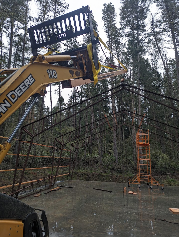

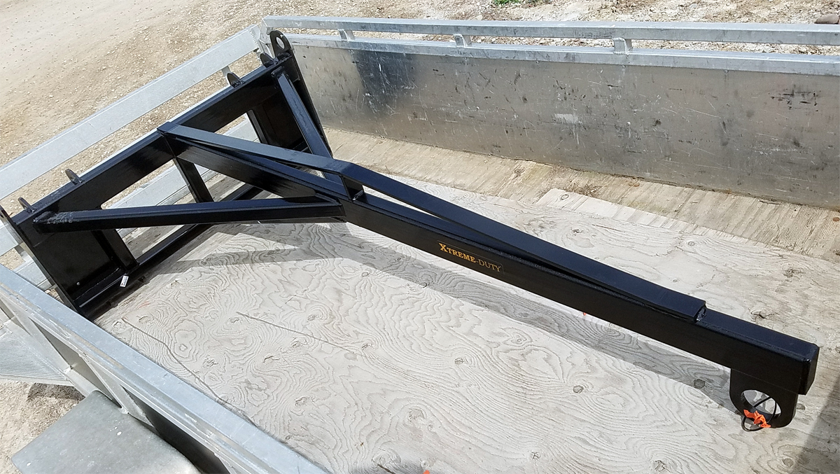

I decided to go with a turnkey solution. I'm ashamed to admit that I've yet to use the boom pole but that will change shortly as the new sheds/pole barns go up.
Could I have made my own for less money, maybe. But at $1,258 I felt it was worth the cost, even with shipping to the local Kubota dealer. It'll last forever, and when I think of what it would cost to pay a company to put up the buildings that I'm planning and building myself, the cost of this implement doesn't really mean a whole lot.
Here it is on the MX
