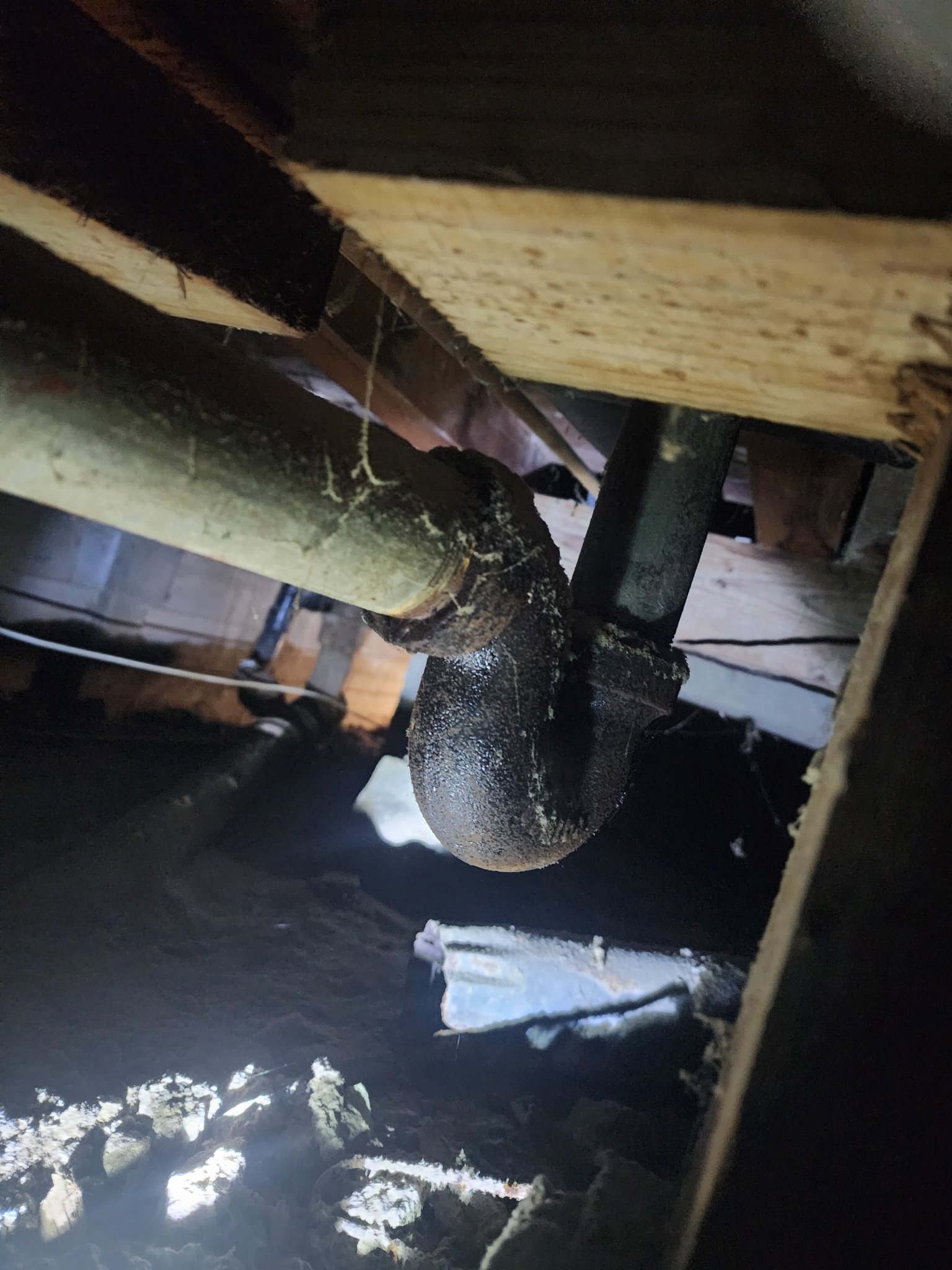

So, this house was built in the early 1950's. The tub / shower combo drains very slowly. I want to replace the drain line from the tub itself to the main drain line "bell" fitting. My question is, what is the bell looking fitting and how do I address it? I don't want to remove it, but how is it fastened to the vertical pipe? Threaded? Or plop right in there?
All Galvanized pipe and what appears to be CI fittings.
Thank you in advance for any help.
And yeah, I'm too old for this kind of thing. But a penny saved is a penny earned. (And I want to buy a snow blower, not remodel a bathroom).
Edit: The plumbing in the rest of the house drains perfectly. Just a bathtub issue.
It's all in a crawl space under the house.

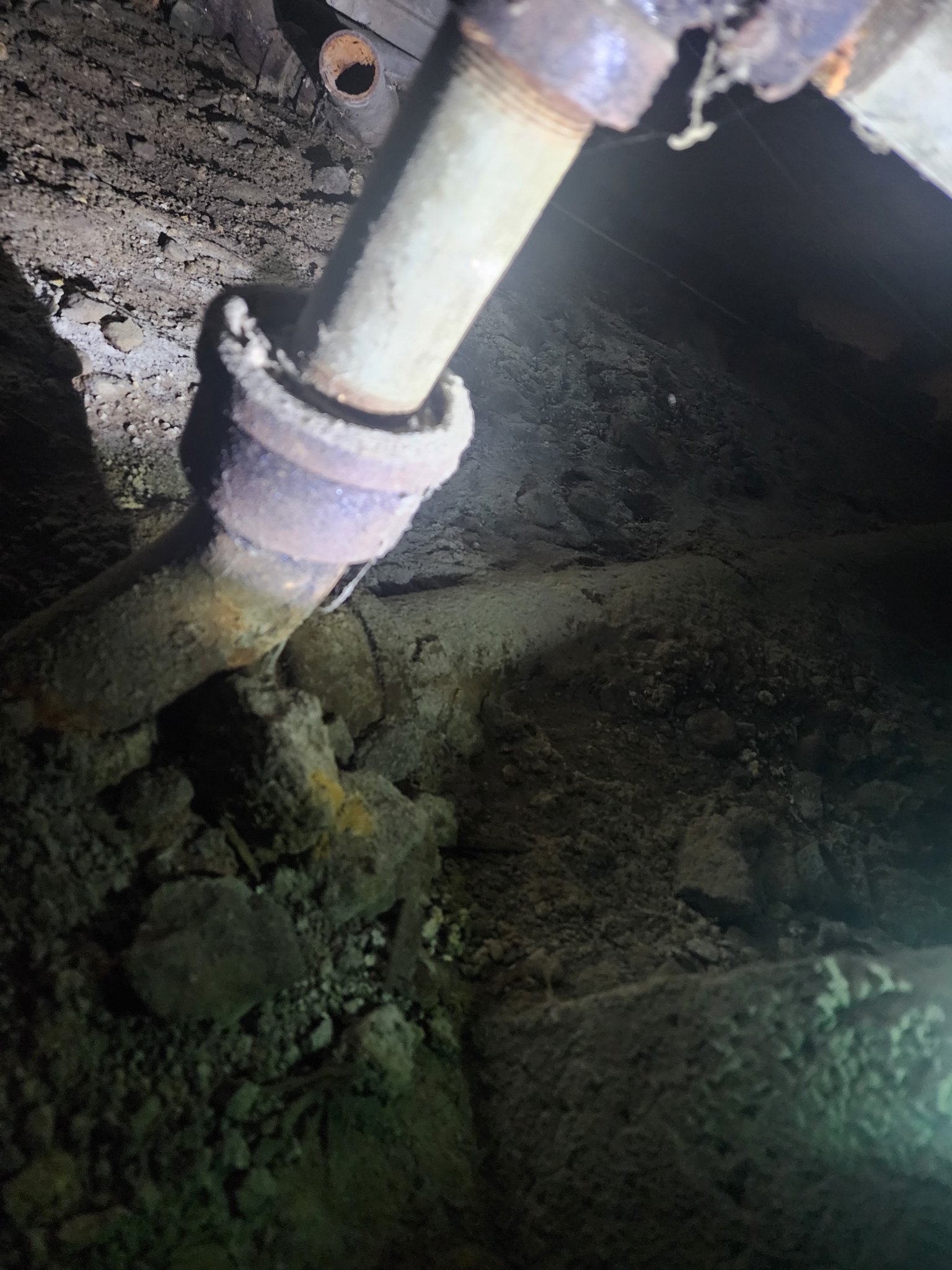

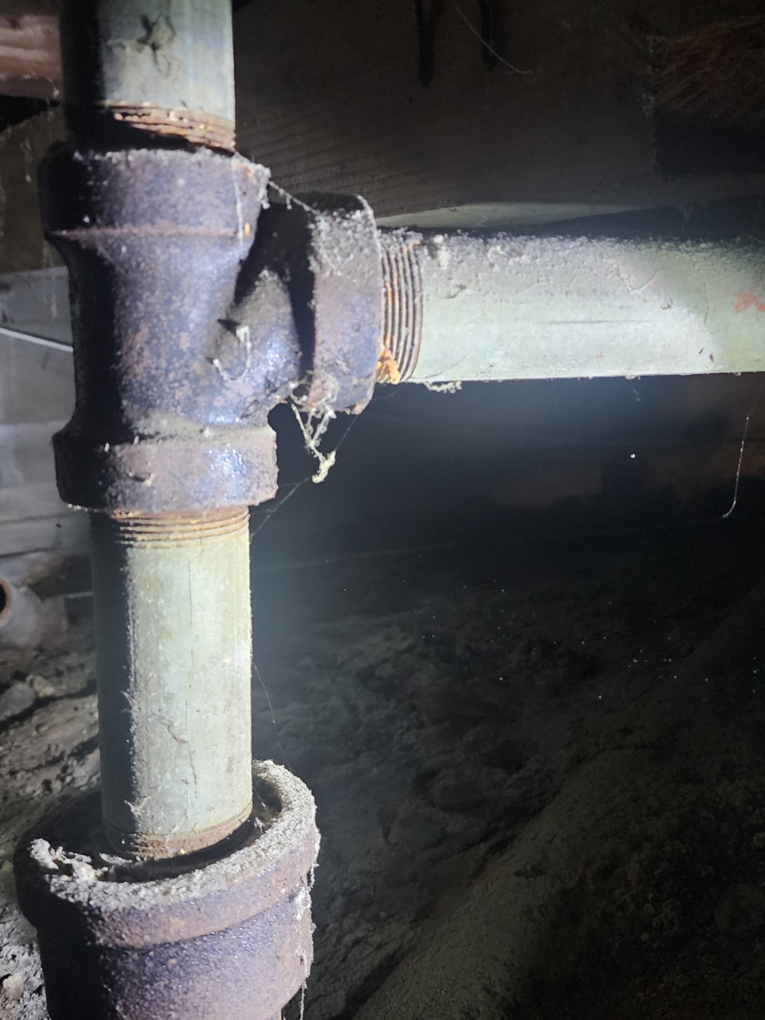

In the next picture the horizontal line going to the right goes to the tub. The vertical line above the sweep ell is the vent out the roof. Below the sweep ell is the bell thing which connects to the 6" main drain line.
Next pic is my dog loves adventure and crawled under the house with me. And the last one is the trap under the tub.

That appears to be a 2" cast iron bell. The galvanized pipe is probably sealed with oakem and poured lead. Today, they would be sealed with a rubber seal.
35,739
10,803
Yep lead seals.
You can get rubber replacement seals.
^^ Yup^^ and it required a trained plumber to make those fittings. A plumbing supply house can fix you up with everything you need.

I cut the vertical galvanized pipe that joins to the cast iron,then 'fished and flushed ' the CI drain, thern replaced all the galv pipes with ABS....

Since the drain is running slow and you have no pipe breaks I'd begin by running a snake from the tub overflow. Take the two screws out and pull the hardware up and out and insert the snake there. Be sure to have a rag over the drain so the screws don't drop and get lost.
I'd suggest going to your local rental yard and getting a drain auger. They will have one powered by a 1/2" drill and 25' of snake. Take your time and you'll easily clean the problem out. Once starting with the snake have a few inches of warm water in the tub. That will tell you when it clear. You'll probably feel the resistance of the stoppage and when you remove the snake you'll probably discover a wad of hair!

If 1.5" isn't too bad far gone a simple way is cut 1.5" pipe off a few inches above cast iron hub and use Fenco clamp to connect new ABS line. Since you have easy access to drain you might consider an ABS trap with clean-out plug. As you've seen snaking from tub it's near impossible to get past trap unless using an under size snake.

looking at the pictures,again, I'd replace all the tub galv piping. cut 4" from that 'Tee' into CI. Use plastic for new tub drain connection, Tee trap and then straight to Fernco . While open, clean up the galv at CI Tee so you get good flow. When you cut the horizontal pipe SUPPORT IT, so Mr. Murphy doesn't break the Tee at the CI end ! Get an LED 'shop light'and 2nd extension cord and drag that in with you. Having GREAT light makes the job a lot easier. A few of those rubbery foam jigsaw mats help.. and coffee NEEDS to be in a sippy cup.
