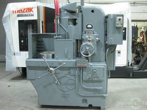

When the company closed down the quartz research lab I worked in, I considered buying the 11-20 Blanchard grinder for personal use.
I contacted the local power company about bringing in power for it, and when they got through laughing, they told me it would be cheaper for me to buy a property in an industrial area that already had the power the grinder needed.
If I remember right, it was 480V, 60A, 3 phase.
20hp spindle, 14hp table drive, 8hp spindle feed, 4hp coolant pump.
Sigh, it was a fabulous machine.
