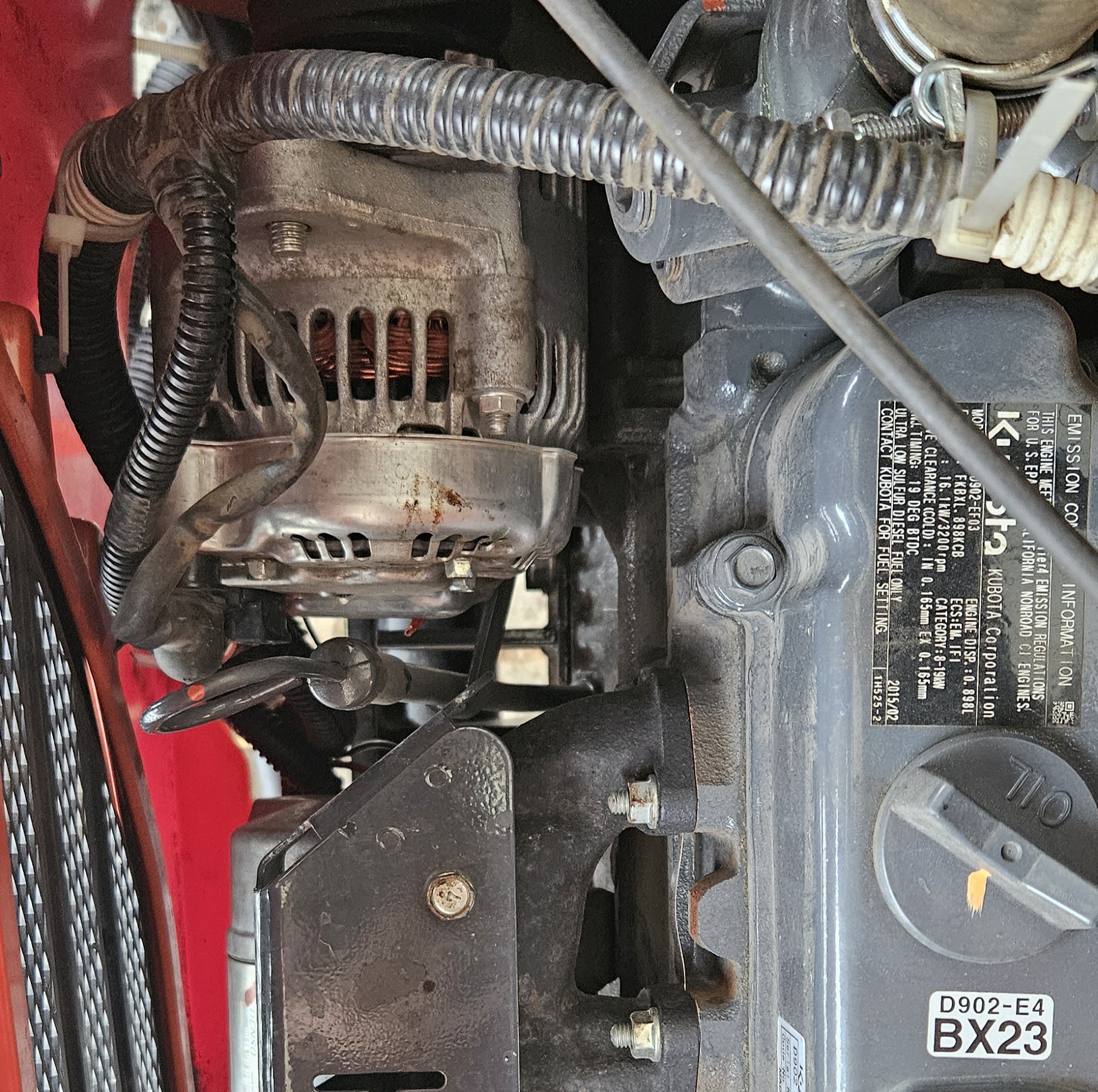

That's the thing, my BX doesn't have that tiny dynamo, it has a tiny alternator, so maybe it's more than 14A.

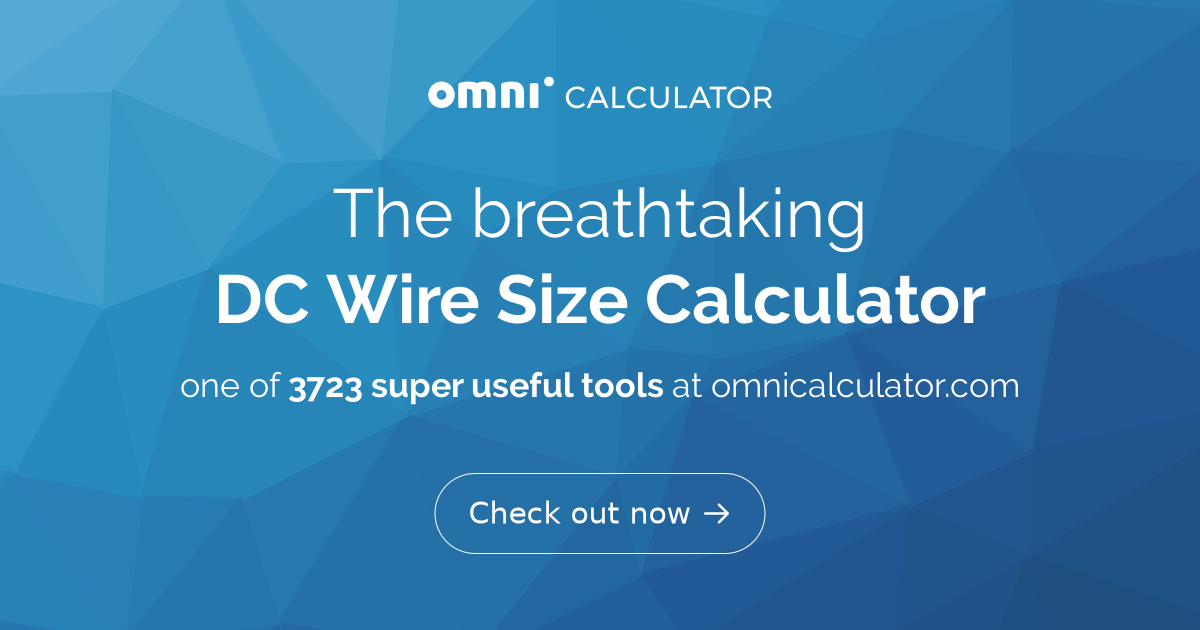

14 gauge wire (which is what the OEM wire "looks like" to me) will carry 35A short-distances (under 6 feet), though it will have a voltage drop and warm up. Should 6 AWG be used for 40A? Ideally, like for a starter.
Here's a comprehensive online wire size calculator:
For my add-on lighting circuit I should figure:
14V source
2V drop
Copper
8A maximum current draw
10 feet
120°F maximum wire temperature
=12AWG (which the OEM feed is clearly not, it looks like 16AWG fused at 20A)
And here's where real-world experience comes in. If I split 10 lights drawing 8A total into left and right light bars each bar draws about 1/2 the total current, and if the multi-wire cable I'm using to control banks of lights has two return wires that's 1/2 current again resulting in 2A per return wire, and according to the calculator that requires two 18 AWG wires. Since it's for myself and not someone else I'm running bundled cable with 22 AWG wires suggesting a 6V drop, but in reality it works fine. Why?
The source voltage from the tractor is 14V with the engine running, not 12V, and LED lights will run at 11V just fine due to having regulator circuits inside them, so that's a 3V allowable drop end-to-end, which in reality is more like 8' total length. Allowing for a 170°F wire temperature given the lights will be run for snow plowing and the starting temperature is not 70°F (it's more like 25°F or less) meaning there's less heat which causes less resistance and less power needed, 22AWG x2 per light bar is just fine.
But I will look at the alternator this weekend.

Of course you're right about wire insulation making it hard to determine wire gauge; I know the BX alternator wire isn't 12AWG because the diameter simply isn't large enough, but what is it really? I can only guess from trying to remember what I saw when I looked at it. Let's hope it's enough--maybe I should check, but likely I'll just feel how warm the wire in the rear aux. lighting harness is and call that a reasonable test.

...CS130 can be had at 35-55-75-125-165A....i dont work on the small BX series so it would be interesting to see.
There might be enough room to mount a big/bigger alternator, thing is there's not enough room for accessories to use that much current! :ROFLMAO:

Then I'm covered, you guys had me worried with that 14A figure. Thanks for finding that information, I've been busy working on family care and tractor lighting for plowing at night.
