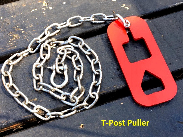

Here's a home made puller that leaves the tractor operator in the seat.
I like the concept, but that particular puller requires some fairly precise placement of the bucket.
A hydrostatic tractor is much better suited for that type of thing than my gear tractor. If I overshoot the post then I am going to have to change gears (reverse) to correct the alignment. Certainly a handy way to pull posts however. (y)

Do you have a set of pallet forks?
If you do and it has the hole in the end, you can bolt that plate to a pallet fork and use the to pull the post while never having to get off.
You could do it with a bucket but it makes it hard to see what your doing.
EDIT: I Just read what you posted above and agree you would have to be fairly precise to thread the plate over the t-post.
Short chain and a clevis sounds like the quickest method for you.

Well the verdict is in. I have other things to do today...but thought I'd go pull 10-12 short T-Posts and see how the rig works (or doesn't work). I can tell you right away its 'the cat's meow' for what I need to do.
I don't know if they ALL work this well....but this one does. I rigged it with a clevis on each end because I don't see the need in having to place the plate over the T-post and then thread the chain through the slot all the while holding tension on it. Crazy if you ask me.
Also the clevis allows the chain to seek its own best angle for the pull.
The first pull I placed the plate in its intended orientation and made the pull.
Observing how well the plate would 'bite' the T-post I determined that it doesn't matter how it goes on the post. Forward, Backward, Sideways.....it will grab the post and not slip no matter what.
I can imagine a situation where a really stubborn post might need the plate to engage one of the 'nubs' but none that I pulled needed that.
Just throw the plate on the T-post. It doesn't matter how far it goes down or what direction. It took me all of 20 seconds to walk up to the post, throw the plate on it, walk back to the loader control and pull it....and I'm old!
And yes, I know I need to rebuild the bottom of my bucket (after 27 yrs). ;)
