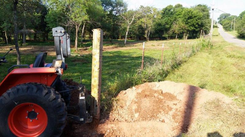

I've had really good success pulling things out of the ground with my 3pt quick hitch. We all know the 3pt lift is much great than the bucket, although the trade off is the amount of stroke. The 6x6 corner post in this pic was set in about a foot of concrete but with some wiggling and lifting, it came up with a large chunk of concrete still attached. I wrapped some chain low around the post and again around the hook on the hitch and voila!

Another great technique, especially for those without an FEL to use!
Just what I was going to say. With more lifting ability on the 3 pt. That seems the way to go on a tougher job.
