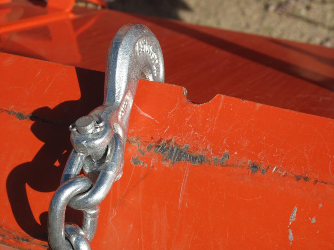

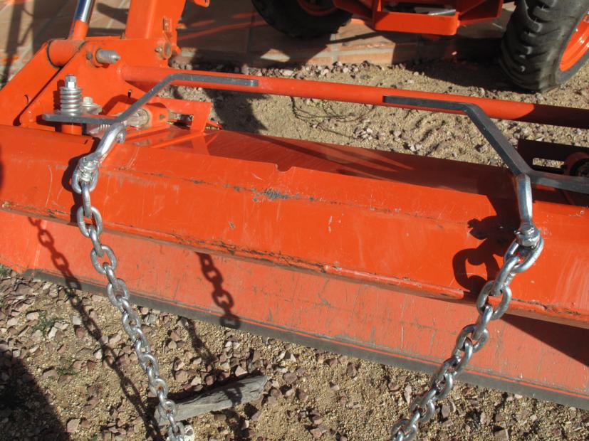

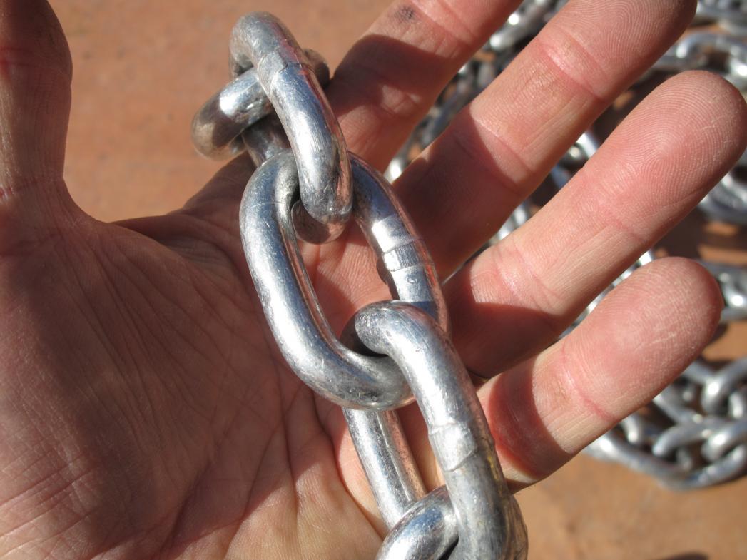

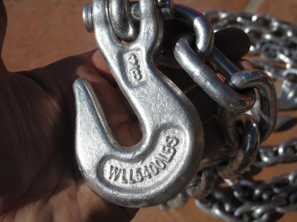

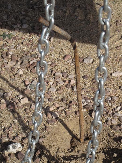

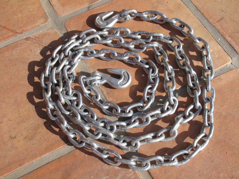

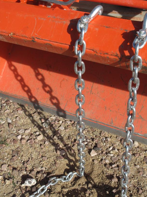

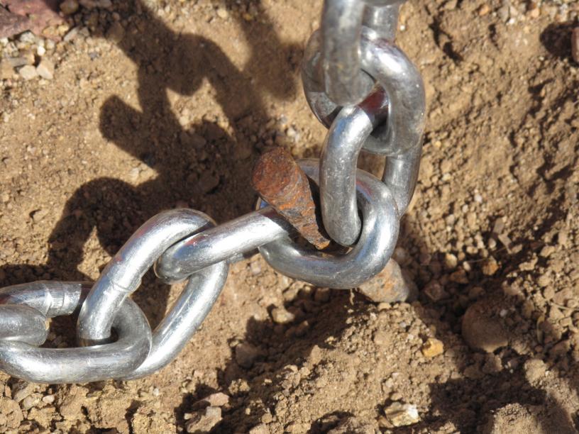

I used a 15' section of heavy Harbor Freight chain with hooks on each end. I dropped one hook over the upper bucket edge, which was curled fully down to the stop, and then wrapped the chain around the pipe, then hooked the other hook to the bucket. I took out the slack and then curled the bucket back, sliding the pipes out as sweet as can be. Same with the rebar though one gave me a problem because it was short. The chain was large enough to fit the rebar in the eye of the chain and the put a bind on the rebar that wouldn't let go and it slid right out.
