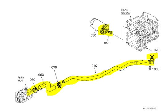

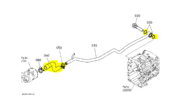

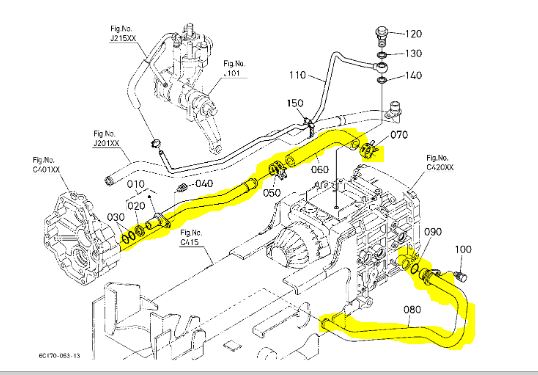

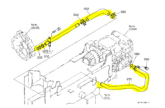

I will post pics in a bit of the two lines that you need to look at.
30,619
6,652
There is 2 different Hydraulic line variations on that model, you will have to see which one you have.
Major difference is one variation has a filter screen and other had a spin on filter.
If you have the model variation with the filter screen, they are known to clog up in the inside screen, while the outside looks clean, might consider just replacing it, along with the O-rings.
If you have the model variation with the spin on filter, are you sure the old gasket or any other material is not preventing it from sealing properly?
Check all lines and connections for soft or wet spots, sometimes the wet spot will be very small, if it's dirty steam clean / pressure wash it clean, dry, then run, then look for wet locations.
Would still also like to see pictures of the loader hydraulic lines because your issue could also in that setup.
