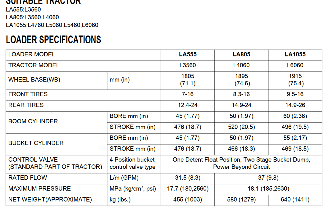

I don't have specs for the LA526, but here is the sheet for LA555, LA805, and LA1055
If you take the LA555, I would assume your loader will weigh around a 1,000lbs plus the bucket ~300lbs.so, if you tractor is ~3,000lbs, the loader and bucket about 1,3000lbs, you are looking at ~4,300lbs. Plus, then you have to consider do you have a rear implement on it, tires loaded, wheel weights, etc.
