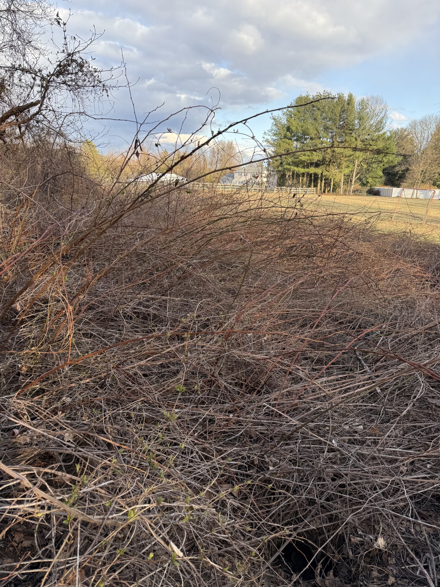

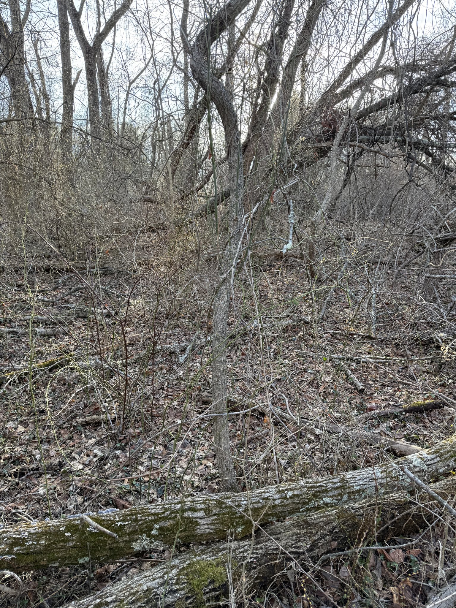

Here are a couple of pictures of the land I want to clear. It’s only about 90’ wide and tapers down to 50’. The length is about 1500’.

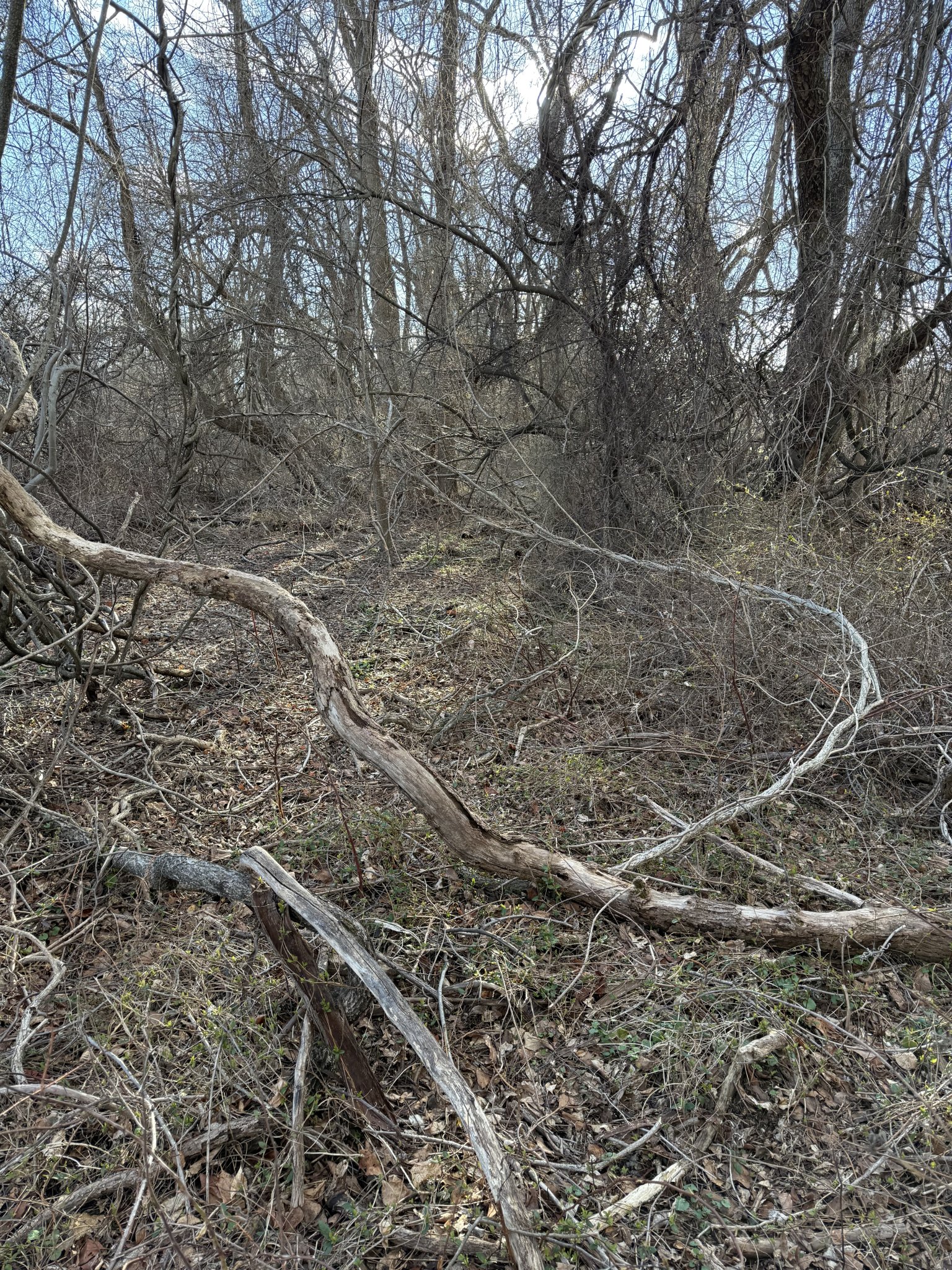

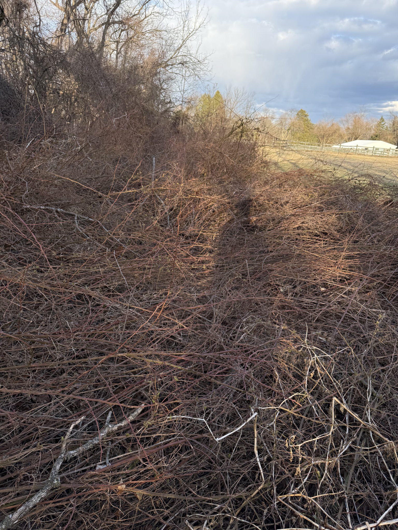

There are also patches of low lying brush and pricker bushes. My neighbor has a brushhog he said I could borrow. Would that cut through this kind of vegetation?
