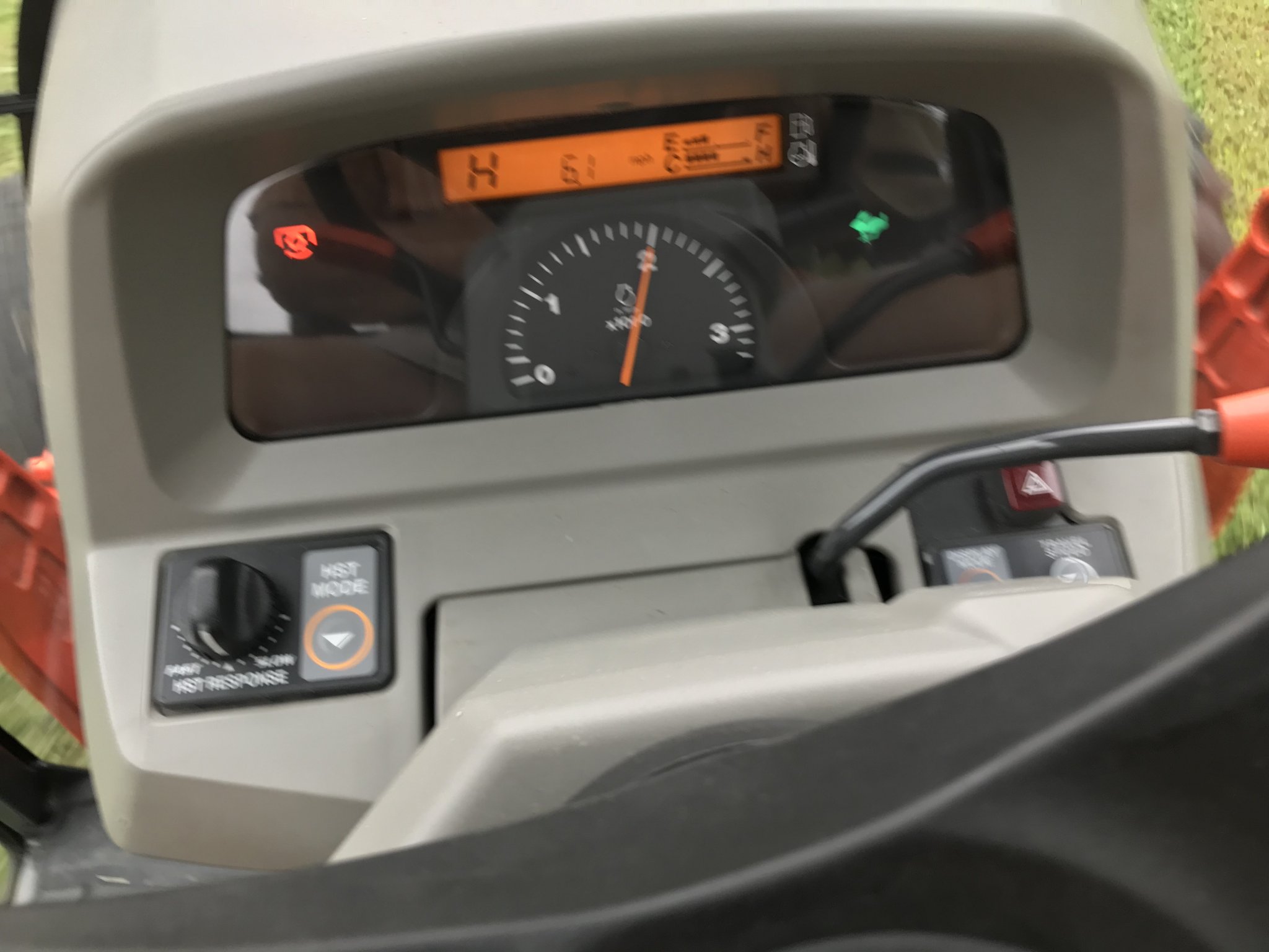

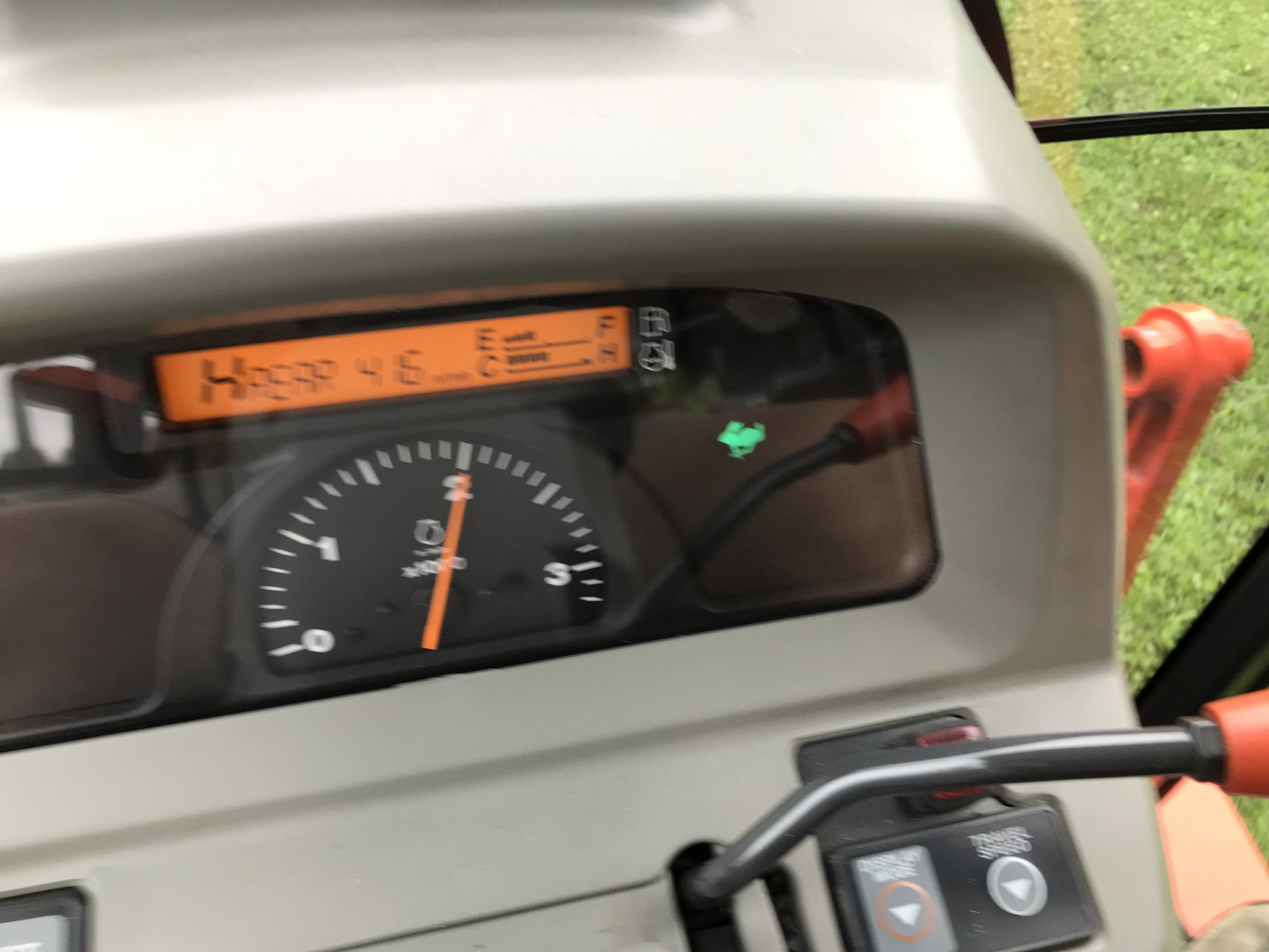

Mowed late this afternoon. Grass was quite tall and thick. Engine RPM's were around 2000, PTO was running 416 and speed was 6 MPH for most of the time. I did drop back to HI Turtle on a couple hills. Shaky pics below.
