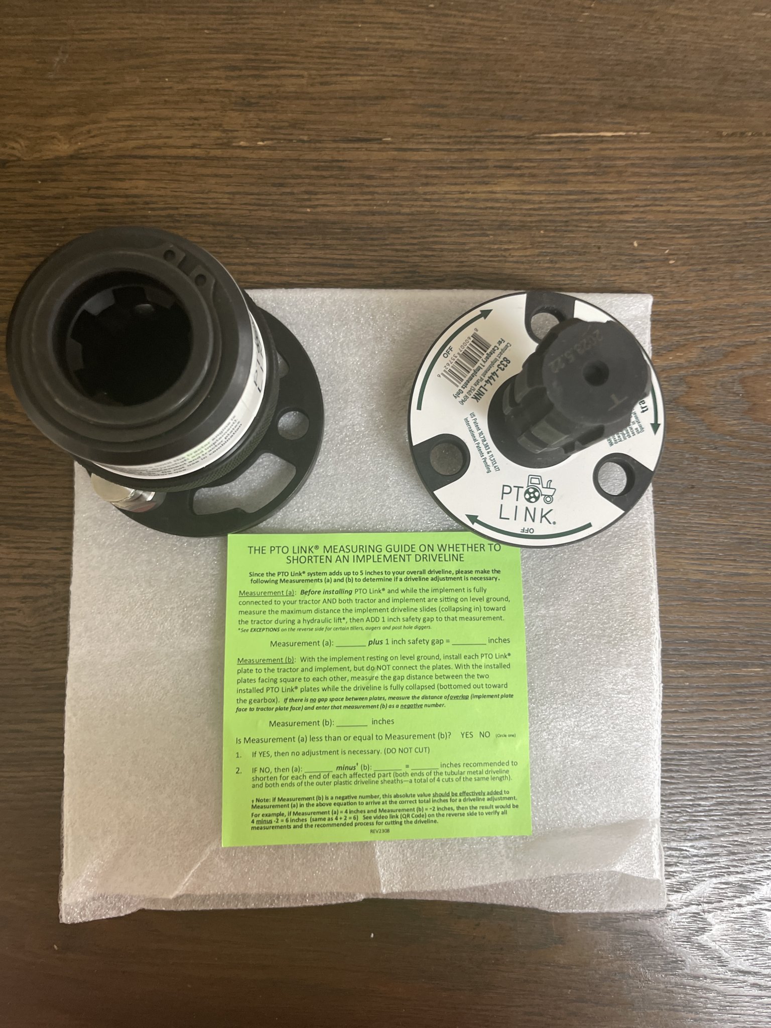

Hmm..curious....it extends 5 inches so..... you'll have to cut the PTO shaft down 5" ???????
You can go that route if you disregard the mathematical formula in the instructions on whether or not you need to trim down the length of your implement driveshaft.

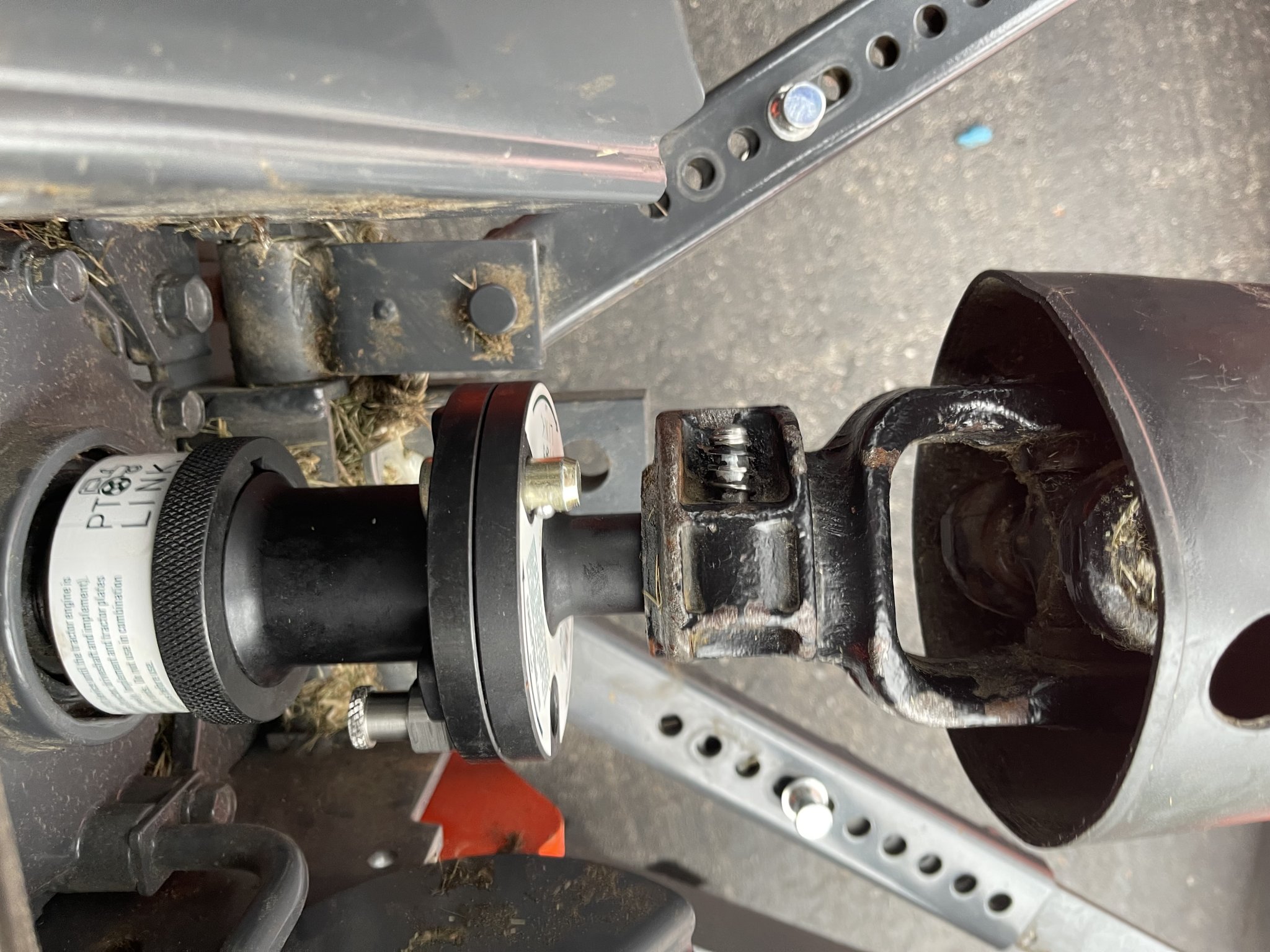

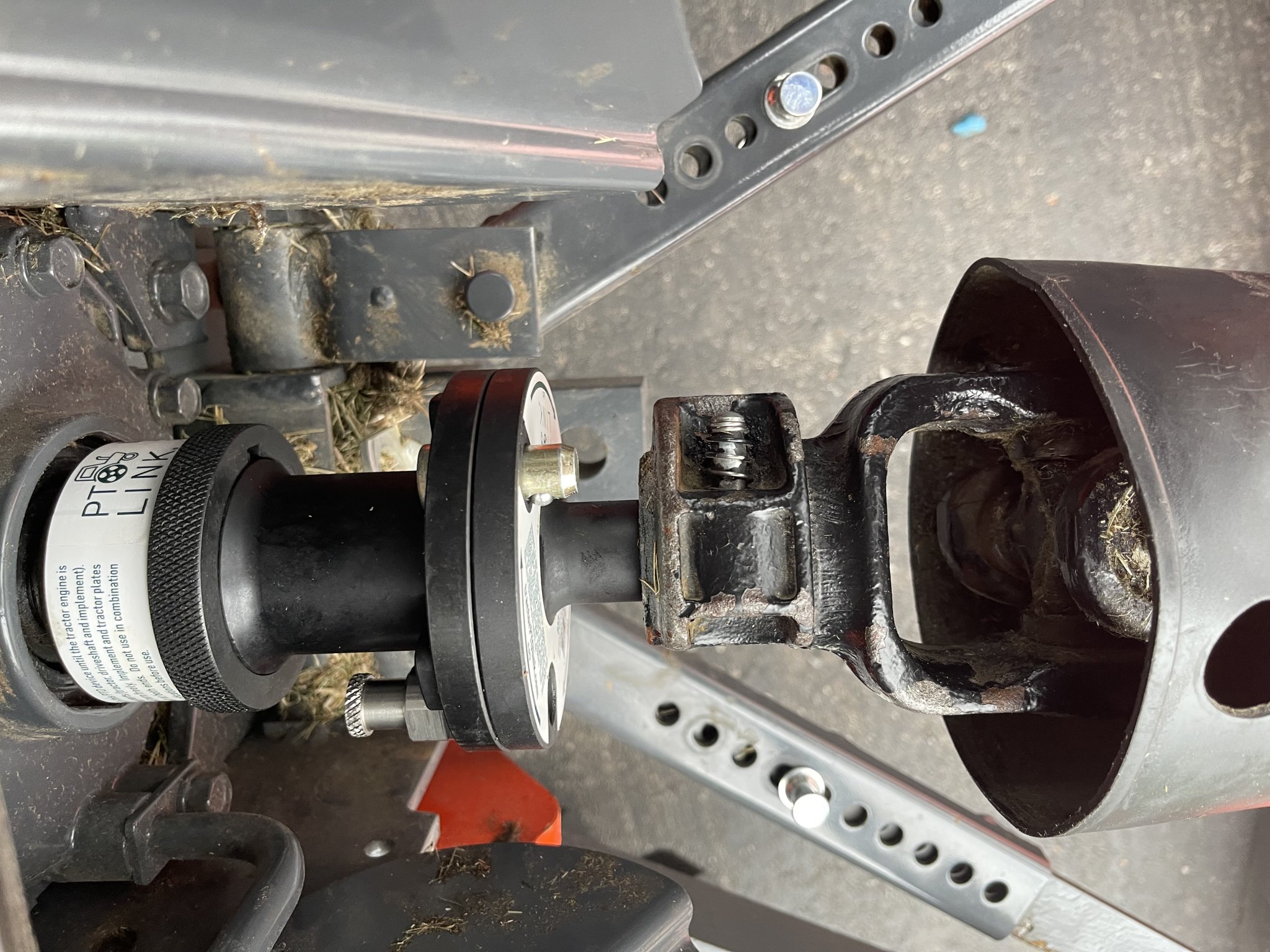

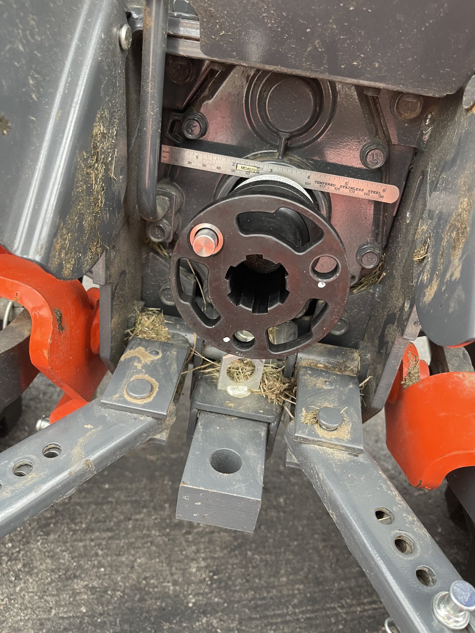

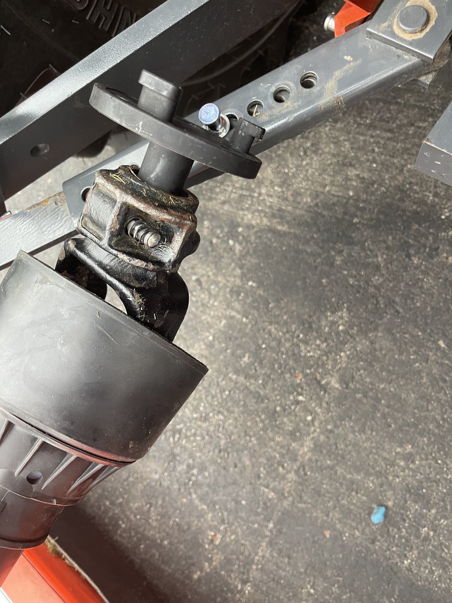

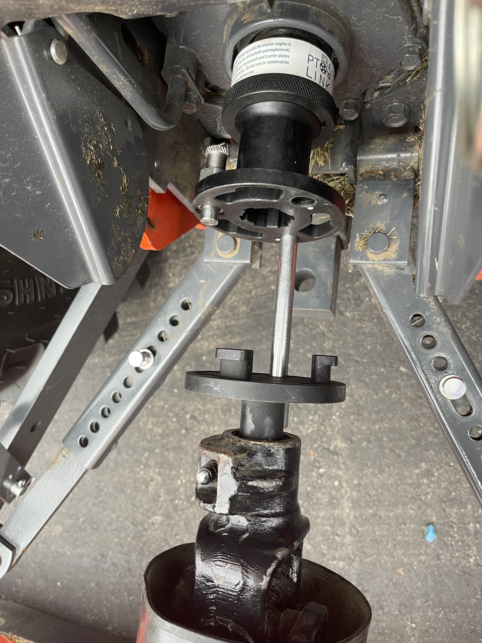

I ended up getting the compact version rated up to 70 hp. Once the weather clears up I’ll post my instal on a LX2610. My (a) measurement is 3 3/4 total.

The (b) measured at 4 1/8 which makes (a) 3 3/4 less than (b) so no cutting needed. I took my time and measured a few times. I used a 6” long 3/8 drive extension to help as a third hand. There’s plenty of warnings to remind you to measure the driveshaft. There’s a separate measurement for tillers.https://share.icloud.com/photos/0a5WmFiYngFiBuTmDFJHKdMrQ

You have any initial impressions of it? Significantly easier hookup? Worth the cost for those who struggle with standard system? An expensive gimmick to be avoided?

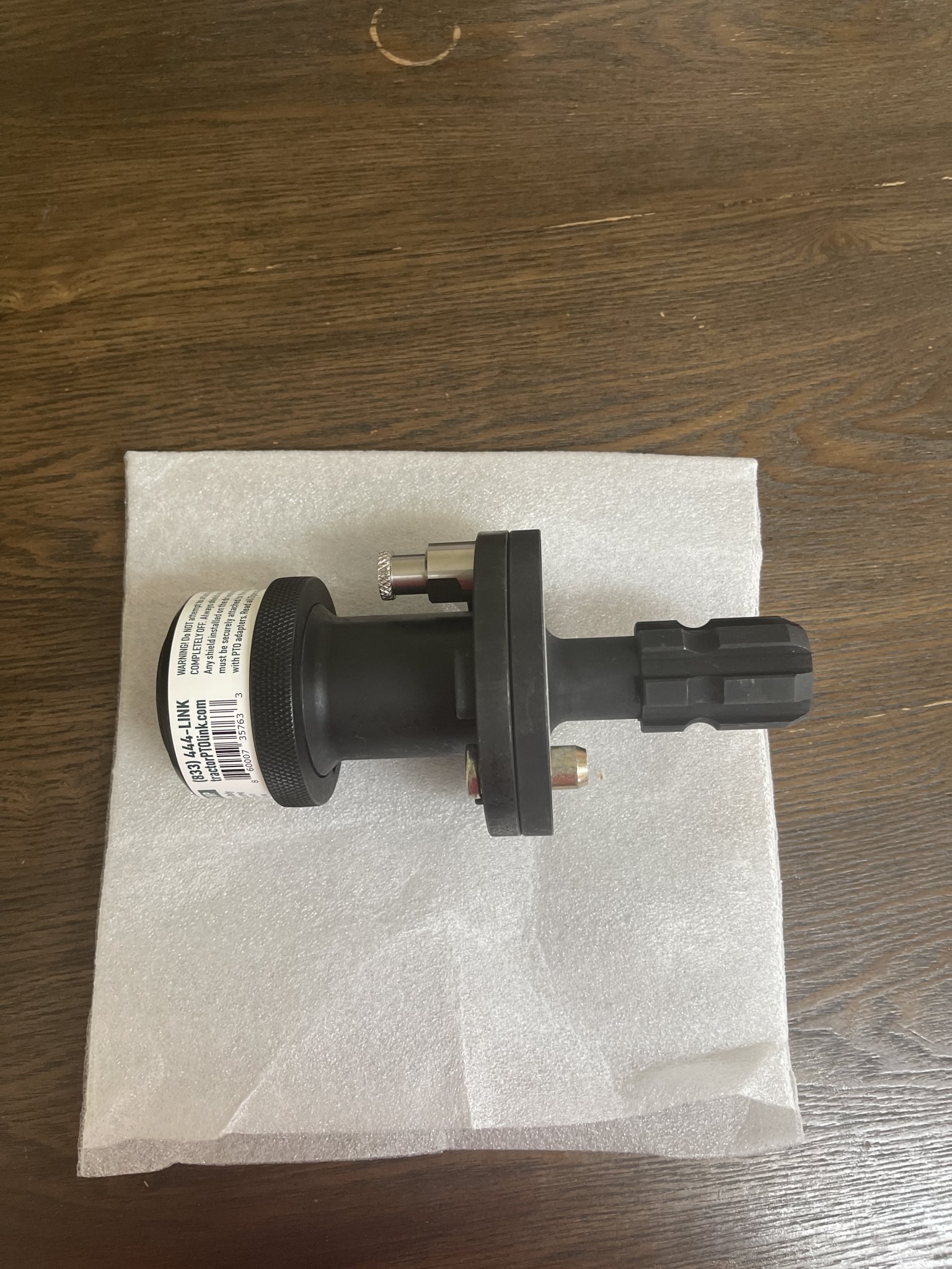

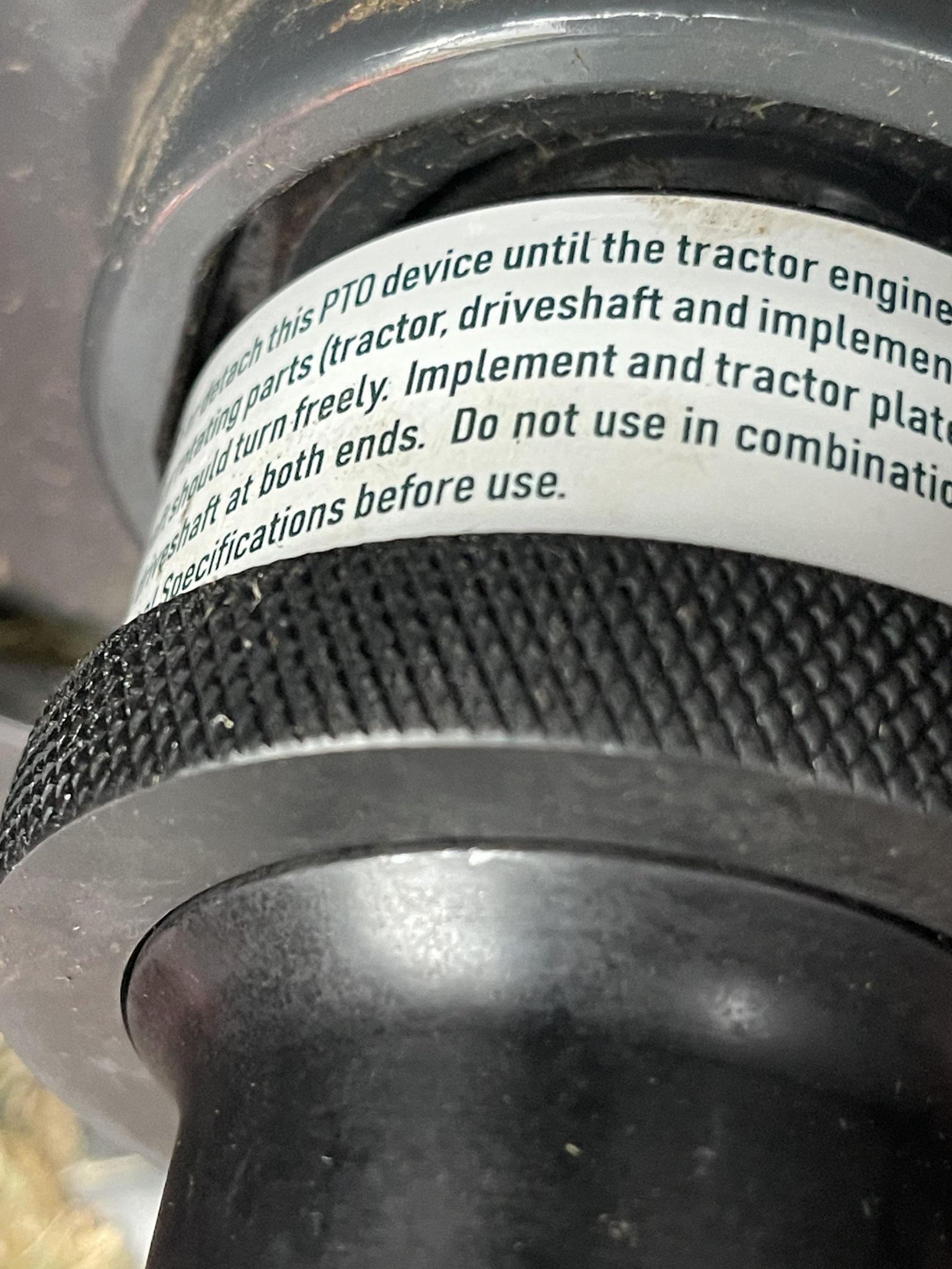

curious as to the warning..'Do not use in combinati...........'
with WHAT !!??
can see it being pricey as you need an end for EACH PTO shafted implement ( X 5 for me.....)

They don't want it used in conjunction with adapters to other spline types etc.
They sell packages which include up to 4 of the implement side with only 1 of the tractor side. I can see using the implement side part for several implements anyway. It is a lot easier to connect the spline on the implement when you don't have a tractor back end in the way.
It's not super cheap but it looks well made with good material so ...

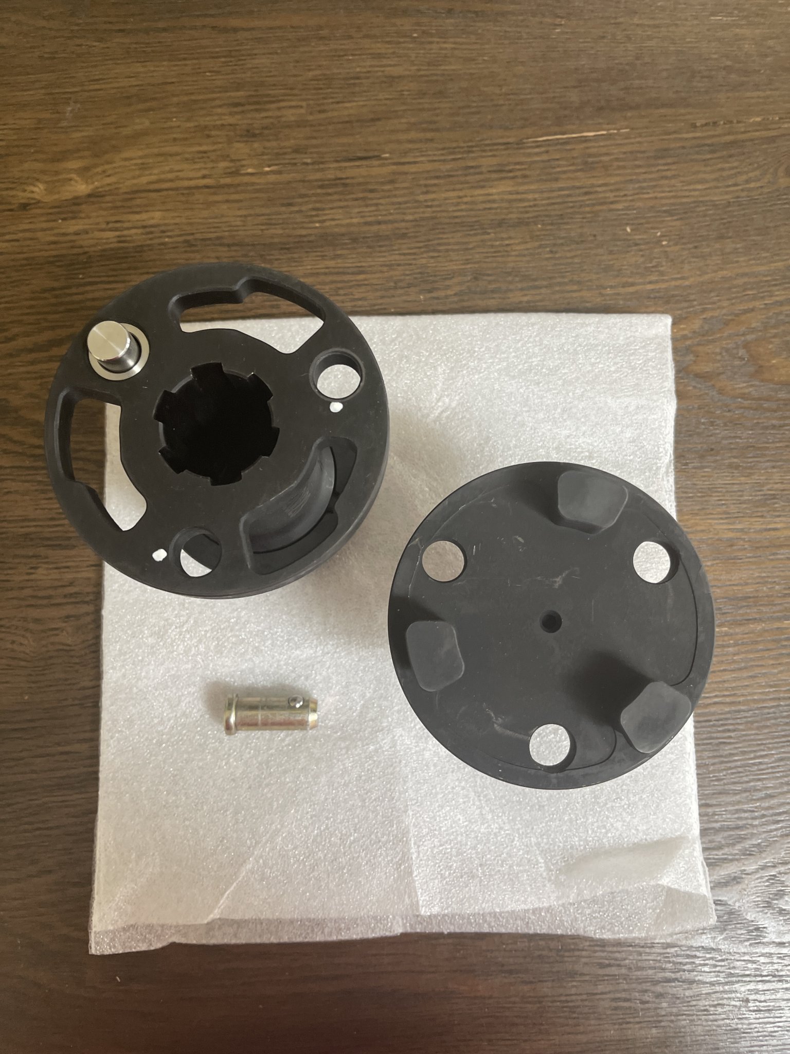

So far I don’t have any complaints about the setup. It’s easier to install than the standard setup on my LX. You have more to grab onto with one hand which made lining up with the three lugs easy. I have lower back pain and this new setup is worth it for me. The only thing I would change is the spring loaded lock pin. I would add in a 90 degree lockout to simplify the removal process even further but the lawyers would punch holes into that feature. One man’s gimmick is another man’s piece of gold.

Spline adapters. You can buy five or you can remove the one and use it on the next implement.

That setup reminds me of the tail rotor driveshaft disconnect on a S-61/H-3 helicopter.
Sikorsky is only about 30 miles from here. Maybe I should see what they are throwing out?

In one video, the guy still 'struggled' to connect to that fancy adapter.
