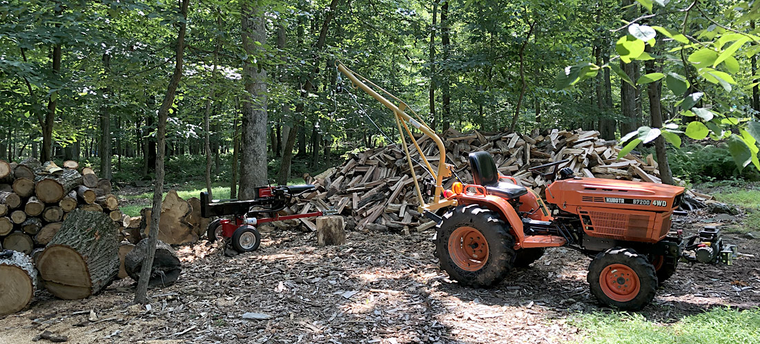

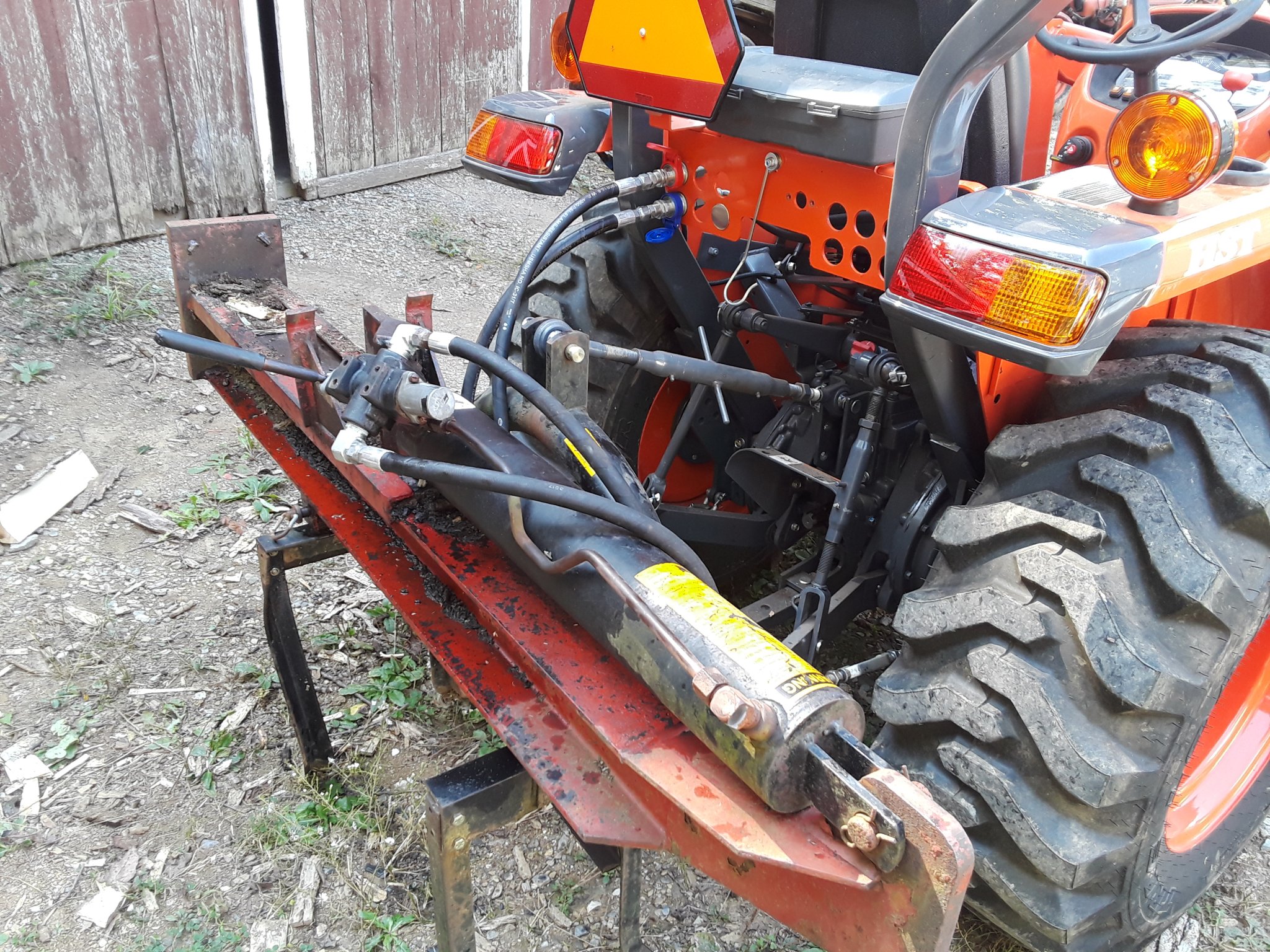

Dont believe everything you are told. Your 3pt splitter will work and its dirt cheap to hook up. Here is my 3pt log splitter on a L3901. It has been upgraded with a regenerative splitter valve and cycle time is 15 seconds with extend speed almost twice retract. That will keep one man busy.

He can run the 3pt splitter he already has directly off the L3902 hydraulics - all he needs is a 24" hydraulic hose and a $25 quick coupler. Takes less than 30 minutes to install. Why spend $500+ and days fabricating a PTO pump and reservoir?
I completely agree with Dan on this. I have a “Split Fire“ 3 point splitter with log lifter. It runs very well from the hydraulics of my L3301. If you already have access to the 3 point log splitter, I would think that you would spend the minimal time and expense to utilize the hydraulics of your new L3902.
