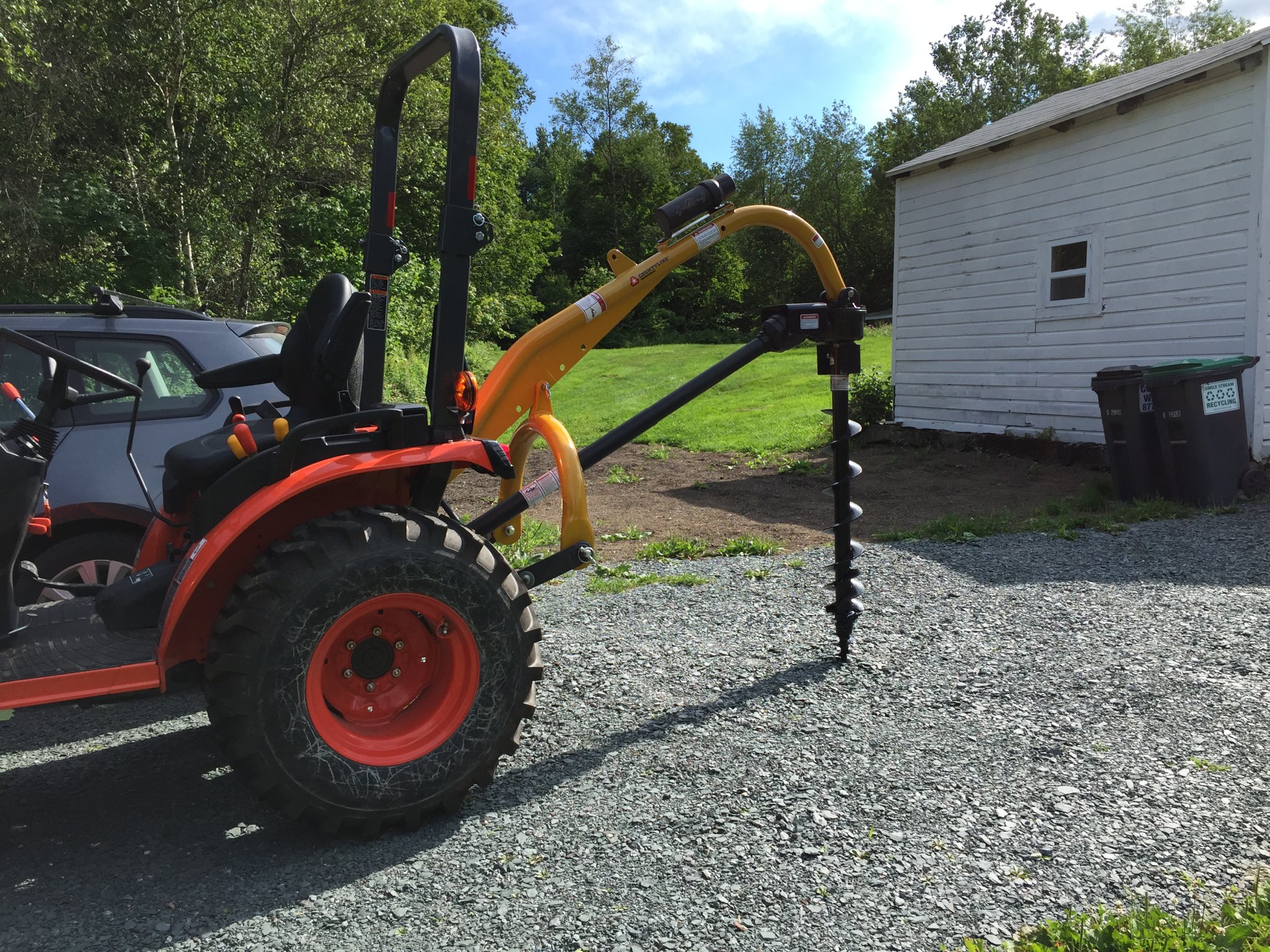

I had a “County Line” (Tractor Supply brand) on my B2301. Just fit; if my memory serves lifted up there was a few inches of ground clearance. My soil is so rocky that I found it pretty much useless and sold it. I thought the TSC one seemed pretty well made, at least at that time. If I had different soil I’d buy it again.

Thanks guys. I've had five kubotas over the years and I will be using it plenty. Just wanted to know if it would fit. I appreciate the answers.
Thanks for the picture. Exactly what I needed to know

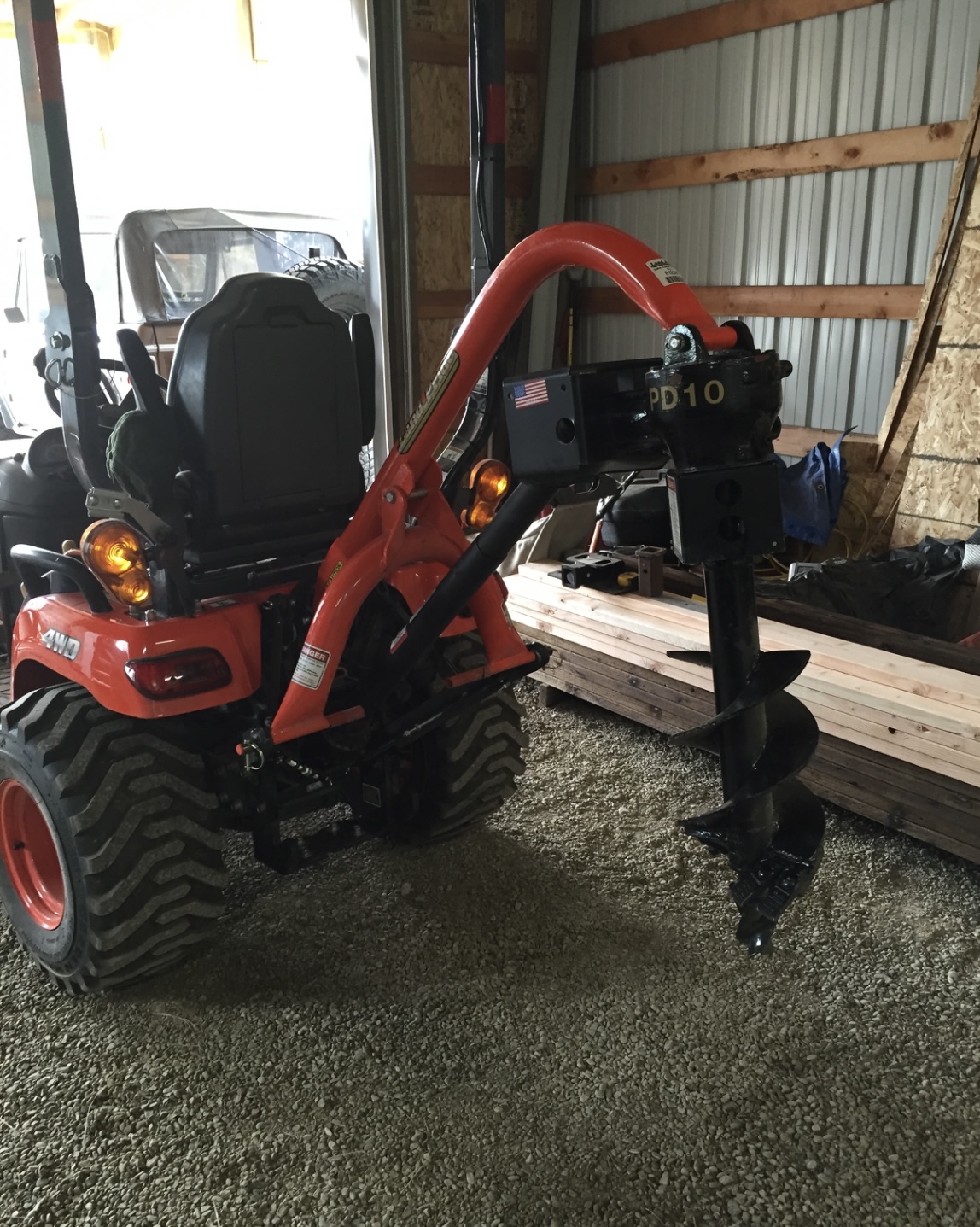

Never had an issue with my PHD on my B2910. Easy for me. What is the issue?
I store mine hanging from a chain. Perhaps that is the difference?
Curious…
edit: I have 14" & 9" augers for mine. Glad I have both.

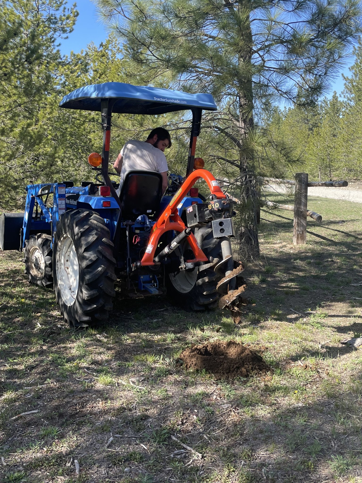

It fits other tractors too. My neighbor poking holes for trees, with his tractor

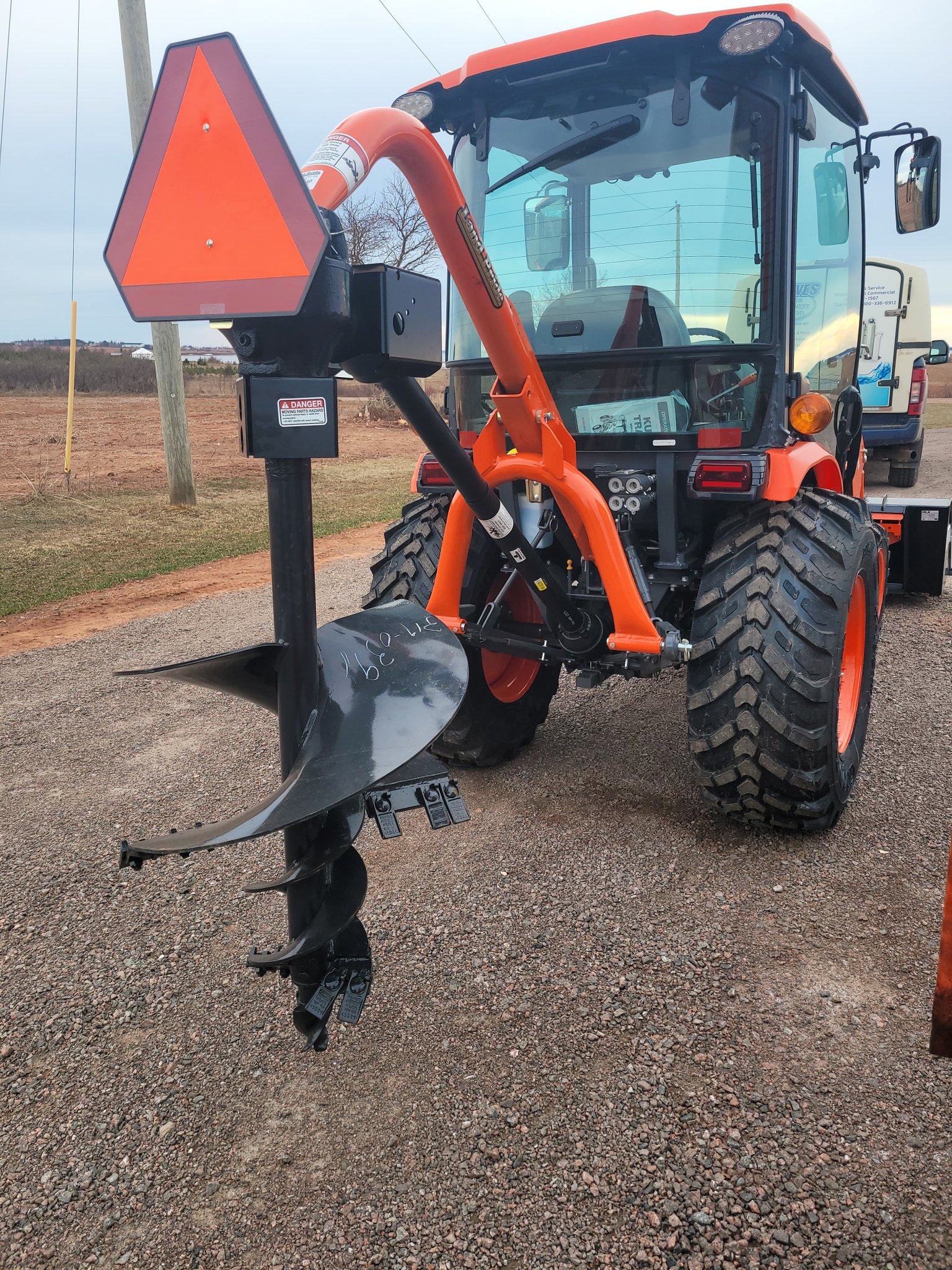

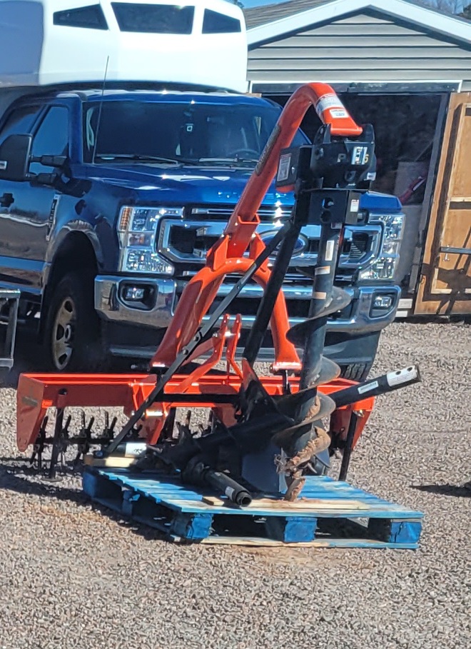

I have a PD25 with 9" & 24" augers. I picked up the Landpride stand and fastened it to a pallet for easier hook up and storage.
