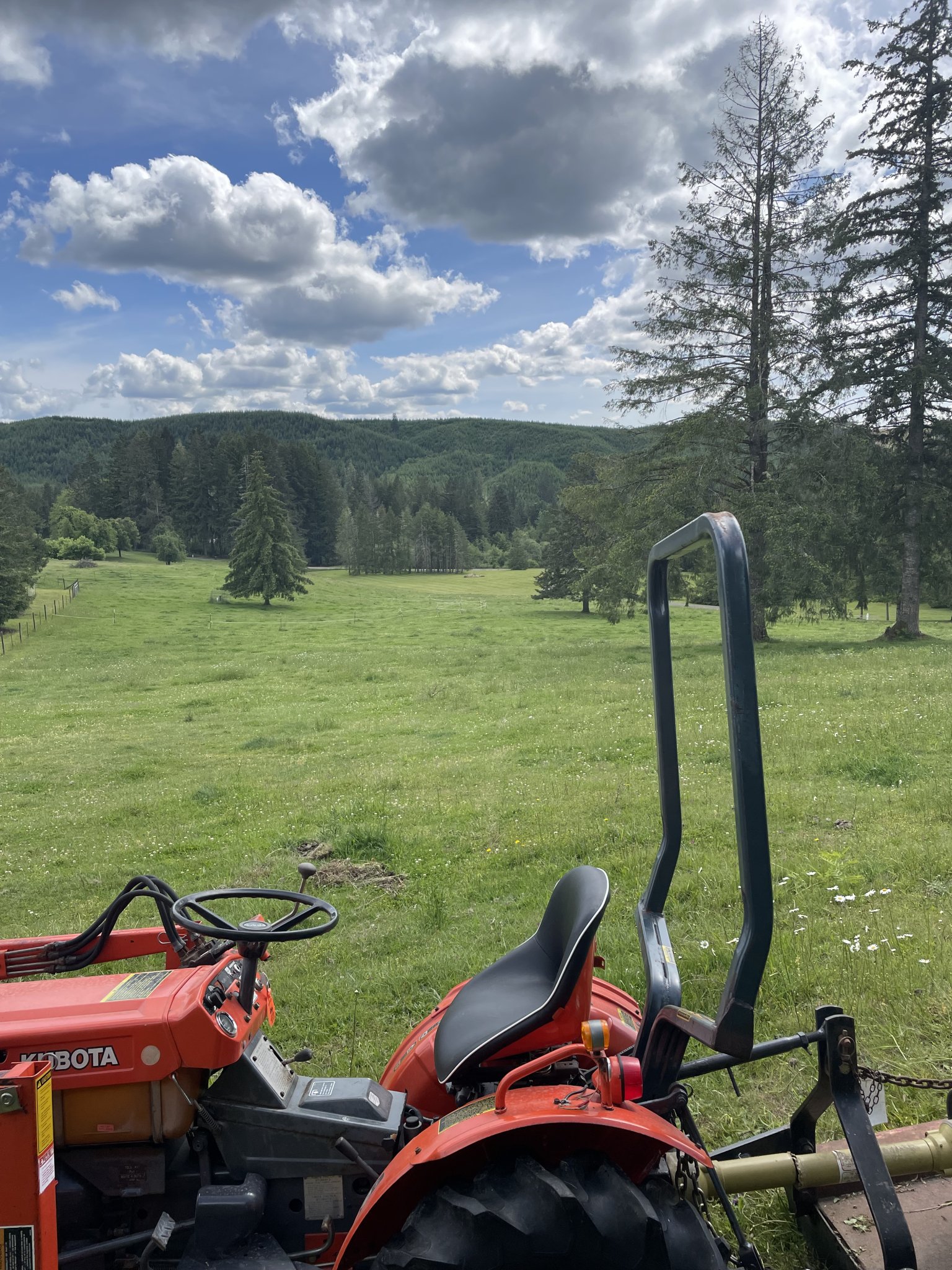

I need advice on who makes a post hole digger with an under 3 inch top bar. My roll over bar bottom is only slightly over 2.5 inches wide. I have called a variety of manufacturers and nobody had any good ideas.

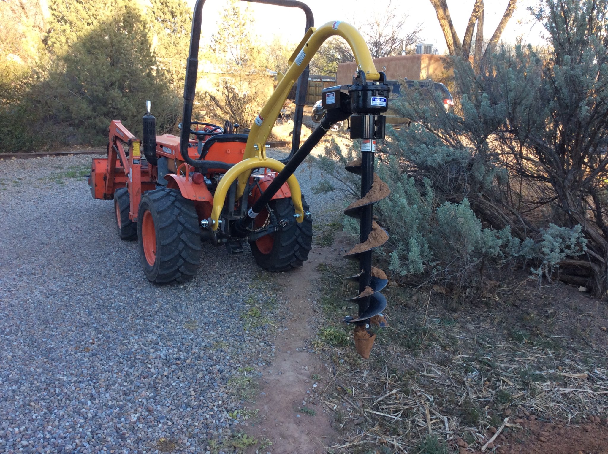

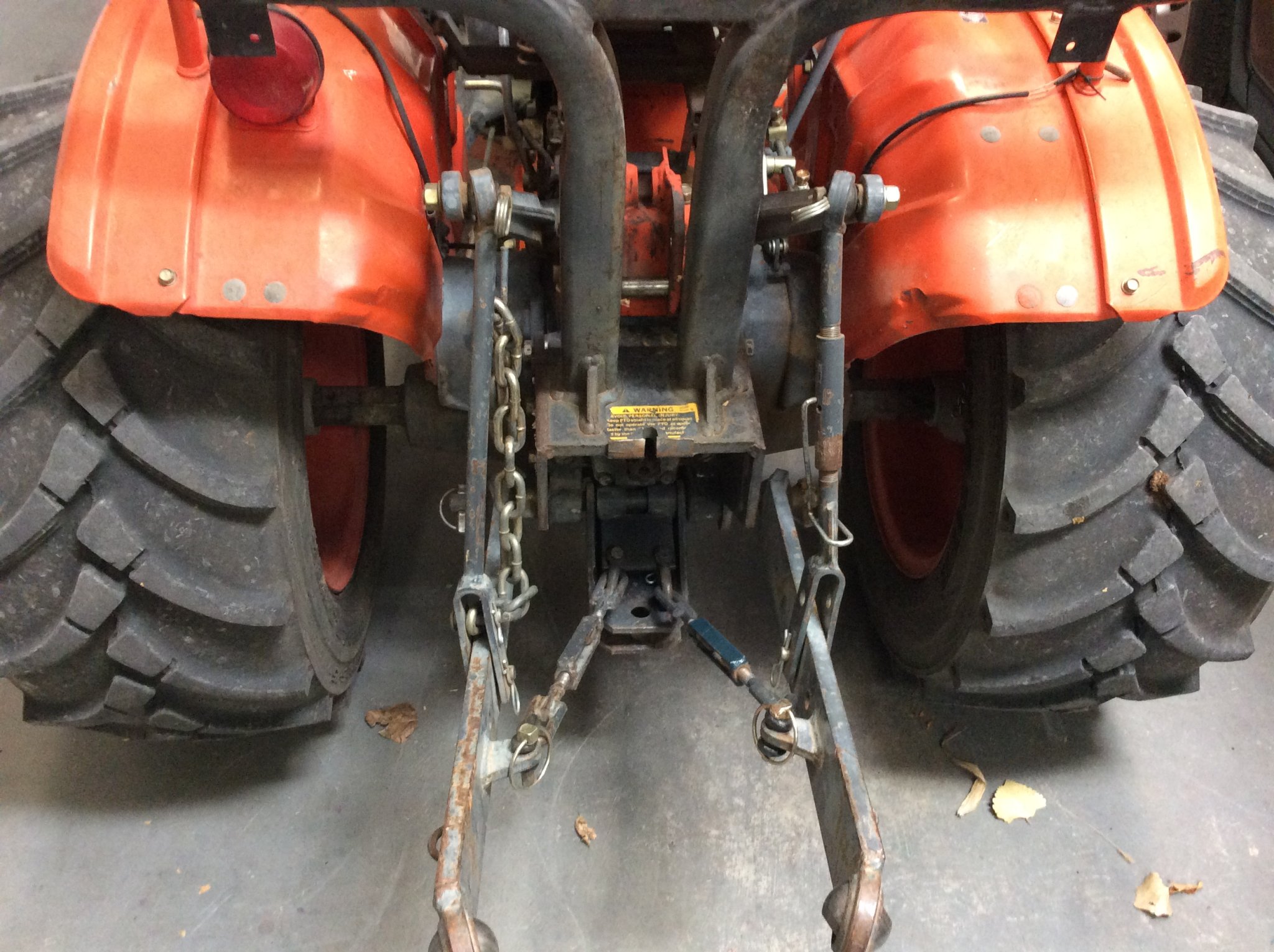

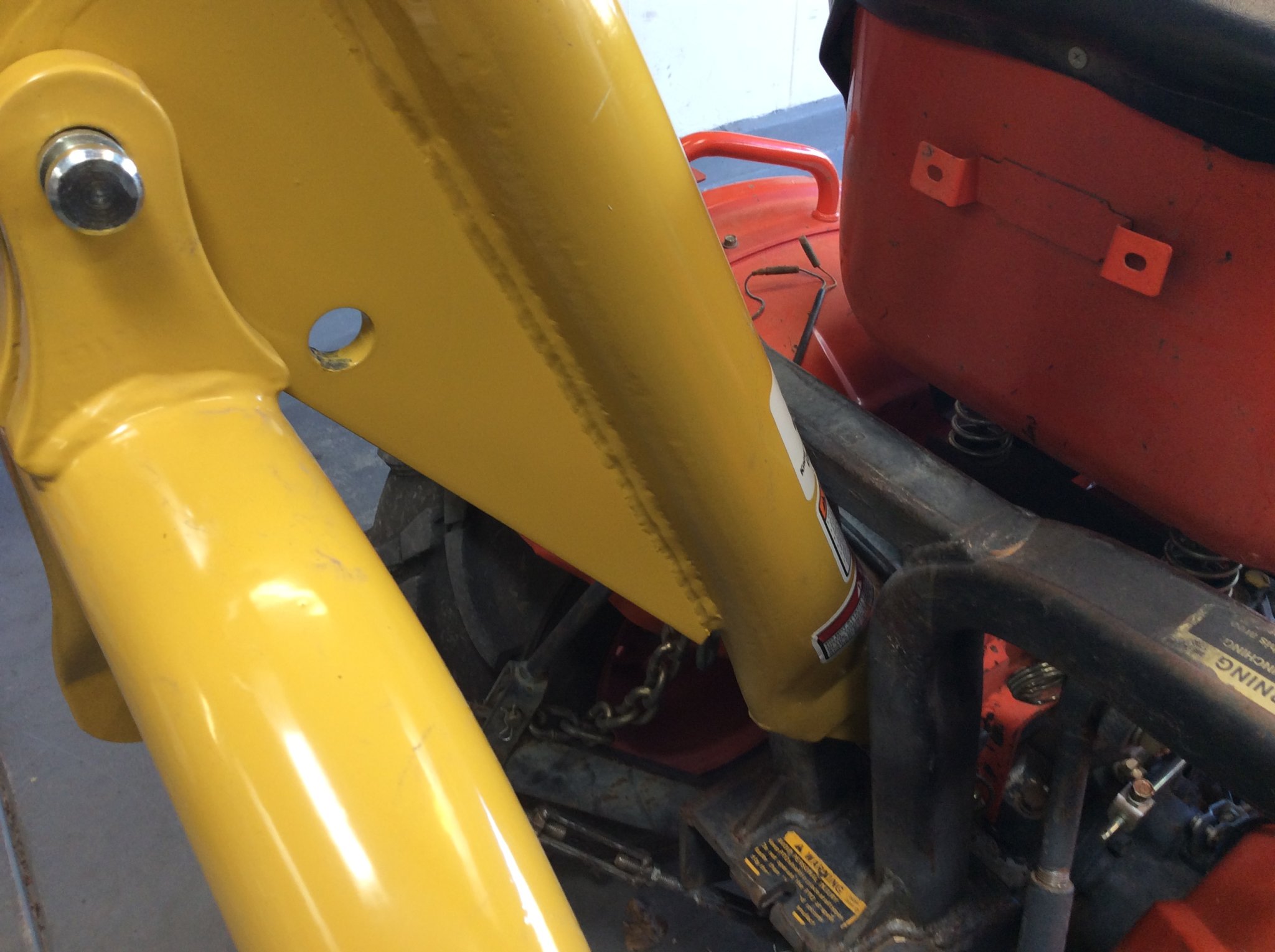

Hi ngp, welcome.
As NIW says, the end of the arm is tapered to fit. Here are a few photos. Does that answer your question? IMG_0316.jpeg IMG_0321.jpeg IMG_0332.jpeg

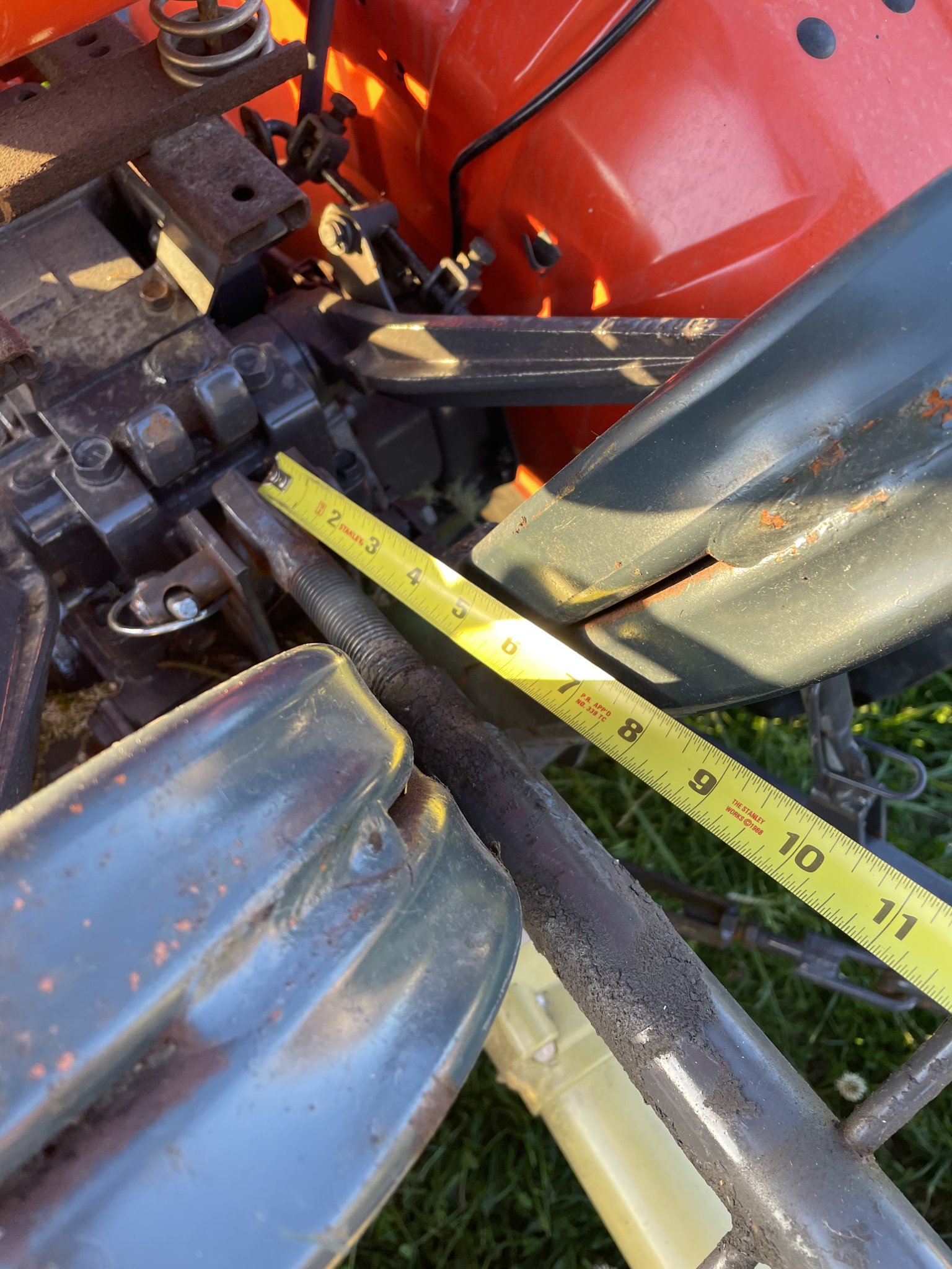

Thanks for the reply. Let me show you what I’m working with. County line digger from tractor supply is tapered about 7 inches and doesn’t quite make it

Maybe its just me but that PHD looks like it is too big for that tractor?
It is a bit long. I have no problem digging and can dig at idle.
Lifting power is what limits me, so I lift every foot or so.
