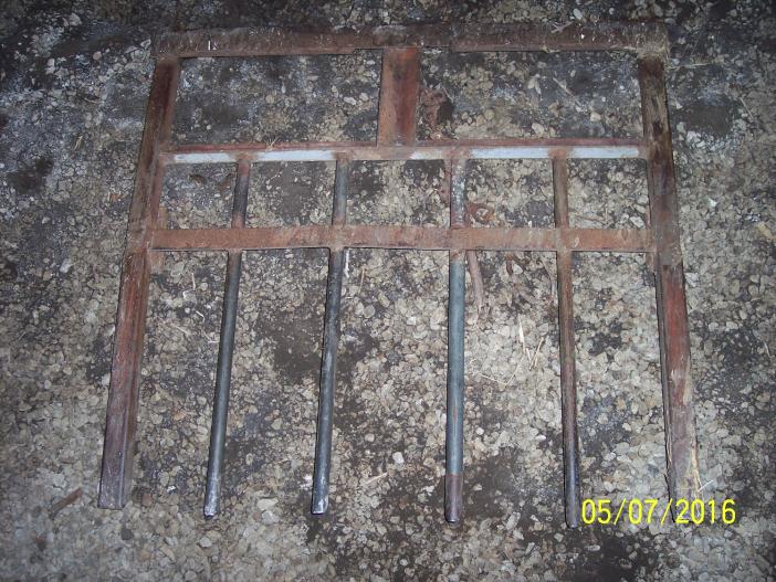

I made mine from some angle and flat bar. I have really abused it surprised how well it holds up. You mentioned you didn't have a way to build yourself but maybe find a local fab shop? Something like this wouldn't take very long.

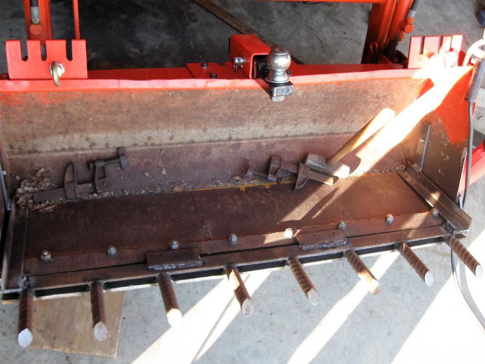

Rick, here's some pictures of a similar tool I made 30 years ago for a B8200. I had a 2" ball mounted on the top of the loader bucket and I hooked the load binder over the ball to hold it in place. I welded a big "O" on the hook of the binder to slip over the ball.
I used scrap iron and 1" barbell iron for the bars.

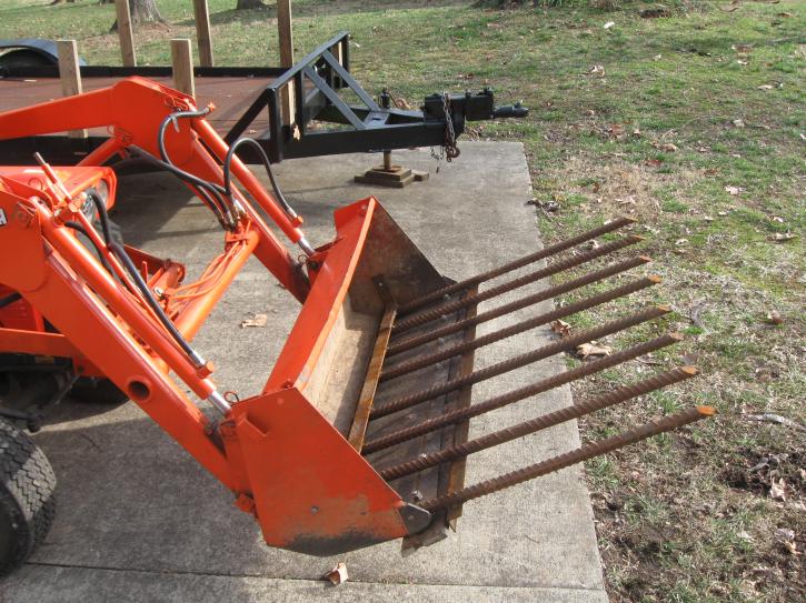

I made mine out of angle iron and some 1" and 1/4 rebar. All were brought at the local scrap yard for 22 cents a pound. Total I have less than $20.00 in the forks and had enough left over to make a tooth bar. Tractor 022.jpg
