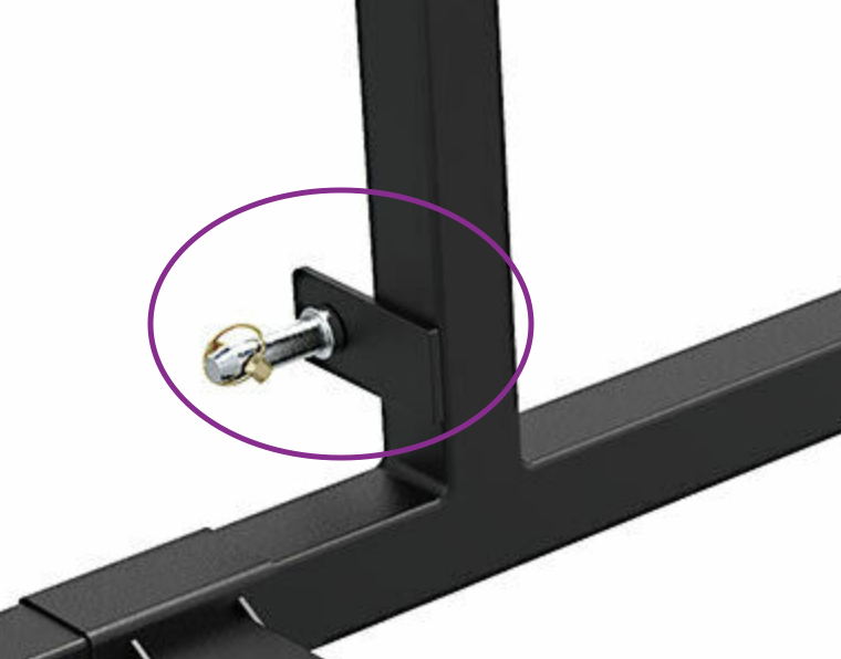

Speaking of compromises, the rear forks I got are something like these. I bent them where the pin for the 3-pt attaches, but may have been picking up something too heavy before doing the wood and not noticed the bend until the end of the day. My neighbor/new best friend helped me weld a gusset to brace this part and I think we're good to go. I really expected the bottom to twist from looking at the picture, but that seems to have held up ok (for the few hours I used it). They do not adjust in as far as I might like, but seem to work for regular pallets and the wide side of a tote (just barely). They do not fold for storage, but there's usually a pallet or tote around I can store them under. View attachment 87047
